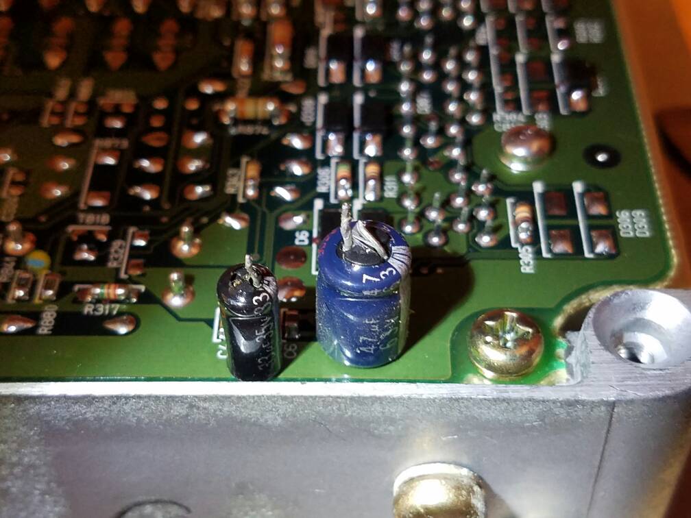

What are the consequences of using a basic lead free silver solder?
Edit: can I use a really high quality caps, like the ones that looks like they are cover in a metal sheath?
Sent from my SM-G930T using Tapatalk
Lead-free has a higher melting point, so greater chance of damage to the board. Nobody knowledgeable would use it on PCB work. Plus you want rosin-core, not acid core or no core. The one I posted is nice and thin and perfect for the job. Silver solder has an even higher than normal melting point, very bad choice. Save it for jewelry, not electrical boards.
Like I said, caps are caps, just get size and polarity right.
I agree with the Durk.
60/40 leaded rosin core solder, a new cap and an Iron is all that is required. A solder sucker or solder wick doesn't hurt, but shouldn't be a requirement when you are only replacing one cap.

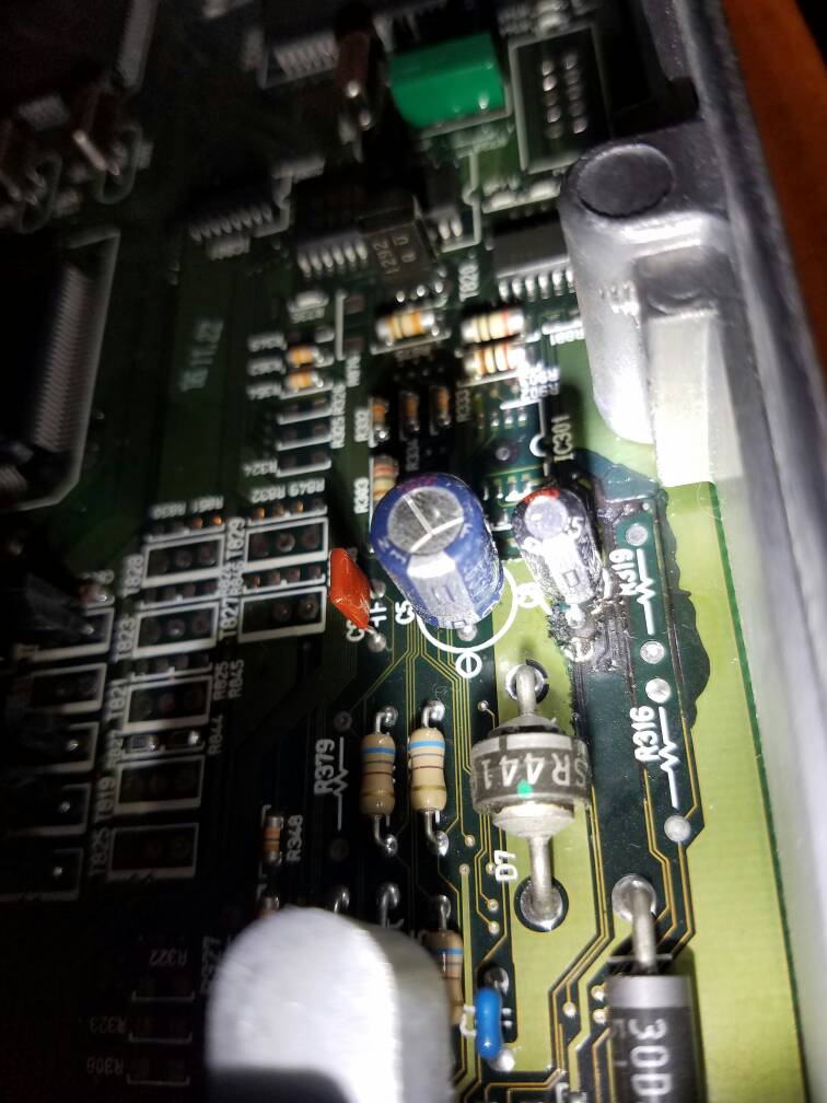

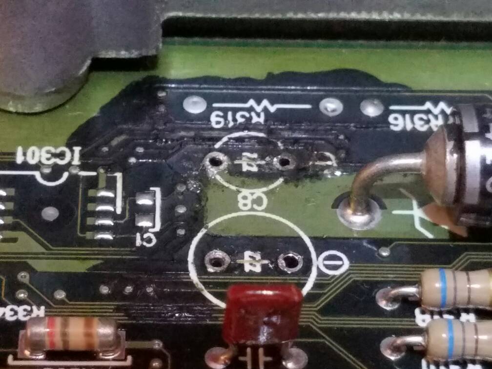

It was suggested to me that I use alcohol and cotton swabs or a tooth brush to clean off the electrolytic fluid. This stuff is dry, crusty and extremely stuck on. I'm scrubbing really hard without much removal. Lastly I tried using a small jewelers flat head screw driver to scrape the material away using as little pressure as possible. Just the weight of tool. Is this a bad idea? What happens if I leave some fluid behind?
Before cleaning
During cleaning
I would try a stronger solvent, just test it on the edge of the board first so there is no bad reaction. Lacquer thinner or paint thinner would prob be more effective. I have a spare ecm for a 97 if you want but it won't be plug and play
Well after I scraped some of the capacitor crap off, I noticed what looks to me like teeny tiny gaps in the copper traces. I put a multimeter on the pins they go to and some have very low almost "0" resistance and some have super high resistance. I don't know if my scraping damaged them or if the electrolytic fluid ate the copper. I bought extra capacitors, I'm thinking of just putting them on the board and seeing what happens. I suppose I could bypass a couple of the bad traces. Most people would probably just go get a used ECM bit I'm having fun with my little circuit board project. Does anyone know where I could get technical information on the PCB itself to see what these specific traces are for? Also any info on solder insulated copper wire to pcb traces would be greatly appreciated.

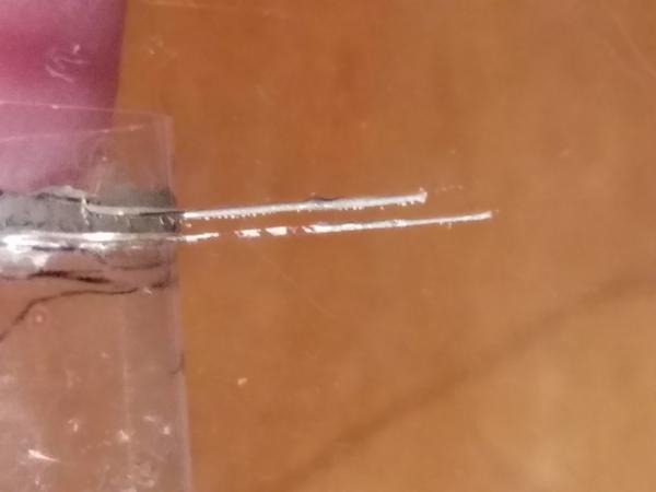

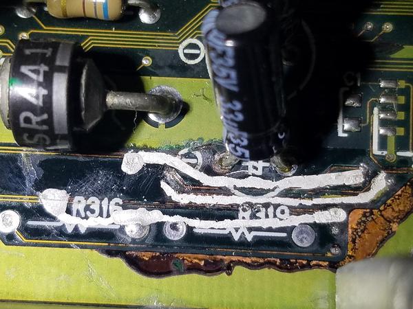

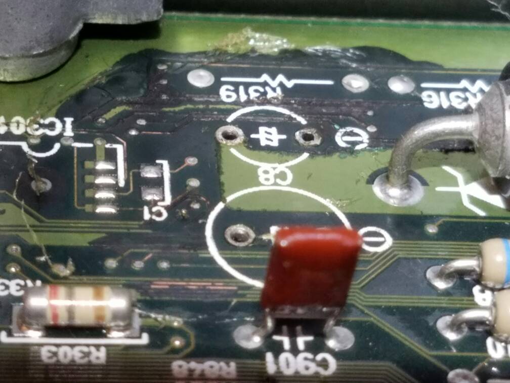

My original plan with this stuff was to put down a layer of scotch tape and cut away the tape over each of the damaged traces trying to cut the same width of the traces. Then apply the silver over a large area and let half way dry. Then pull the tape away like a stencil. The advantage to this method is I would have been left with super thin traces that almost perfectly matched the originals. However the traces proved to be to close together and I could not accurately cut over one trace with out affected its neighbor.
Here is where I tested on some plastic. Those lines are thinner than mechanical pencil lead.

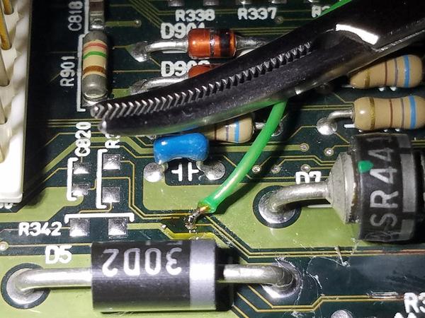

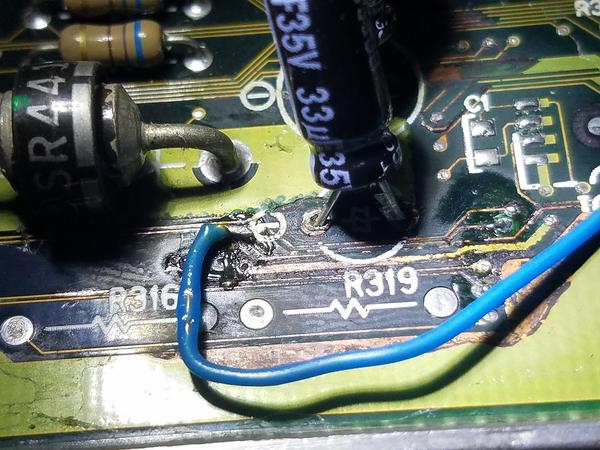

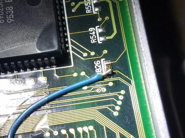

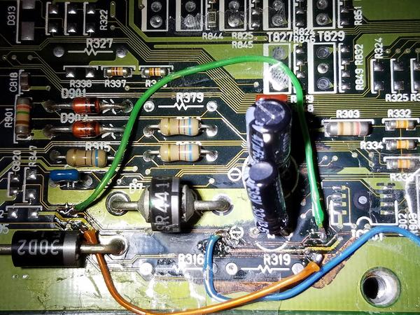

My next try was to forget about make tiny traces and just connect the important parts. I put a new layer of tape down and only cut open small holes over the beginning and end of the affected traces and "formed" a line of silver on top of the tape. I thought that was brilliantly simple. Still didnt work.
I posted on several Circuit Board enthusiast type forums and found one that was willing to give me some advice without too much BS. Originally before all of this I wanted to bypass the trace or repair them with small copper pieces. What discouraged me from that route was my poor excuse for soldering skills. My biggest problem was that I could even get started properly like getting solder to stick to the iron. The circuit forum guys gave me some tips that worked out fantastic. I was soldering within minutes after reading their replies. I was really feeling good at this point. :boxing:
One item I did not have was some copper wire. They suggested taking a wire made up of lots of smaller gauge wire and pulling one of the strands out and using that to do repairs. This is really only useful for laying directly over the traces. I already learned how close together the traces are and that I would not be able to do that with just me and magnifying glass. I chose instead to bypass the traces completely from point to point on the board. I remembered I have an entire roll of Cat6 cable in the closet, (how could I forget?). I think twisted pairs are roughly 26AWG. I was able to use this wire to solder directly to point that were the same diameter as the wire or smaller. The different colors from the insulation are nice touch as well. Here are some pics:
I know they are rough. Its the best a novice like me can do at this stage. Im really proud of those joints. some of them may not be shiny, but they are holding quite strong.
I threw in the board this morning after the last soldering and the engine wont even start up now. Its turning over no problem but no ignition. I have order a replacement ECU but I have noe idea when it will arrive #TimeToRant,
