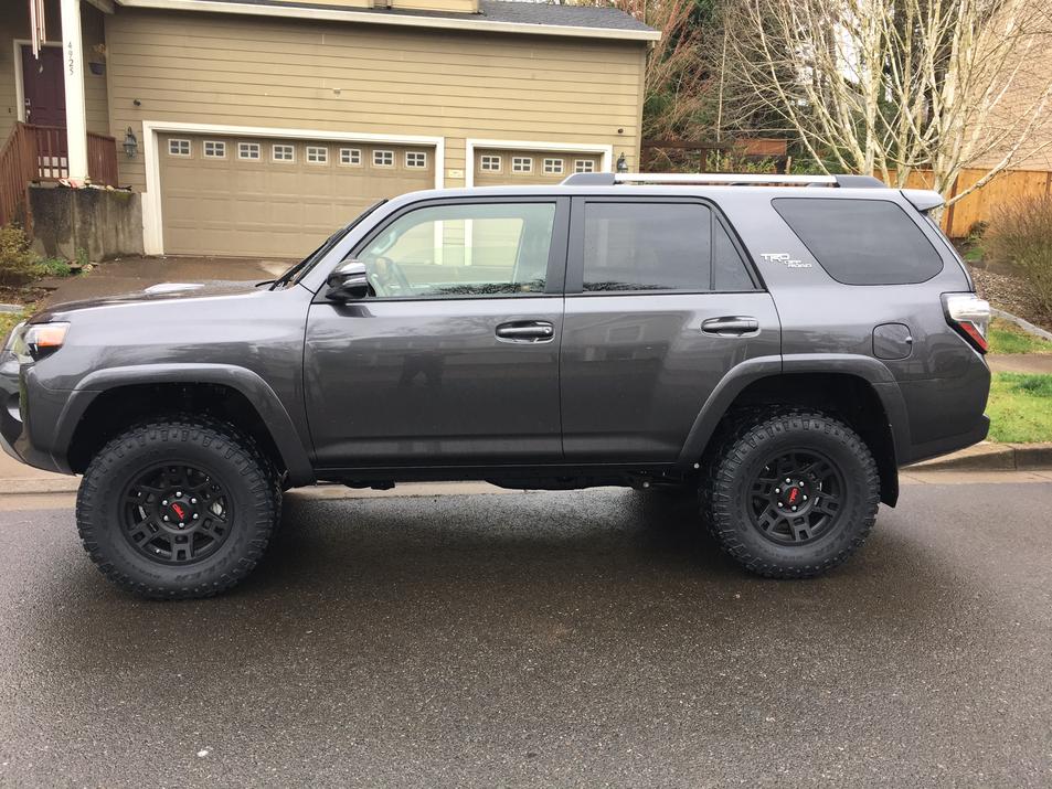

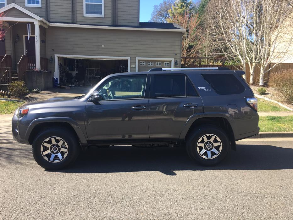

first was Duratracs and TRD wheels. I know its been done 100 times but I have some secret sauce planned this year that I havn't seen anybody do yet. And for now I went ahead and threw a 3"/2" spacer lift until I get my King suspension setup ordered

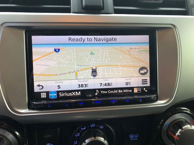

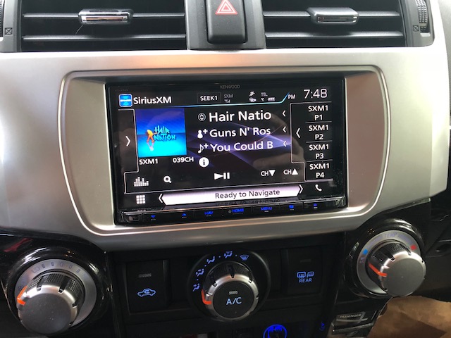

Next, I installed a Kenwood 994s headunit, it is "dashcam ready" and has two inputs for rearview and frontview cameras also.
Using the integrated dashcam I can easily look at videos or just turn on front facing camera at anytime and best of all it plugs directly into headunit and I dont have to fiddle with stupid little buttons directly on a dashcam and remember how to use them. I can just easily watch the videos directly on the headunit and change settings etc...
Oh and once you use a Garmin GPS headunit you will wonder how you got by with the factory one. Factory one has so much lag, is not intuitive.
KENWOOD 994S

I used the Scorche radio install bezel made for the 4runner. unfortunately they only make it in silver so I will go back later and wrap it in carbon fiber vinyl to match the shifter console.

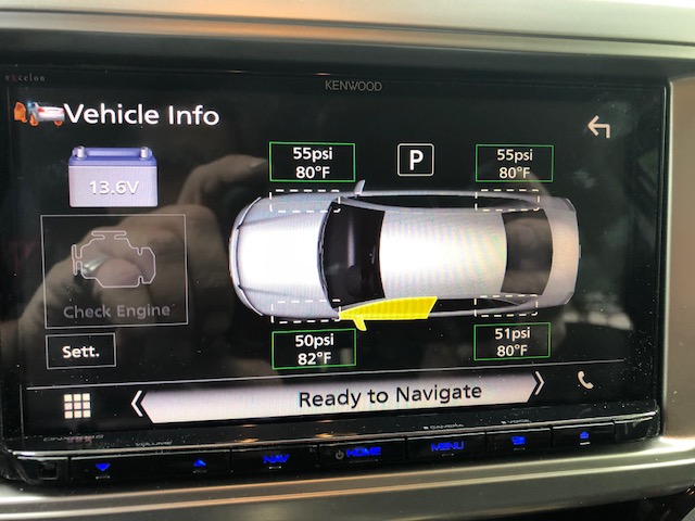

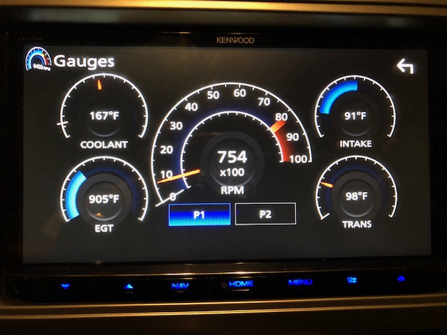

I also wired in a MAESTRO module behind the headunit so all my steering wheel controls work plus you can even program steering wheel buttons to do extra things. Like I programmed my back button on steering wheel if I hold it down for 3 seconds it will pop up on the headunit my Gauges creen. If I hold the next button for 3 seconds it will pop up my tire pressures screen.
It gives you the option to choose from like 20 or 30 types of gause to show on the screen from transmission temps and EGT temps to RPM or even show your 0-60 times or 1/4 mile times.
The other great feature is it lets me program all sorts of vehicle functions on the headunit screen like windows down with key, windows down with remote, doors lock when shifted into drive or into park unlock. Change the door lock beep functions etcc among other things.

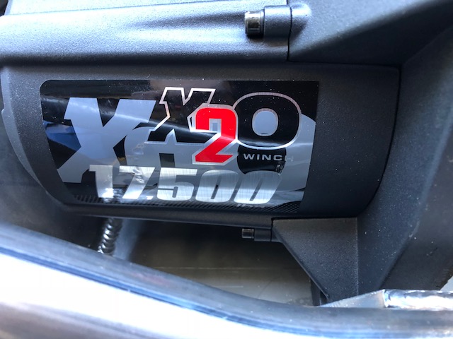

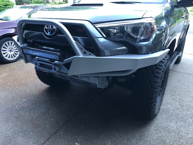

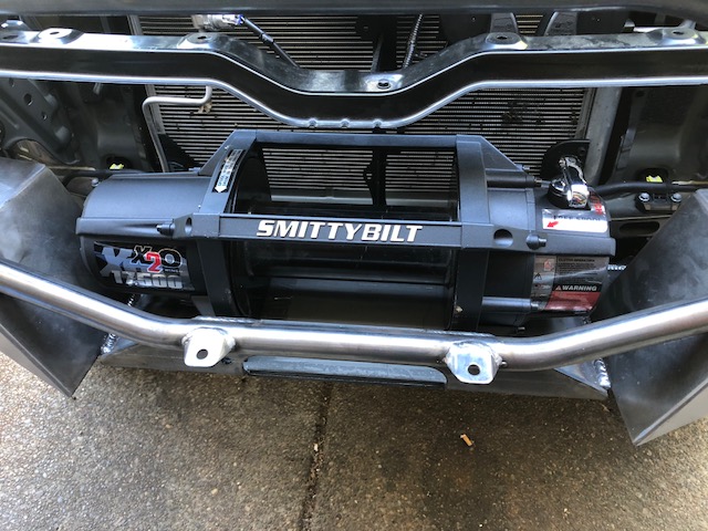

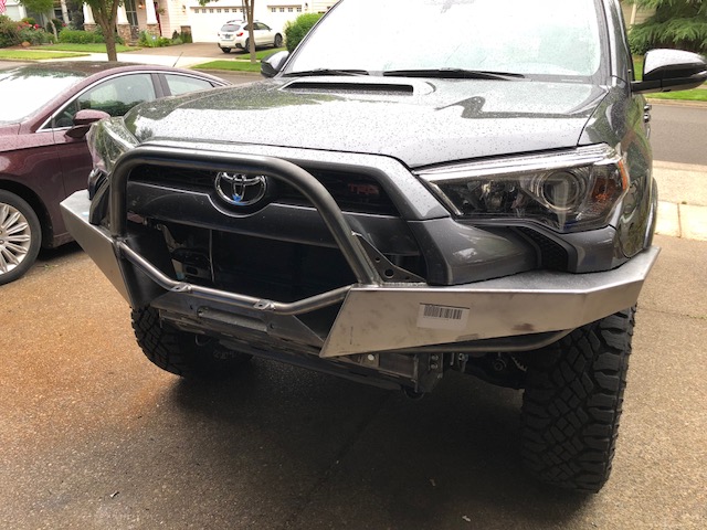

My addicted offroad Bumper arrived finally! Need to test fit it and see if I can make my 17K winch fit.
A couple people have told me it was crazy to install a 17k winch. But the dimensions were just a little bigger and it fits. It just means the winch won't have to work as hard and it cost the same as the 10k winch.

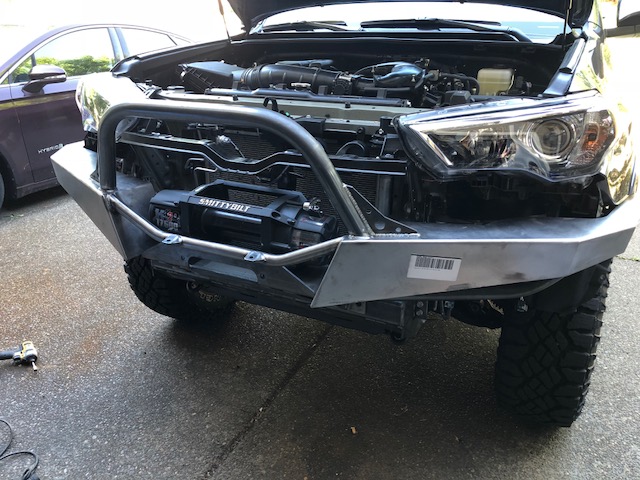

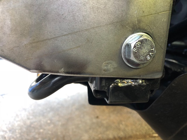

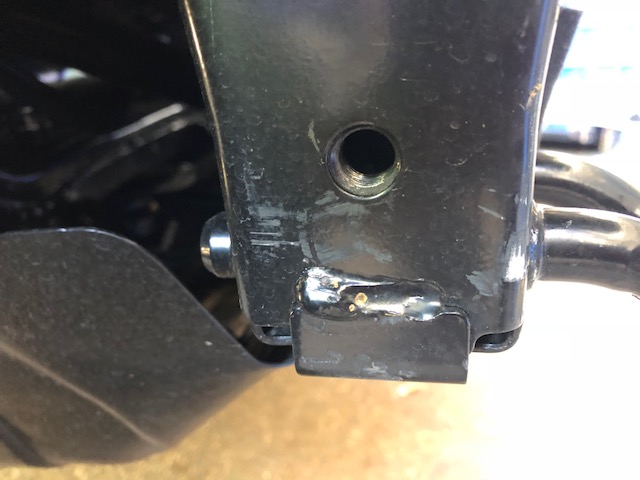

First issue I ran into was the side plates for the crossmember are too tall and dont clear the factory weld. I got the plasma torch and cut a 1/4" sliver off each side.

Then ground my cuts smooth again to look like it was cut that way in the first place.

I also found 3 of the 6 nuts they welded in the crossmember to attach the bumper to the crossmember had weld slag in the threads and could not get a bolt even started in them. Had to go find a 1/2"-13 tap and recut the threads out then it all bolted up ok. Can't seem to get the bumper perfectly level the same on both sides. the various wholes they drilled in manufacturing were not dead on so had to open some of the holes up more.

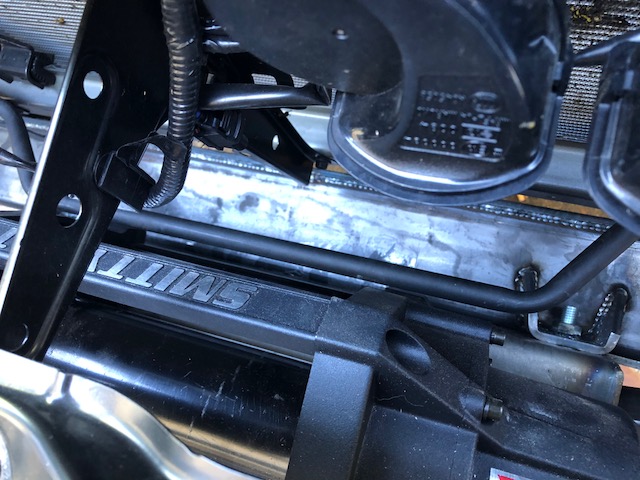

Set my big ass winch in there. Had to drill 4 new holes for the mounting feet. They were the same spec but the size of the winch meant they just needed move back a couple inches.

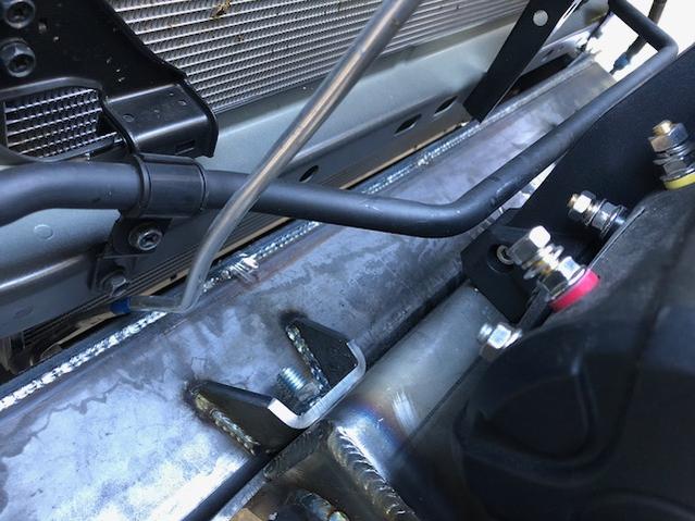

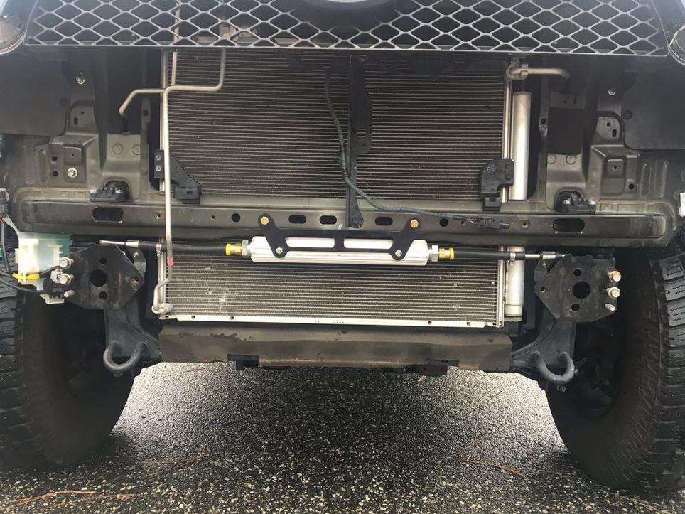

Also looks like the power steering cooler line just barely clears which is good. I'll be installing the 4x4labs power steering line relocate kit anyway though. Also the AC line just took a slight two way tweak to clear the crossmember no biggie.
I ended up installing the 4x4 labs power steering cooler mod kit to make a little more clearance and eliminate that line running so close to the back of the winch.

trimmed the plastic bumper and reinstalled. Looking good. Now to tear it all apart and send to the powder coaters.
Think Im gonna do all my accessories in a silver to contrast the gray 4runner paint

I have 3"/2" lift spacers on for now. But just ordered the King suspension and am currectly running 285/70/17 duratrac tires on TRD wheels. Havnt had any rubbing issues even when bumper stock.
But with the added weight I'm looking forward to a better suspension. KING isn't more than a couple hundred more than ICON or others and KING is far superior in performance so don't understand why people even buy the others.

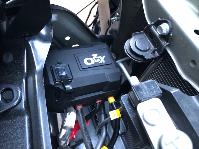

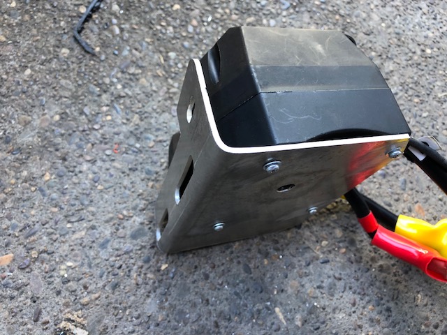

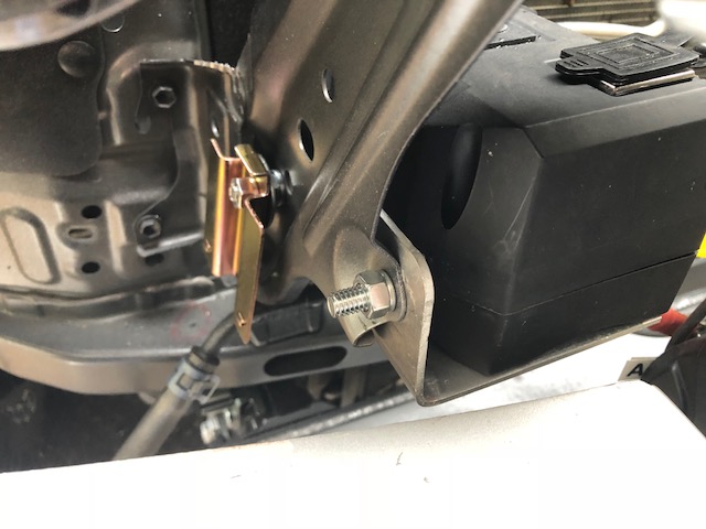

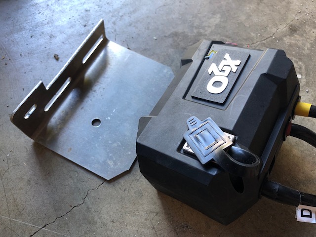

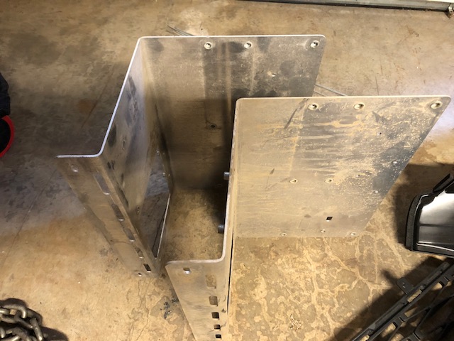

Sorry im bad about not stopping to take pics while im working. But I also found these large scrap aluminum brackets at work in the scrap metal bin. I brought them home thinking they would be perfect for making brackets and things.
Sure enough I need to mount the solenoid pack for the winch somewhere when I remembered those brackets. They were like 24 inches long so I cut a small section of out with the 90 degree bend already in it and holes for bolts.
Then I used one factory hole and drilled a second hole on this factory bracket to mount my new bracket too. Worked out perfectly. solid and looks good.

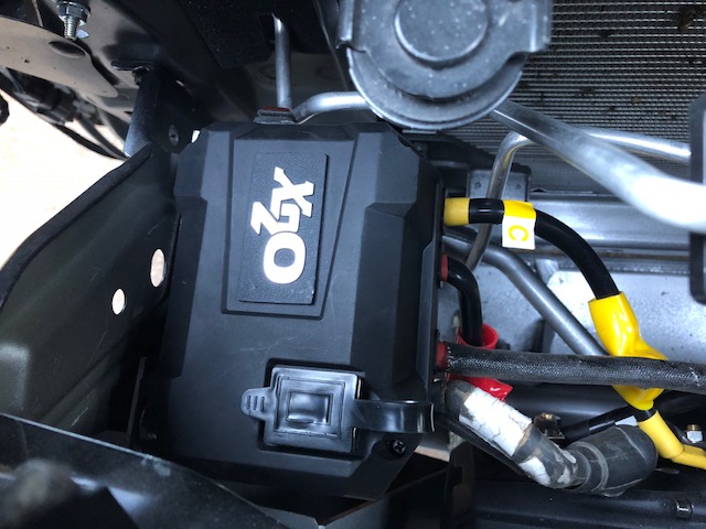

and here is the final mounting of the custom bracket and solenoid.

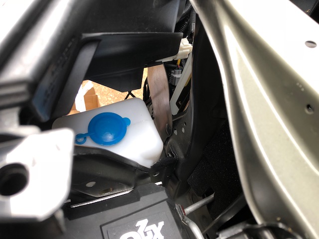

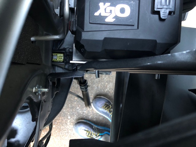

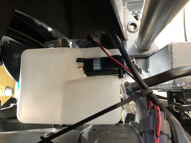

I also needed to reloacte the washer bottle. I didn't want to pay almost $300 for the 4runner specific kit out there. Seems pretty high. Plus their kit puts right in the way for the future ARB air compressor. So decided to mount it behind the bumper.
I bought a universal washer bottle kit on Amazon for $18 it came with a mounting bracket. I put the bracket right onto the bolt I already had hanging there for my winch solenoid bracket. SCORE! didnt have to drill another hole or anything. Hung perfectly there.

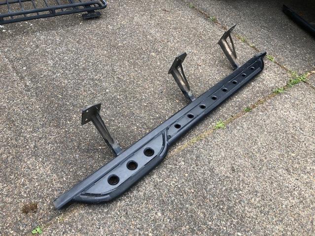

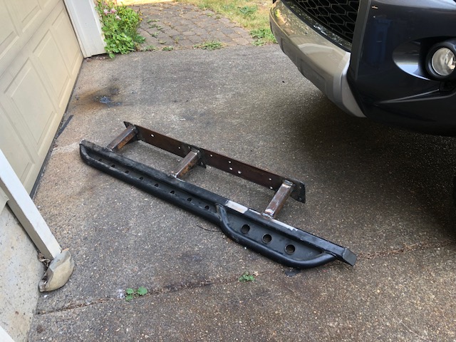

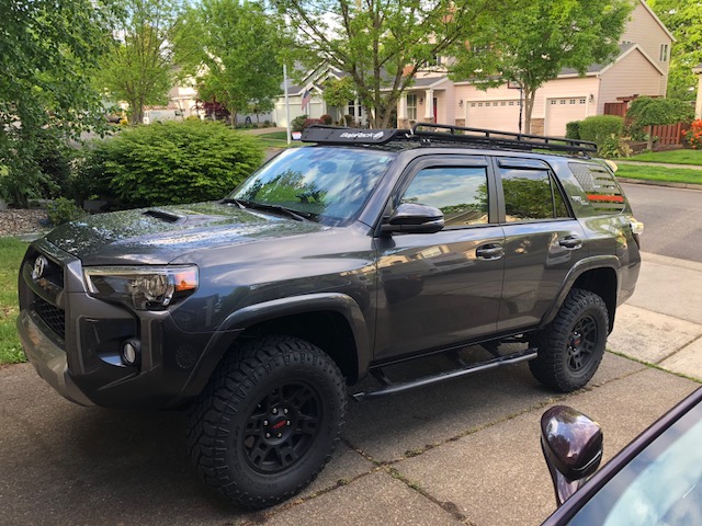

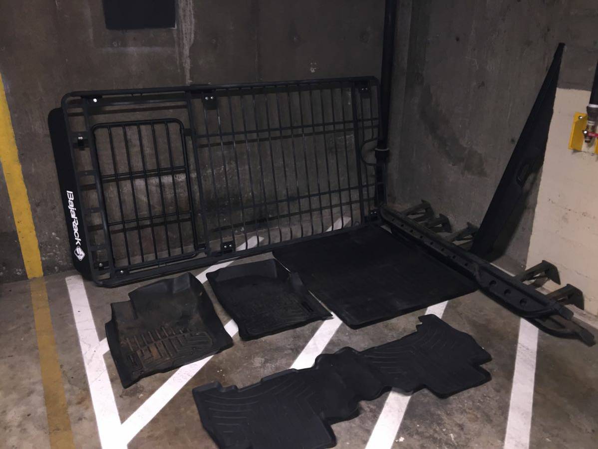

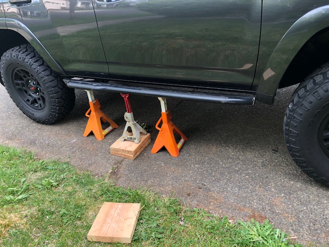

SCORE!! I picked up a set of sliders and a full length BAJA rack from a guy on craigslist for $700. They were on a 2012 4runner that got wrecked.

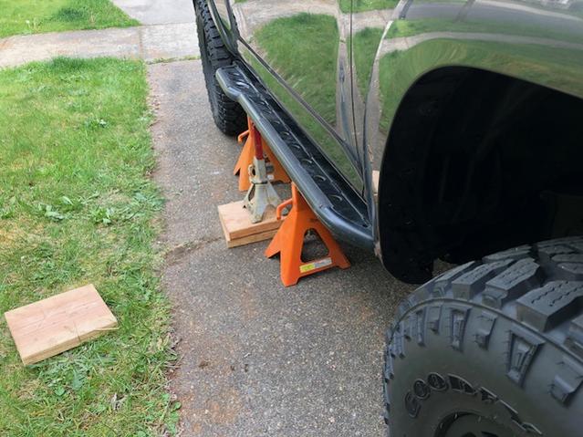

The sliders which were made my metaltech 4x4 were for a limited or sr5 so they hung down too low. So I started by cutting the legs off. and making new legs out of thick 2x2 tubing, I think 1/4" wall so even more stout than the original legs are started mocking it up to fit tight to the body.

You can see in this pic how much lower thery sit on a limited with the lower rocker trim. that wasnt gonna cut it. legs cut off and mocking up begun

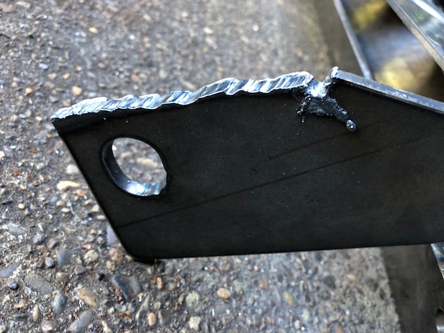

Here is a pic of my finished legs rewelded. I also extended the base feet to be one solid long piece of 1/4 inch plate instead of 3 individual feet. That allowed me to use twice as many holes in the frame for added strength.
