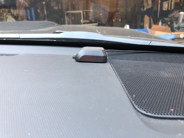

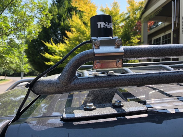

As for the GPS and Sirius antennas, initially I used the one that came with the tuner. I found the factory antenna wouldn't work well at least for me. Plus I wanted to remove the sharkfin which was the perfect place to mount my marine grommet which will allow my wiring for lights etc to go thru the roof and be watertight. SO eliminated the sharkfin. I recently installed this TRAM sirius antenna on my roof rack I found on amazon, its for truck drivers usually to mount on their mirrors but I think it works well on the roof rack. Havnt' been able to tell yet if it is better or not.

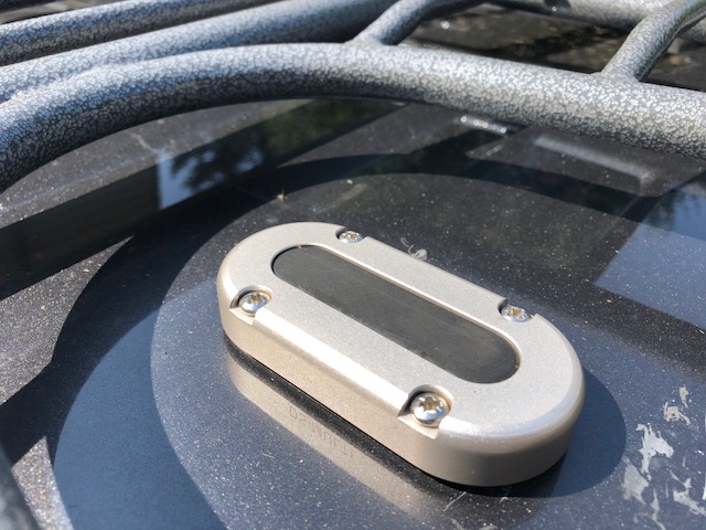

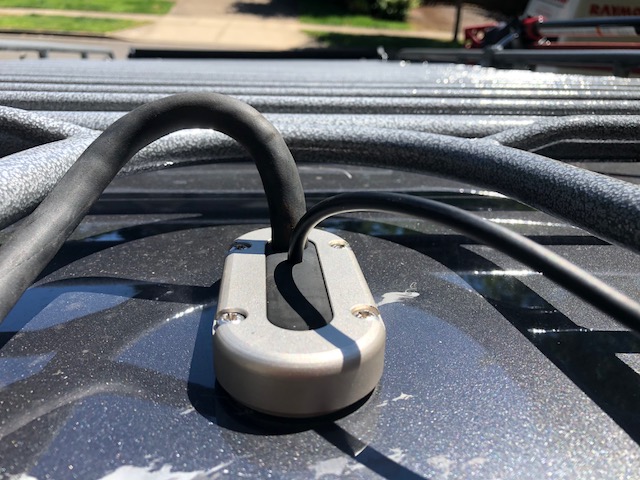

speaking of the sirius antenna cabling, Im working on that today. I drilled the holes in the rubber grommet to run the antenna coax and a 6 wire cable for lights etc in the future. Pain in the ass to get the wire pushed thru but doable.
And this makes for a super clean waterproof way to run the wiring thru the roof. This is a marine wiring grommet I installed in place of the sharkfin antenna. It is used on yahts and ships to run wires thru the decks and be waterproof.

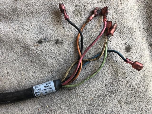

The 6 wire cable I got from work. Im a forklift mechanic (mainly electric) and this was an overmast cable I pulled off a truck. Perfect for use here I think. 6 large super flexible wires which will allow me to wire up my front light bar and leave 4 more wires for future lights and things already run.

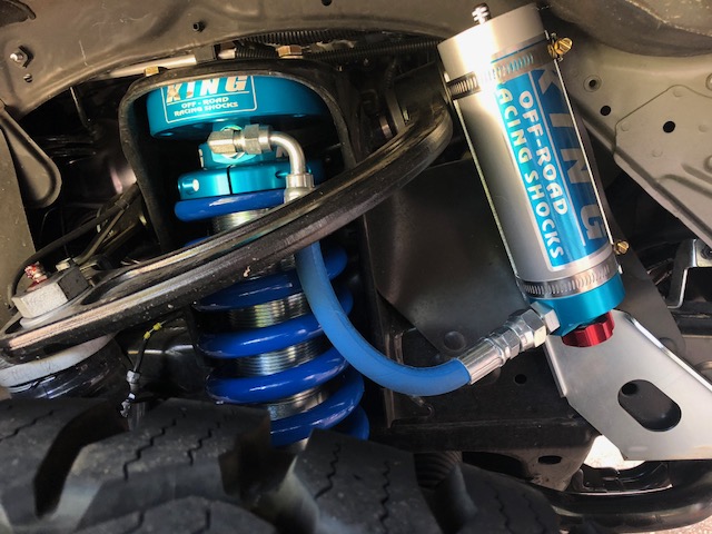

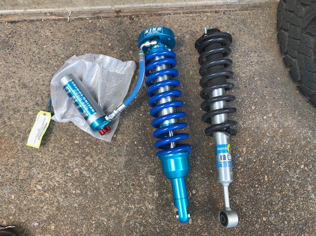

got My Kings Yesterday!! Got em installed today and will have to go get the alignment redone. With the SPC upper arms I set the balljoints to 4 degrees caster right out of the gate and will adjust from there.

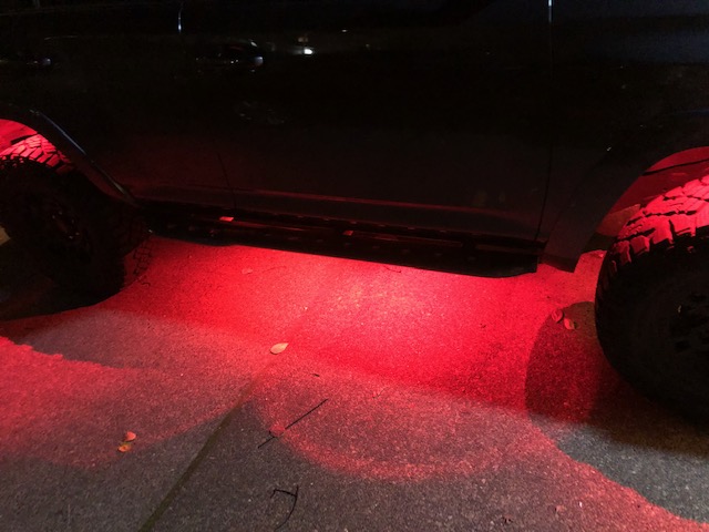

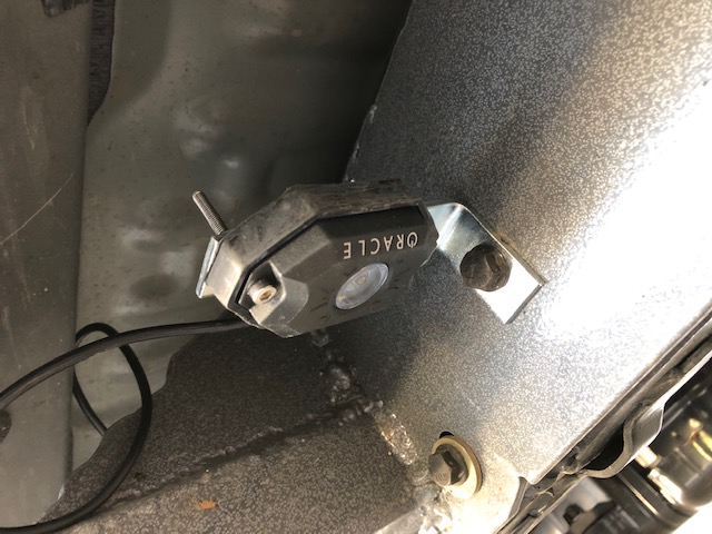

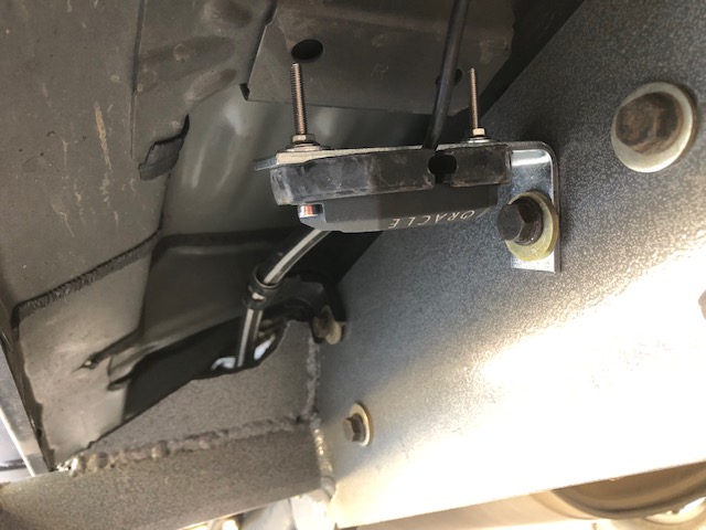

But today I just installed the Oracle rock light kit which comes with 8 led rock lights and with the app on my phone I can change them to any color I want. For now just doing red.
I installed one light in each wheel well and then 2 on each side above the sliders. I got some simple L brackets at hardware store, cut one side off of them and mounted them using a bolt in the frame.

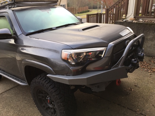

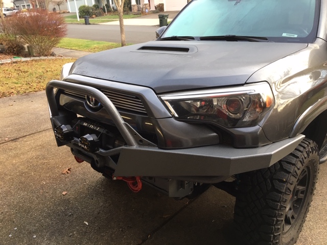

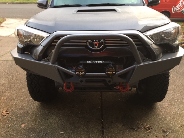

Sorry, have not been updating as much as I should. I got the front bumper powder coated, got the plastic trimmed and reinstalled, changed the light bar out for some PIAA amber led lights and all the little details done in front.
I ordered the C4 Fab rear swing out bumper which will be coming in January some time.
I also have a surprise for the interior coming in a couple weeks that will surprise some people lol Don't think I have seen anybody else do yet. Wait till you see it lol

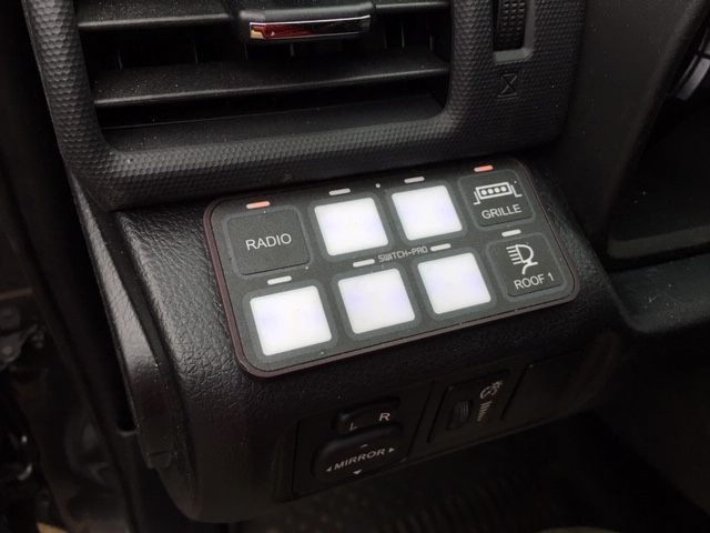

Things on my list.
1. Rear C4 Bumper on order
2. Change the roof LED light bar out for a KC Hilites 40" bar
3. Dual batteries installed soon hopefully
4. Interior work surprise coming soon

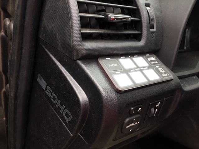

5. run some power wires to rear for some accessories switched off of the Switchpros panel
I know there is a bunch of other little details I can't remember right now, my brain is always working lol

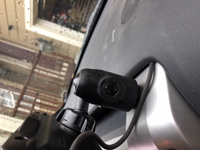

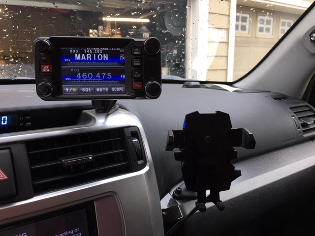

I also installed my Yaesu FTM-400xdr Ham radio using a ram mount that I took apart and used half of it, drilled a hole in radio bezel and mounted it. Nice and solid and adjustable and clean. I like it
I also used a ram mount and an 17mm ball adapter to mount my wireless phone charger

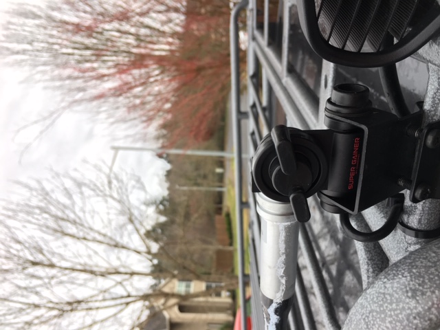

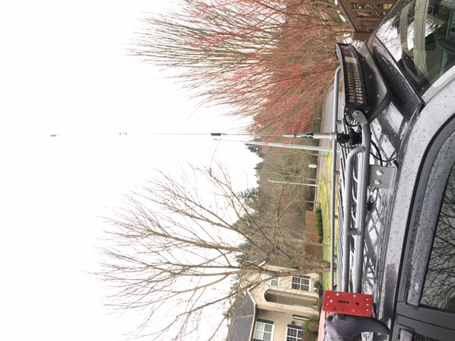

My ham radio antenna I bought a Super gainer dual band antenna and a Diamond mount that folds over. That way when I want to I just turn a knob and lay the antenna down like going thru a car wash or something.
Way better than the stupid hings in the antenna itself that kept being picked up by the wind on the highway and laying back. I pulled the antenna up and shot some super glue into it so it would not come out anymore and Just use my hinged antenna mount to lay it over when I want.
