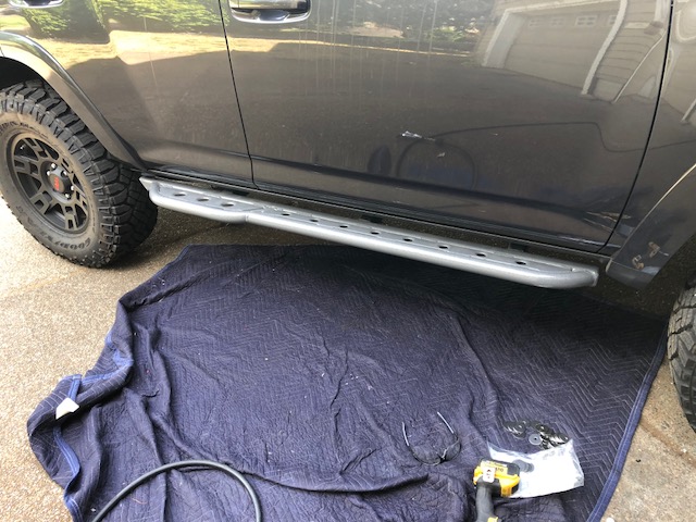

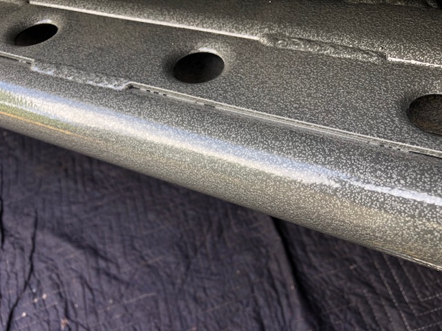

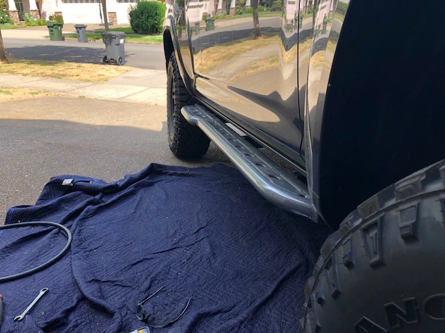

I've started powder coating everything in a dark hammered silver textured finish. The hammered finish will help hide scratches and scuffs better than a solid color.
Passenger slider mounted still need to do the drivers side one.

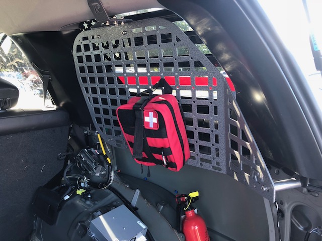

Had the Rago Fabrication Molle panels powder coated the same as my rack and stuff on the outside. A hammered silver. Alsp took the plastic C pillar trim out and painted them black as I hate the TAN colored interior trim, stupid for black leather interior.
So mounted the molle panels tonight. Still have the lower plastic trim out while I do some wiring over the next week for my CB etc.

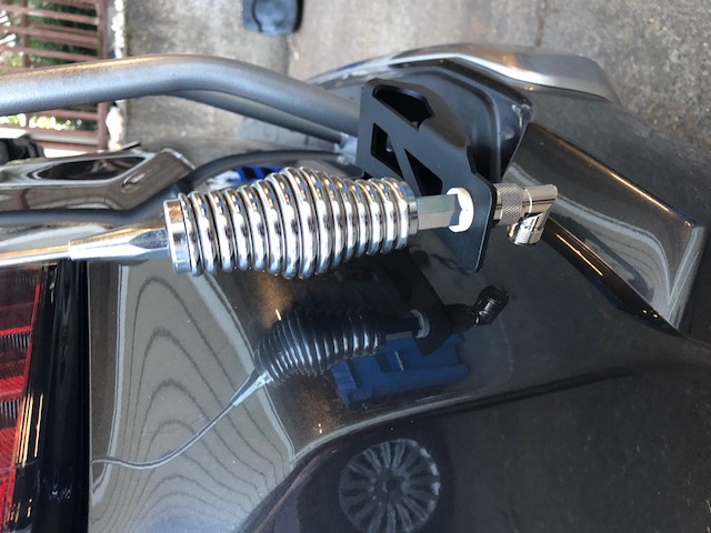

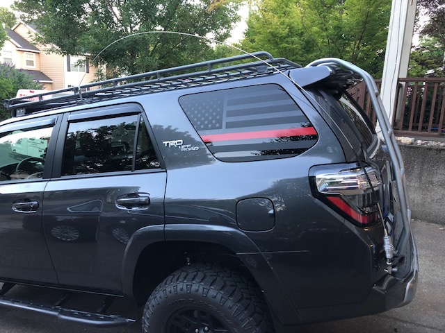

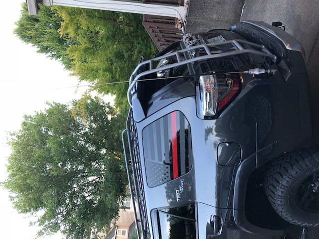

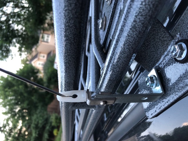

So tonight I started the Rago Fabrication antenna mount install and my 102 inch whip antenna.
The Rago mount went on easy, mounted the antenna and a 90 degree fiting on bottom to prepare for the cable to go thru the plastic when the coax cable arrives.
of course when around town and maybe sometimes in the bush I don't want the 8 foot antenna sticking up I wanted to be able to tie it down.
Found a standard whip antenna tie down bracket but needed to find a way to actually mount that bracket. I took a standard L-bracket from the hardware store, screwed the whip tie directly to it. Then drilled a hole in the bottom part of bracket and cut off the excess length and mounted it directly under the bolt holding the roof rack on. Simple and elegant. Later I will probably powder coart or paint the bracket to match the roof rack a bit.

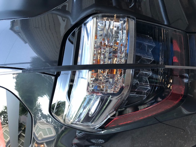

I noticed when the antenna is whipping around or when tied down it hit the tailight a bit. I slid on some thick heat shrink tubing and shrunk it, then did that 2 more times for 3 layers of heavy wall heat shrink which will add some cushioning.

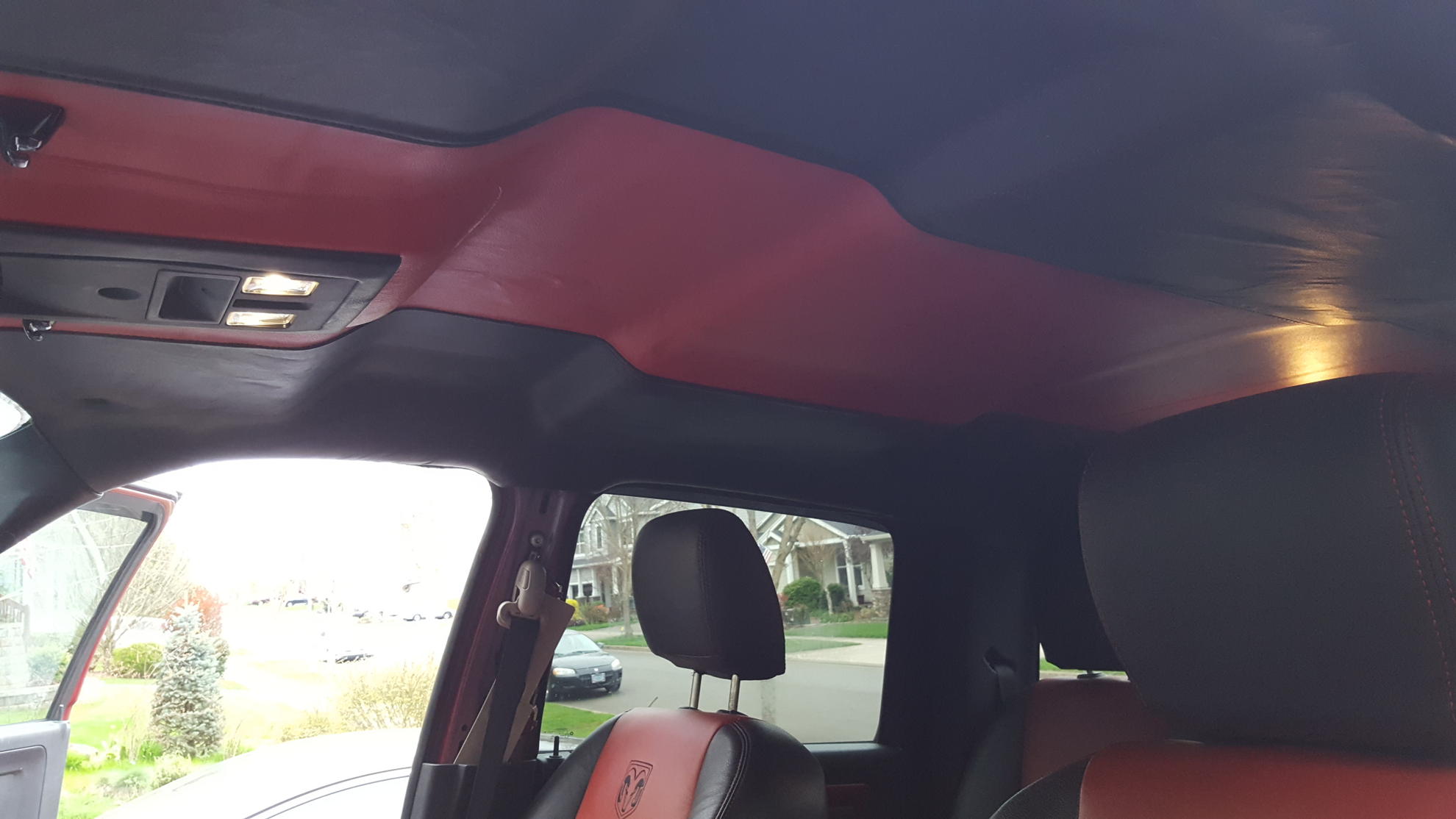

I havn't done any vinyl wrapping yet. Focused right now on getting things functional. I will be going thru the vinyl wrapping in a few weeks so stay tuned. I think I'm also gonna wrap all the A, B, and C pillar trim too. Then also covering the headliner in upholstery vinyl or leather. I did that on my Dodge Ram in black and red leather and it looked badass. I hate the tan interior pieces.

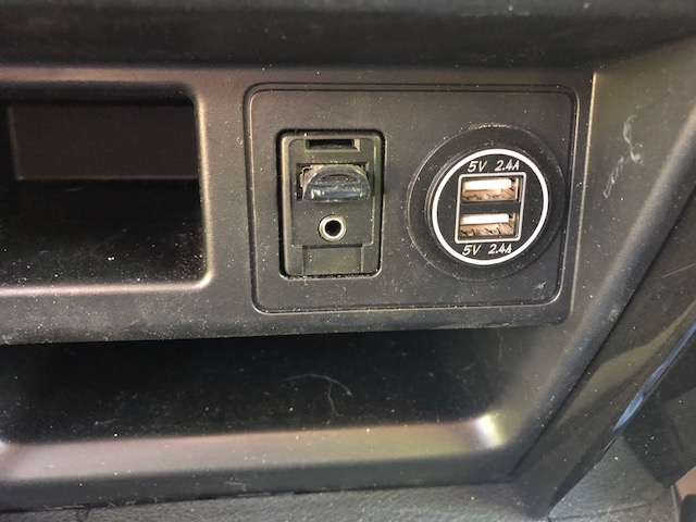

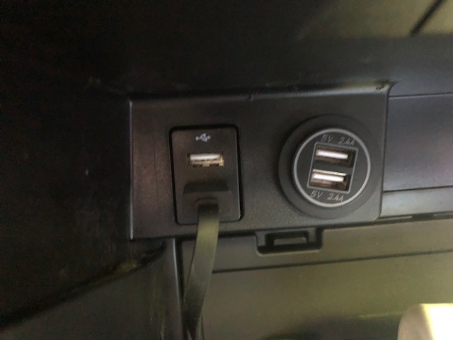

We needed more USB ports for charging phones etc. I piggybacked the wiring off the cigar lighter under radio to install a port in place of the cigar lighter on dash and to the ports in the glovebox.

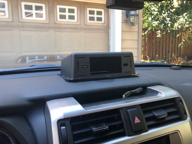

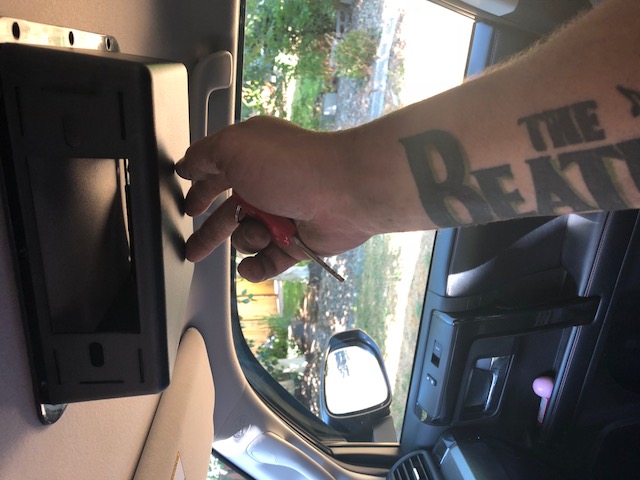

Im trying (like many others) to figure out where to mount the CB radio. I bought the Uniden 980SSB which is a little bigger but had the features I wanted.
I debated installing a bracket behind headliner and mounting it to the roof? Or on top of the dash. Can't decide.
I'm open to any ideas from people

So I had my wife sit in the passenger seat while I moved the CB radio to different spots and made sure it wouldnt be in her way or an eyesore. I finally decided on the roof being my favorite spot of the choices I had to choose from.

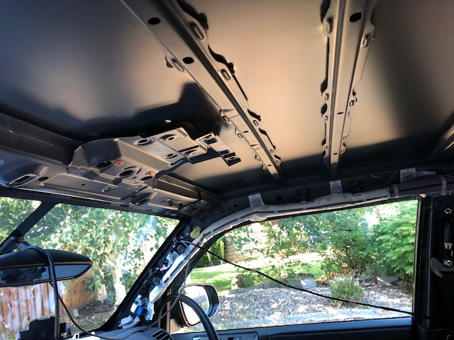

So roof it is. I was planning to take headliner out anyway to cover it in leather or something and get rid of the ugly ass tan.

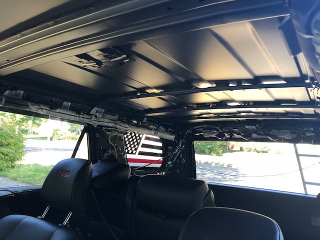

So here it is with the headliner out, bit of a pain but doable just takes a lot of time to remove every pilllar trim piece and grab handles etc.

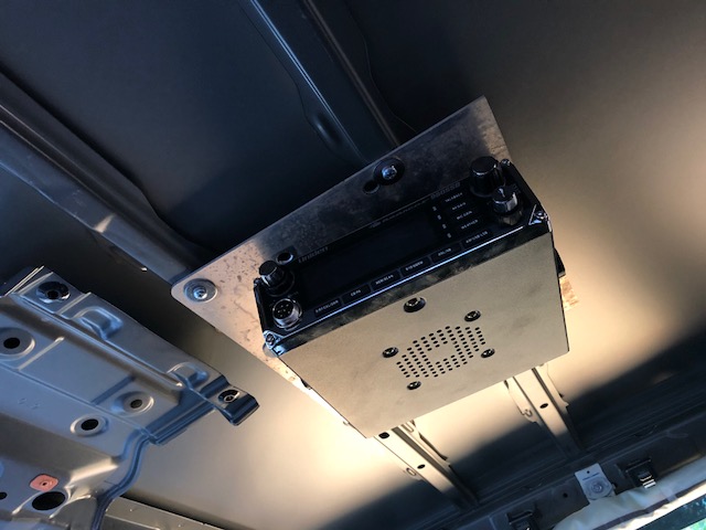

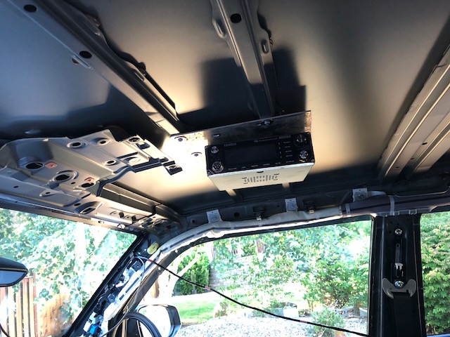

I found a piece of sheet aluminum at work and screwed that with self tapping screws to the roof braces. I then mounted the radio bracket to that. Later when the headliner is installed that gives a solid mounting surface to screw the radio bracket to.

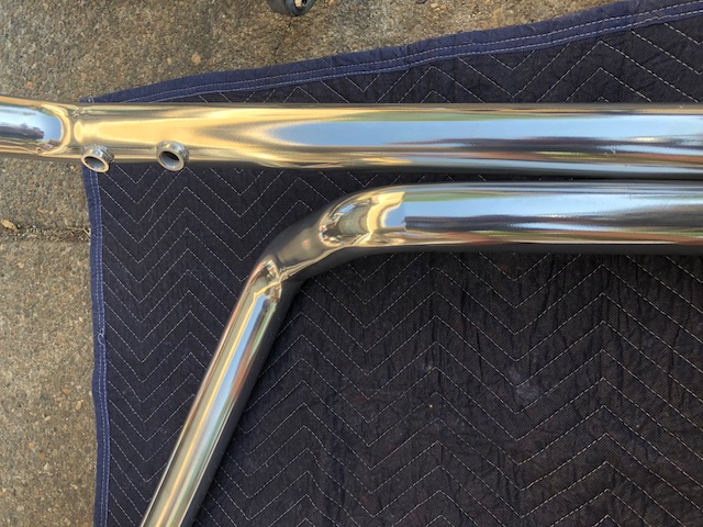

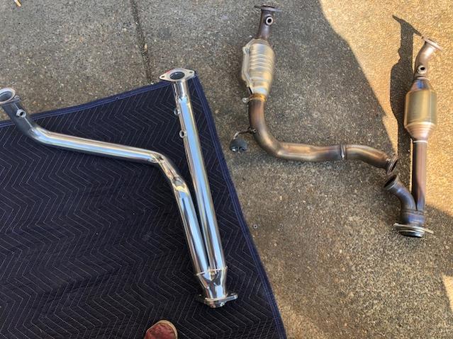

Got my URD Y-pipe finally. Some have questioned if it creates heat soak into the transmsission pan since it goes so close to it. Im not sure but to be safge and cover all my bases in the future I went ahead and had it ceramic thermal coated. That reduces the temp by at least 100 degrees. the side effect it looks nice even though noone will ever see it.
The new pipe comes with an extra 02 sensor plug in case you want to add something later. I plugged it for now with the provided plug.
