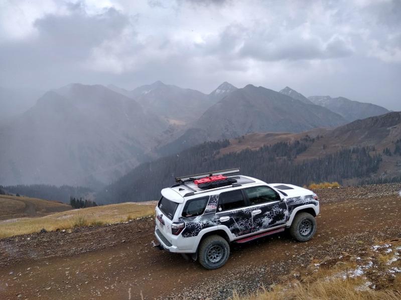

I was able to get everything I wanted on with 5 crossbars. Awning, Hi-lift Jack, 4 gallon Rotopax, and XBulls. Maybe I'll put a shovel on it, just have to figure out how to do it. Moonroof has a fully open view. I was able to keep from getting a 6th crossbar by mounting the 4 gallon Rotopax with just the center mount. It was plenty stable. I may eventually stack another 4 gallon on top of the original one for an 8 gallon capacity.

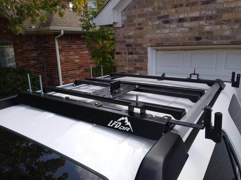

I was able to use mine. I have a Hi-Lift mount, my XBull mounts, and my Ironman Awning Quick Release Bracket on it.
