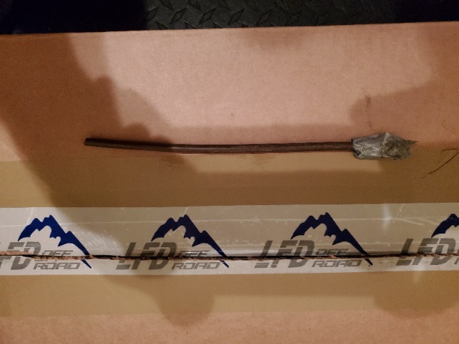

I forgot to mention one of the most versatile tools in my tool box. I call it the "stickum". It is a 8" piece if garden irrigation tube with duct tape wound a few times normally then flipped and wound with the sticky side outward. This will help you install the fairing. The "stickum" will hold the nut while you thread the bolt. When you try to install the nut and bolts in the center of the fairing it is difficult to hold the nut stable. Put the nut on the "stickum" and a put it under the bar aligned with the hole. Then thread your bolt from the top. It is so easy with the "stickum". I hope that this helps.

HAHA! Wow, why did I not think of this when installing!!! Hardest part was just getting that thread started!

I only used it for installing the two center nuts and bolts of the fairing. They can be difficult to install because of the distance from the side of the truck and the angle of reaching under the cross bar while balancing the nut on your fingertips. I stuck the nut on the tape, aligned it with the hole, and threaded the bolt from the top. It makes it easier to get the bolt started in the nut. Once the bolt is started you can reach with your fingers to keep the nut from spinning as you tighten it up.

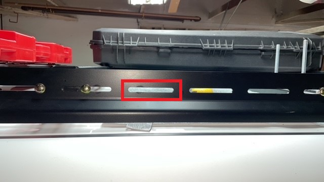

Should I be able to mount a crossbar in one mounting hole in the side rails (see red square in pic)? Currently, the carriage bolts just barely do not fit. They go in but the square part of the bolt makes the bolt slightly pop out and not sit flush. I could get non-carriage bolts and it would fit, but if there is a structural or safety reason for not being able to use one hole, I would not want to do that. Moreover, the bolts provided should fit.
