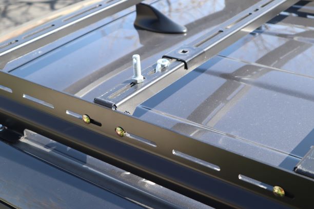

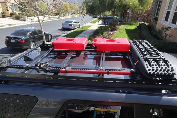

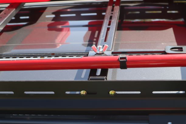

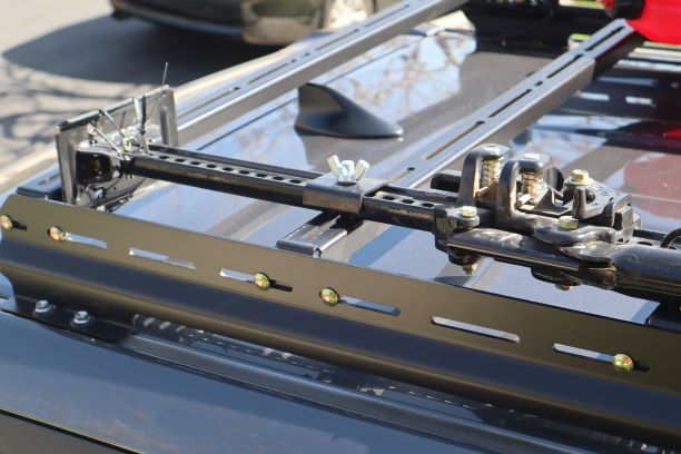

Here is my 7/8th LFD with Track Boards, Hi-Lift, and Fuel Packs.
Here is the way that I attached the Hi-Lift. I used the Hi-Lift mount for a Jeep and tossed the riser. The hole in the crossbar is just about the right size to fit the bolt through and use a nut to hold it in place. The top plate and wing nut work great.

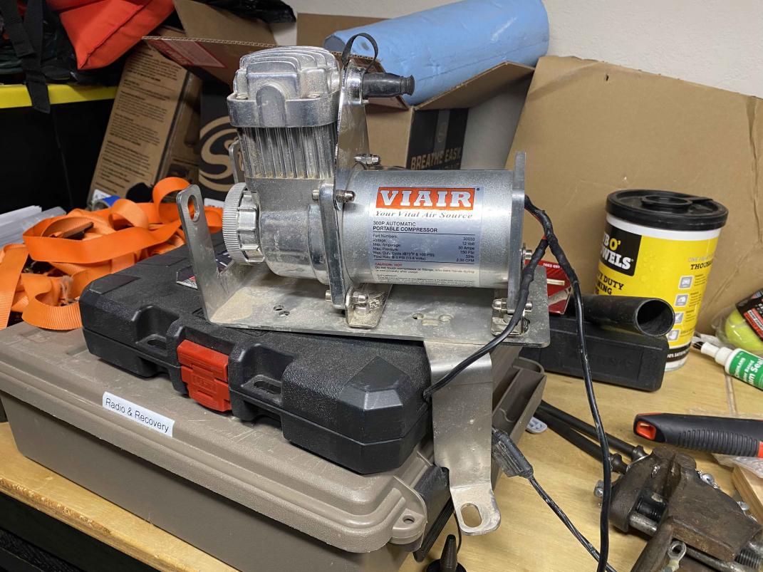

The plate is pretty easy to work with. I managed to fit my old Viair 300P on it. I am currently looking at the possibility of mounting this under one of the bumper covers.
Based on this, it appears a 450 might be too large for this compressor plate. Also, where did you find that rubber cover for the male air hose connection?
