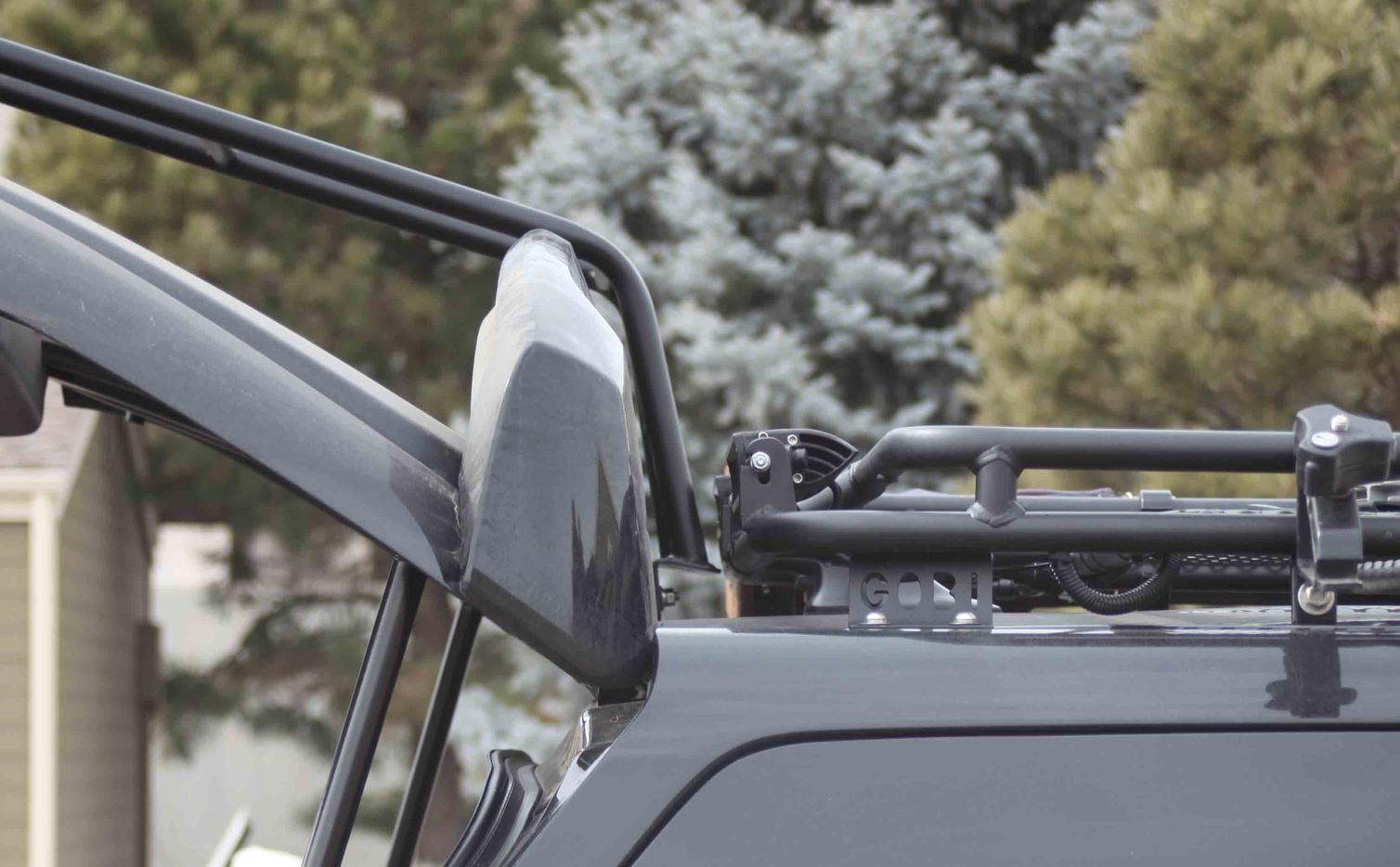

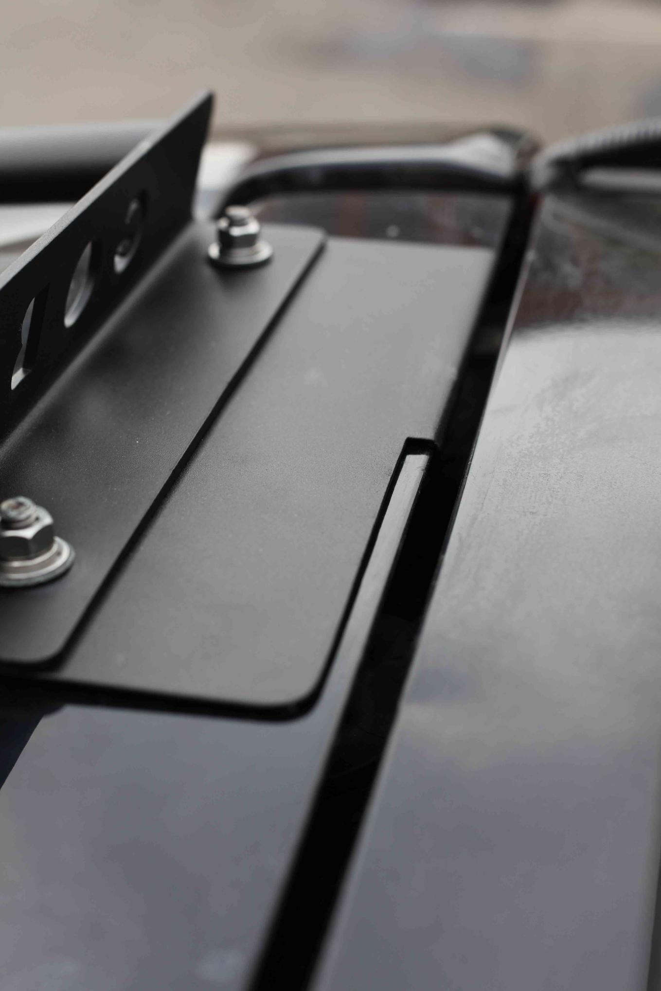

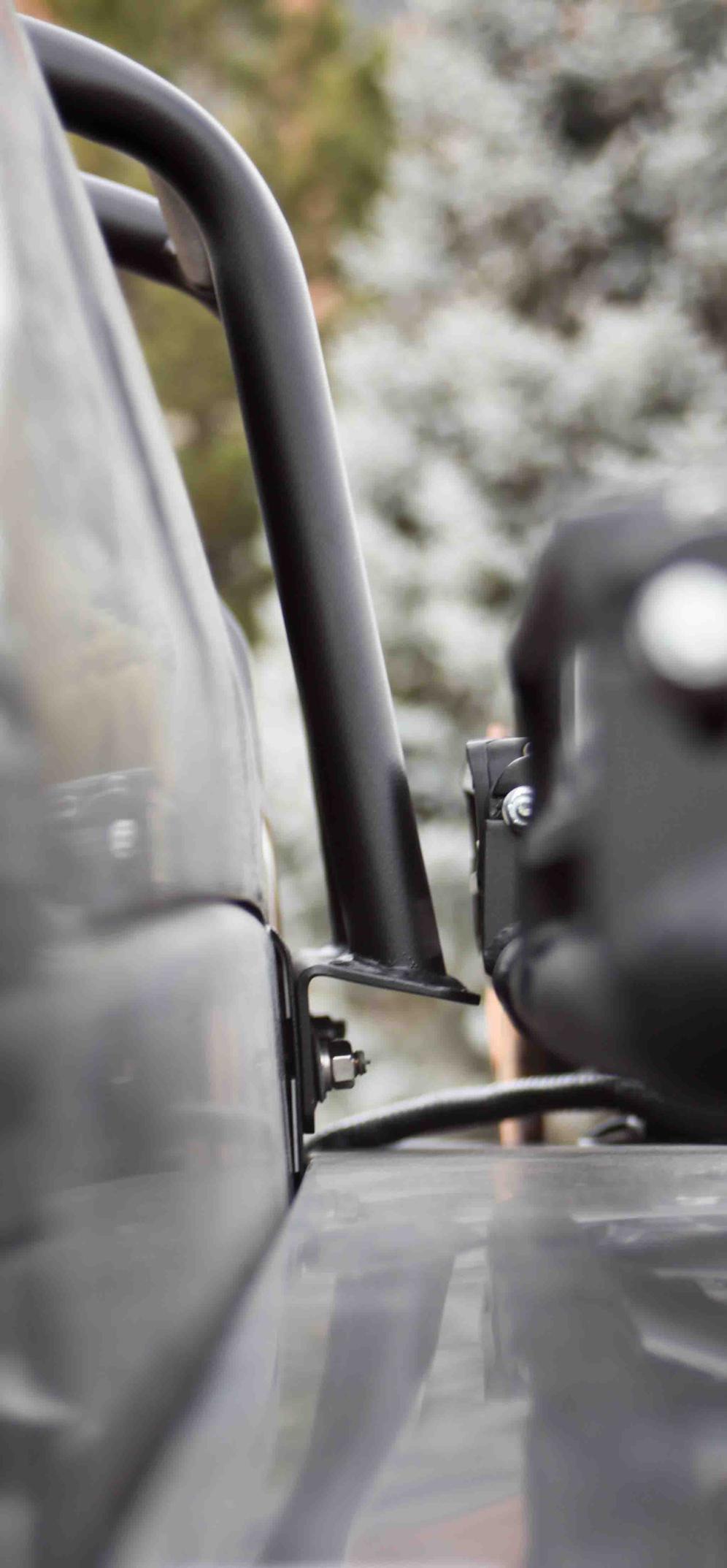

Well, it’s been a little bit of a roller coaster but I think we are finally there! This is the final GOBI ladder plate for the 5th Gen Toyota 4runner. Installing this new plate to the plate you have currently, will stop the contact and rubbing issues you have been experiencing, certainly those who upgraded their rear gas struts.. I have had it installed for a few days and its looks very promising!
I can’t speak for those who have the Baja rack and Gobi ladder combo due to the pure fact the racks have different dimensions. I would call Paul at Gobi on that one.
Here it is:

Looks like it will definitely hit the Baja rack. Maybe its just me, but it looks like the angle is now different when its fully up. Guess we will see when mine gets here next week. I hope it will work with these revisions.

Yes the angle is slightly different. It seems the ladder mounts a little further away from the plate, than the original one. I have never seen a Baja Rack in person though from the images I have seen, it seems that the rack sets further back than the Gobi one..?

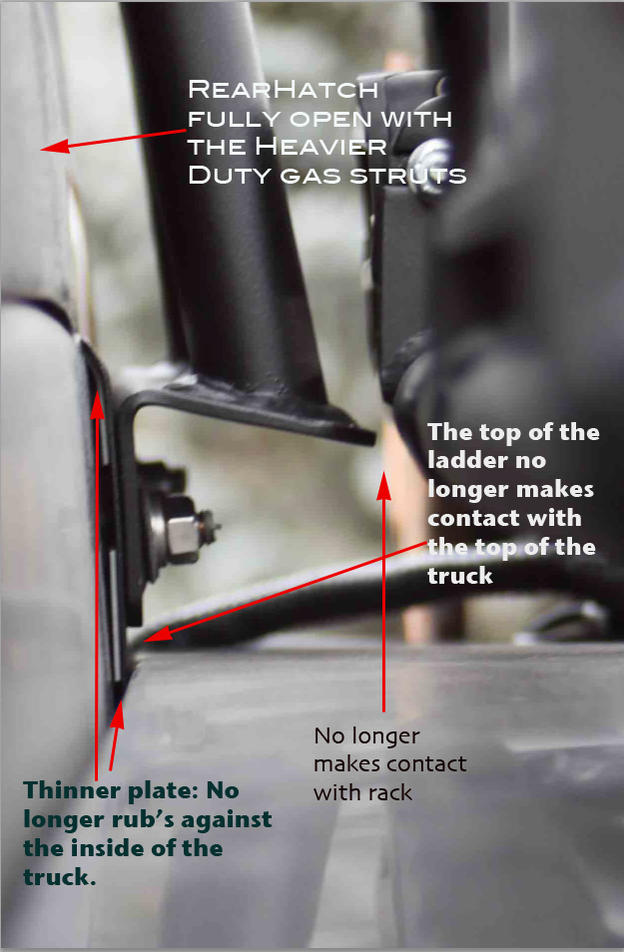

Good question. Hope this diagram helps. Let me know if you need further images.

Looks exactly like the plate I installed last Tuesday.
Yes it does... though from what I understand; thats from what Paul was telling me. Is that he moved the location of the threads of where the ladder attach's/ mount's further back to stop the rubbing issue and contact from occurring. He did this mid-last week to the plate.
All I can say is that mine has stopped, both rubbing and making contact. I would call Paul for your concerns. Sorry man, good luck to you and keep us posted.

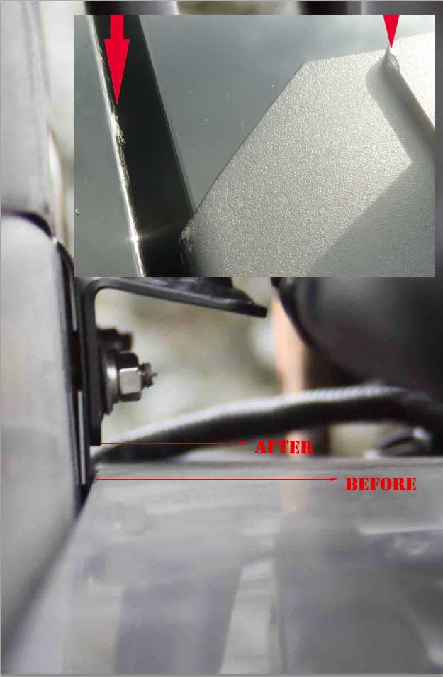

Phillyd2, I understand your thoughts there. I don't by any means want to speak for everyone because it worked on my truck so it should work on everyone else's. I had a similar issue to you, though mine was deeper. Mine actually dented the top of the roof where as your's scratched the surface, if you will (from what I have seen picture wise)
Here is a diagram:
