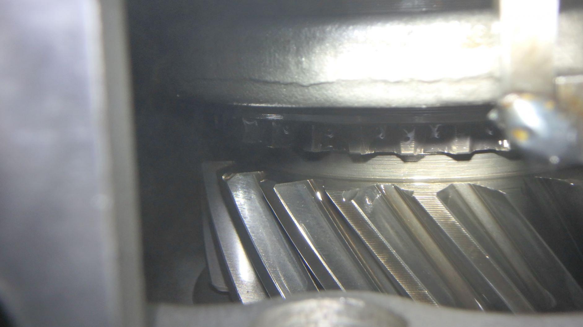

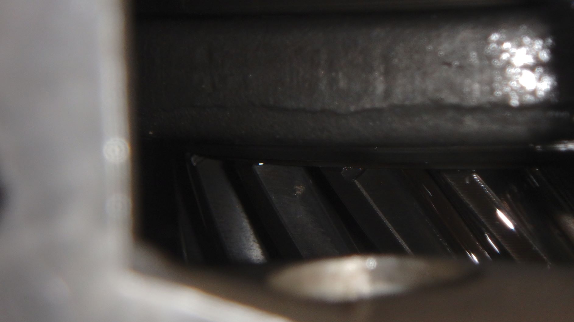

Doing an update about my popping out of gear issue with the TGcase, for anyone reading up on said. I posted that my issue was gone after having the gears modded but that was only a partial truth, on low to medium gears the issue was gone but on steep gears the TGcase continued to pop, i didn't want to update until the issue was completely fixed. Before I got that issue I started braking elocker diffs so my focus switch to overcoming said. During my axle assembly upgrade I pulled the TGcase and found that I had chipping on the 1:1 gear and also noticed that in the 1:4.7 gear position the the shift gear and collar where not fully engaged (there was a 1/16" space between the gear and collar.
After talk with TG they paid to ship the unit back. I was told they replaced everything internally but it was clear the original gearing were all there (not that I feel they needed to replace everything, just fix the issue, just dont say u did something u didnt). The paper work lists replacement/shim of the synchro gear. The first thing i noticed, with the case out, was when i put the unit in gear and turned the input shaft was resistance that was not there previously (to say u could feel the gears turn against each other, as before in gear the shaft turned as easily as when in neutral). The popping is completely gone, but i havn't put a ton of miles on said yet, and the unit is operating as it should have from the start. I would like to note that when i talk with TG told them i though my unit was out of warranty (it was not) and they didn't care and where still going to pay for shipping and fix the issue, from talking with them it sounded like the had a batch of units that had some type of internal tolerance issues. It sucked going through the repeated R&R of the unit to figure it out but when moding i feel "issues" r part of the game, TG standing by their product and not giving me the run around is all that madders in the end

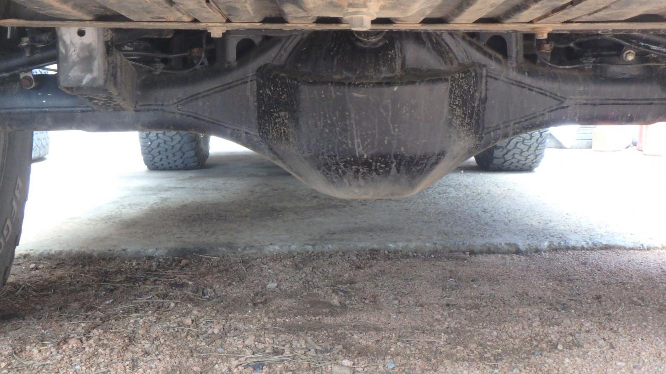

On a diff note the first weak put going dual cases was my rear diff not the CV's (which im guessing will be my next failure)
After reading put on some others and a buddy that had the same failures with the stock rear diff and my own 3 failures I ended up putting a tundra 10.5" axle assembly with and ARB under my 4runner, after heavily modding said. I am running one of the heavier 3rd gen I believe and dont fault the oem diff I was just asking to much of said.

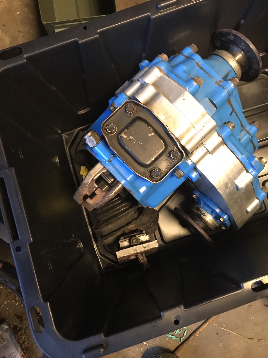

So, picked this gem up for a steal. 4.7:1 low range, Inchworm Lefty; 945 shipped to my door.
I plan on running dual cases; however, I’ll be sticking to the stock 2.28:1 low gear in the front box.
I need to convert the lefty to a Top Shift, then down the road will be getting, more than likely, a TG crawl box and adapter set.
I might just thrown this Lefty in for shits and giggles until I’m ready to do Duals.

You’ll be impressed with that tcase alone honestly. My brother in law is running the same in his taco and in 4lo there is really no need for dual cases imo.

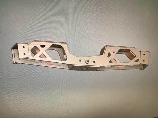

BTW, I'm working on a high-clearance transmission crossmember (with an extension for a crawlbox mount) but it requires either a Lefty, or some way of clocking the chain-driven transfer case...

Yeah, I'm 1.25" BL on the 4Runner , and flat bellying both the 4Runner and my Taco. The 4Runner needs the BL for clocking the chain case; the Taco fits the Lefty without a BL.
F150 tank relocation on the 4Runner, and I made some brackets to lift the stock tank 2" on the Taco. :)
I’m hoping this crossmember design works for both:

I mocked up and measured with the stock transfer case last week - I need 22 degrees of clocking to clear the frame rails (and barely clear the floor with the 1.25" BL), however, my cross member design retains the stock mount location which is dropped a bit below that height, and the sides angle down toward it, so less clocking may be workable. From what I can tell sketching it out, the old BudBuilt clocking ring <s>was 15 degrees</s> *see EDIT below - not sure if that clears my cross member just yet. Worst case scenario: I make my own reduction box adapter at the transmission that clocks the required amount - then I can run standard available MC/TG/IW stuff between the reduction box and the transfer case.
All that without lifting the drivetrain (lower COG). Triple sticks, yes.
EDIT: the BudBuilt ring is probably clocked 28 degrees (did some CAD work on it while working on my clocking ring last night.)
