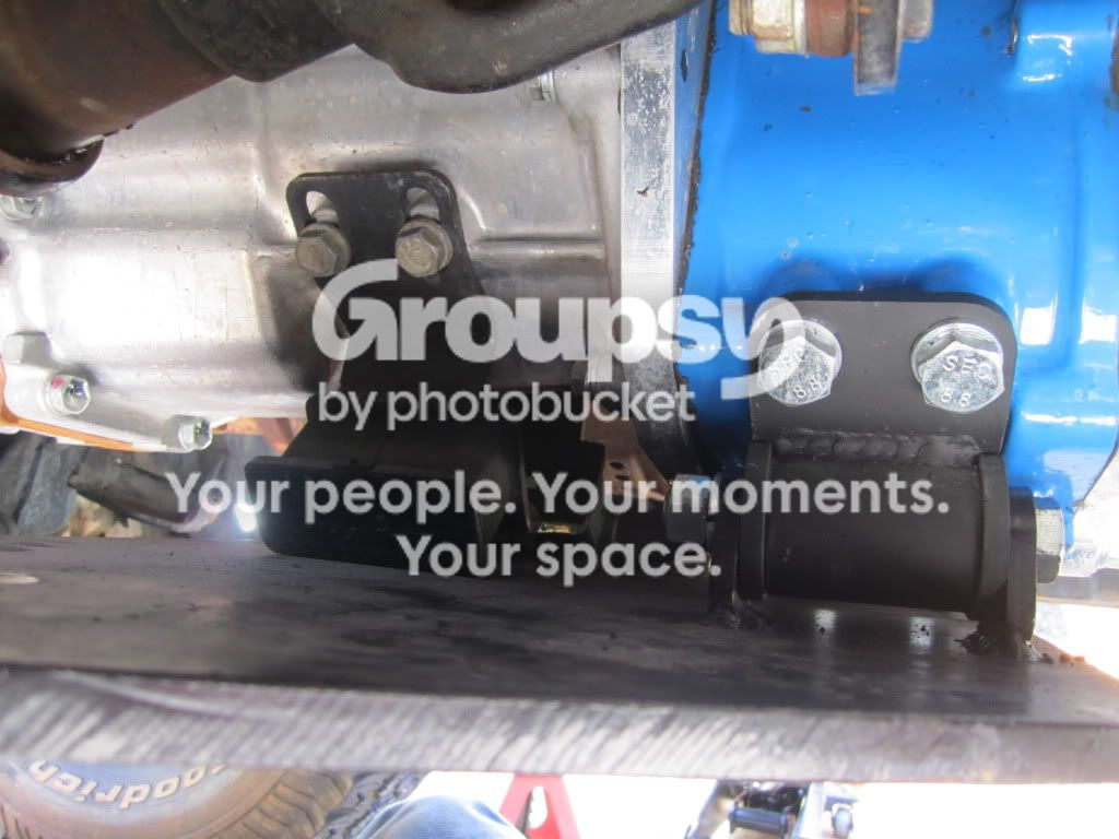

1. Whatever mounts you use, use the same material for the entire drivetrain (engine, transmission, transfer case).
2. Personally, I always tried to have a mount for each case. I don't know if it's required, but it seemed like a good idea to me.

4. While I love FROR/Diamond Axle, I decided not to use their case mounted crossmember. I did use their skid plate to create my current crossmember. I've seen people on other forums questioning whether or not the case bolts should be supporting the loads of the drivetrain. I chose not to risk it. I also had to add a Heli-Coil to one of those rear case bolt holes recently due to thread degradation that was preventing me from reaching torque spec. I was afraid that it would strip out completely if I tightened it any more.
5. Rock Defense is probably the easiest overall if you're willing to or planning on cutting out the factory crossmember. It gives you the option to mount multiple cases and acts as a skid plate as well. You won't have any driveshaft interference issues. You will run into issues if you plan to clock your transfer case because the built in mount platform would be useless at that point. I also don't personally like the way it attaches to the frame, but it's effective.
6. My first couple crossmembers were designed off of Bud's. Not sure if his universal crossmember is still the same. They worked well if you're willing to cut and make other modifications, including clearancing your floor.
7. The plates welded to the back of the factory crossmember seem like a good simple solution, especially if you plan to use factory mounts. It's at least a good, fast starting point. Seems easy enough to do and can be easily changed in the future to any of the other designs because it requires no modification to the frame. This is also a good solution to use the skid plates you already have.
8. I'm not sure how or why you would combine a FROR crossmember with the factory crossmember or a plate added to the factory crossmember.
9. For the mounts, any of the HD style polyurethane bushing types are pretty much the same. Pick whichever one you like best. If you go with one of these, change your engine mounts to polyurethane as well. They will allow more vibration to be transferred to the body, but I've found that any noticeable increase is normally due to something else making contact that I didn't notice or overlooked. So if you get increased vibrations make sure you check for hard parts making contact first. I've had my sliders hitting the pinch weld under the rocker panels (lots of vibration), transfer cases hitting the floor, etc. I'm pretty sure the bushing I use for the engine mounts is Energy Suspension part # 3.1108. It's a Jeep transmission mount that will bolt to the factory engine mount location. You'll need 2, and they're normally available at your local auto parts store. Here's a picture of mine in the Tacoma.

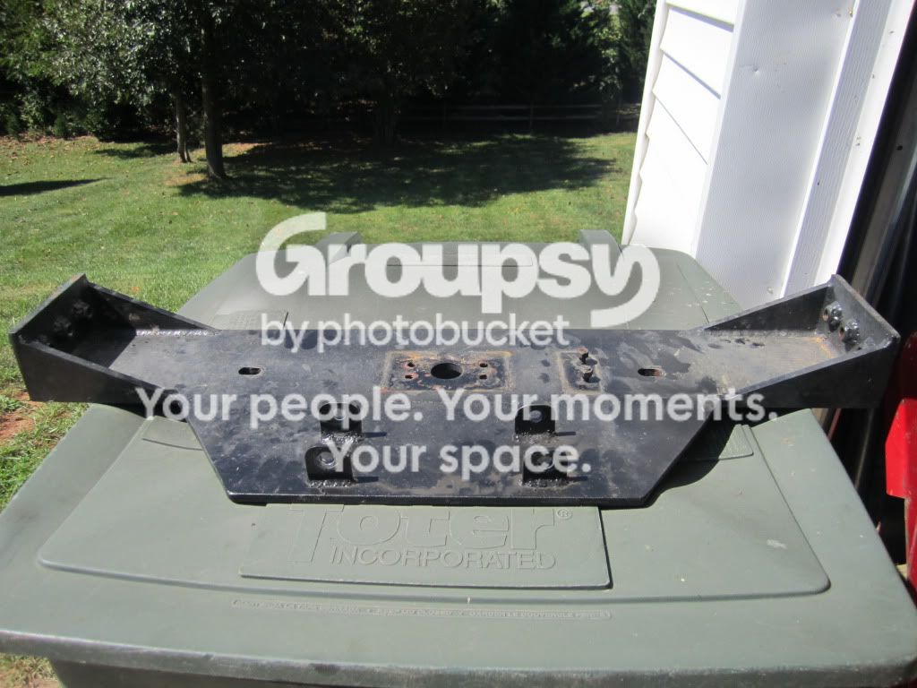

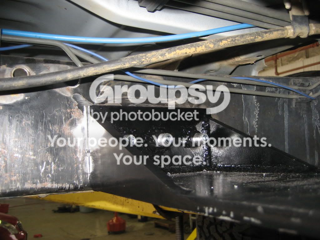

Most of this information will be coming from my truck build, but will transfer over to the 4Runner.

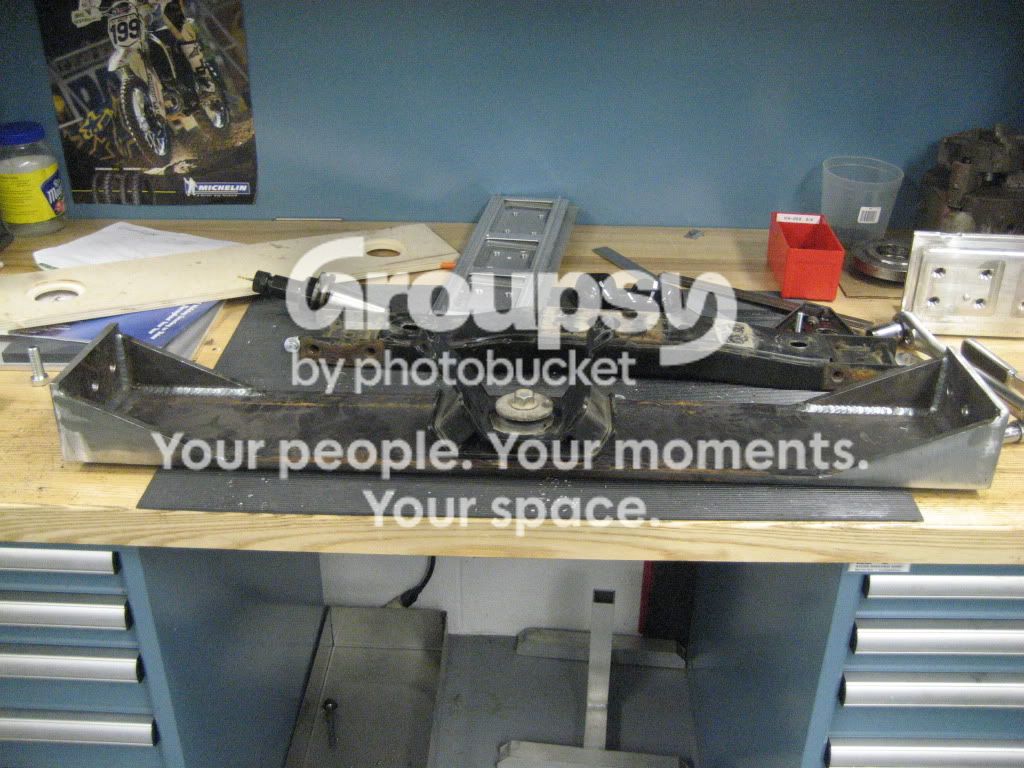

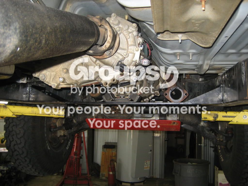

Here's the series of stages I went through with my crossmembers.
Stage 1:
Flat belly, BudBuilt Clocking Ring, BudBuilt Skid Plates.
This setup worked great. Factory vibration damping with a completely flat belly. The only thing I didn't do that I should have is sleeve the frame with tubes to prevent the frame from "collapsing" as the mounting bolts were tightened. I ran this setup for a while until I had a catastrophic failure of my rear driveshaft that took the transmission and clocking ring with it.

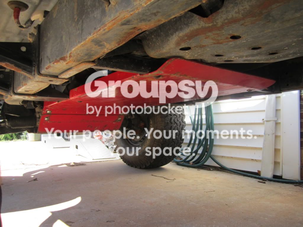

Stage 2:

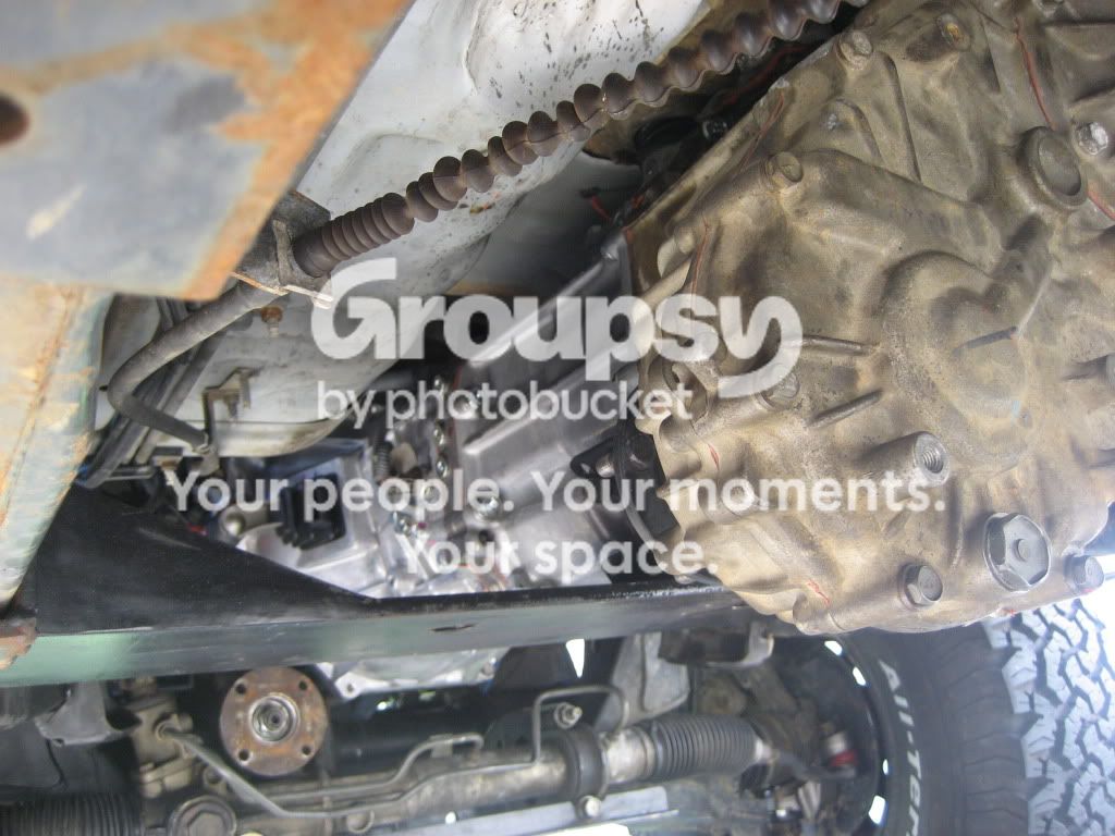

Flat belly, Inchworm Lefty, BudBuilt Skid Plates.
After my driveshaft failure that caused a bunch of carnage, I decided to go with a Inchworm Lefty instead of another BudBuilt Clocking Ring. For this change, I just welded an extension to my crossmember and added a HD style mount. I did have to modify the mount for the clearance I required.
This also ran well and I kept it until I went with dual cases.
Of note, you have to run a clocked transfer case with both of these because when you bring the crossmember flat with the frame, the crossmember will block the front driveshaft. Clocking the transfer case raises the output flange high enough that the driveshaft will clear the crossmember. This picture shows the interference.

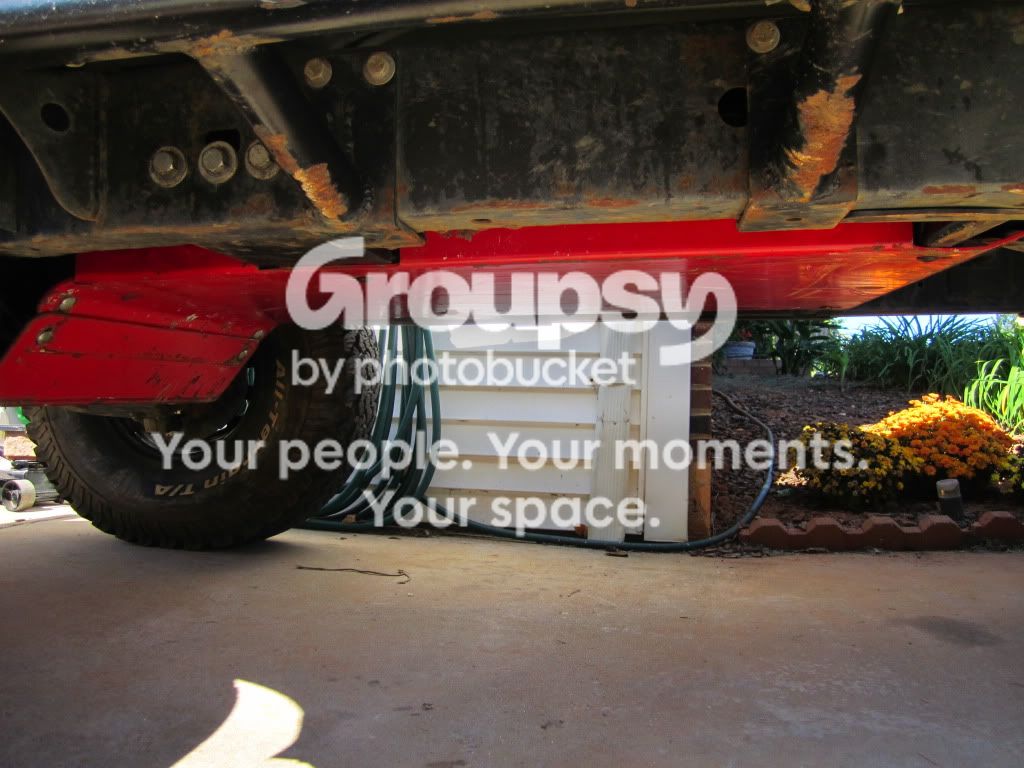

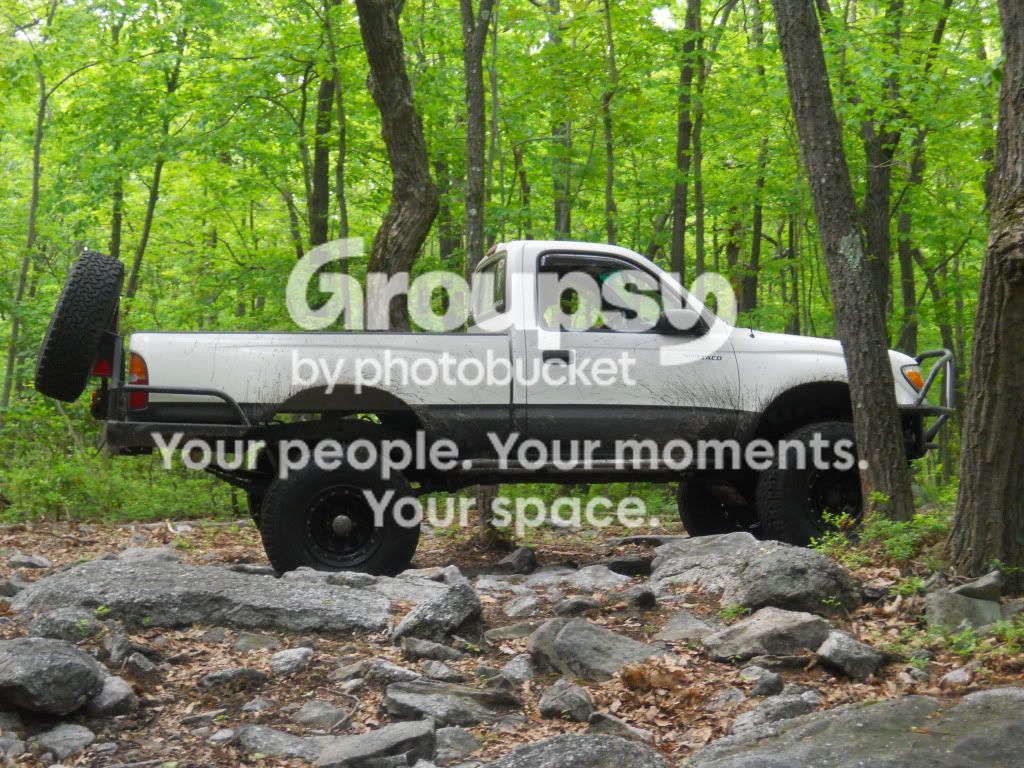

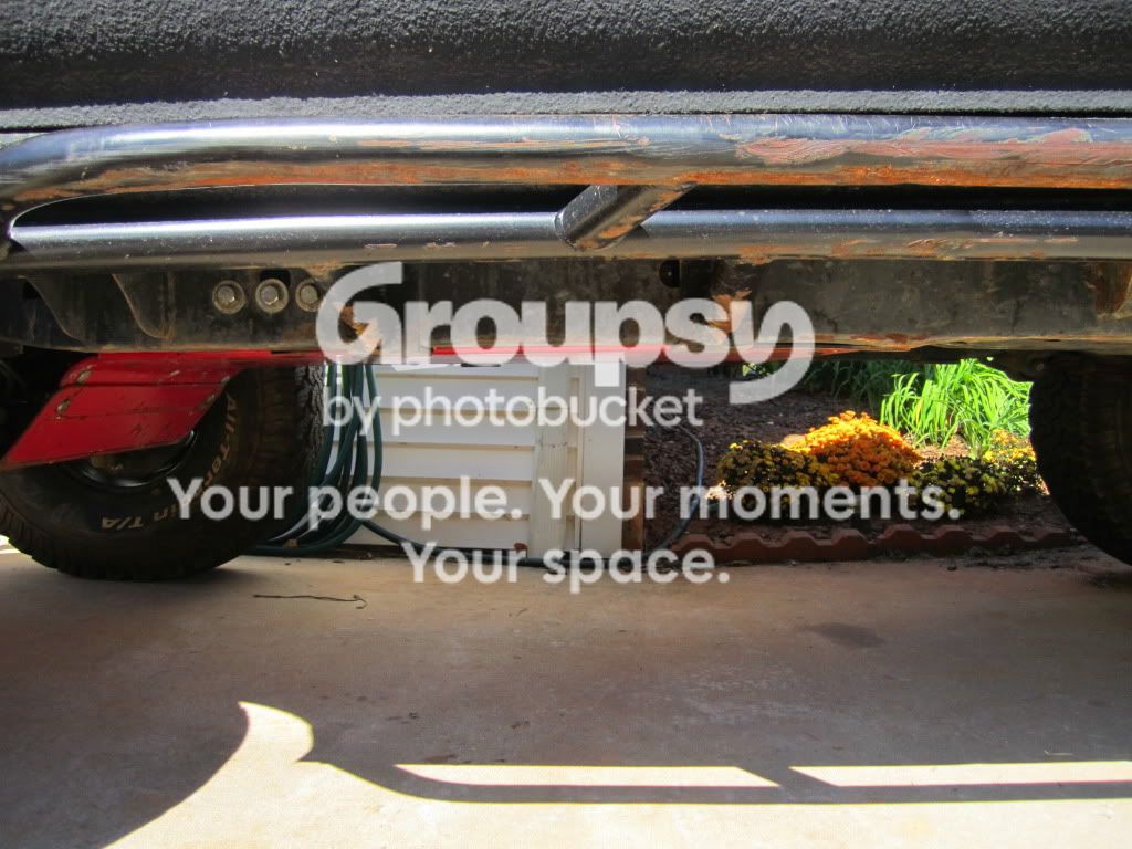

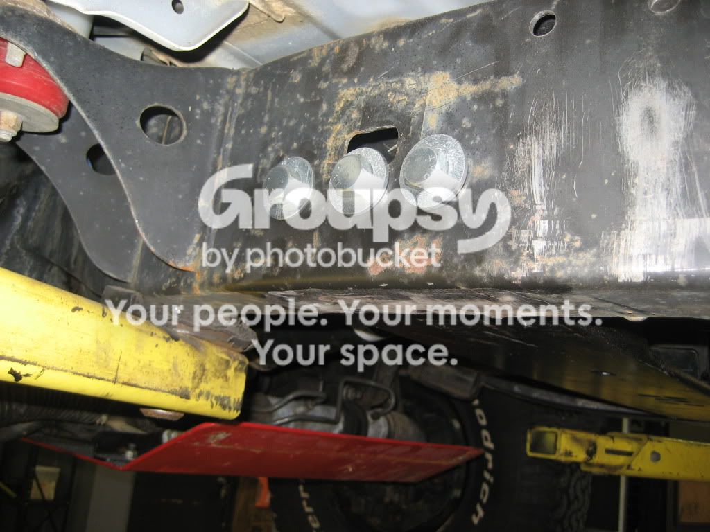

Here's a few pictures of the ground clearance I had while running these setups.
Stage 3:

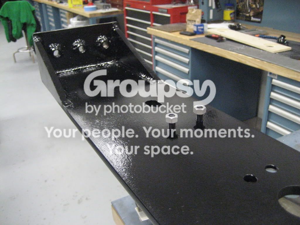

Flat belly, dual cases, custom skid plate.
This was my first setup for my dual cases. While it worked well, vibration was increased and it was way too complicated. I was designed to support the drivetrain while also providing a mounting surface for the skid plate. It did those well, but it was very heavy and was a pain to work on. Also, the 1/4" UHMW skid plate warped due to the heat from the exhaust. Later I used a 1/8" aluminum plate bolted to a 3/16" UHWM bottom layer.
Stage 4:
Flat belly, dual cases, skid plate/crossmember combo.

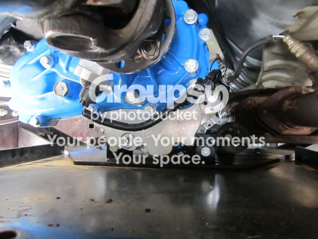

This is what I'm running in the Tacoma now with a 3 link SAS and passenger side drop transfer case. It's simple and effective.

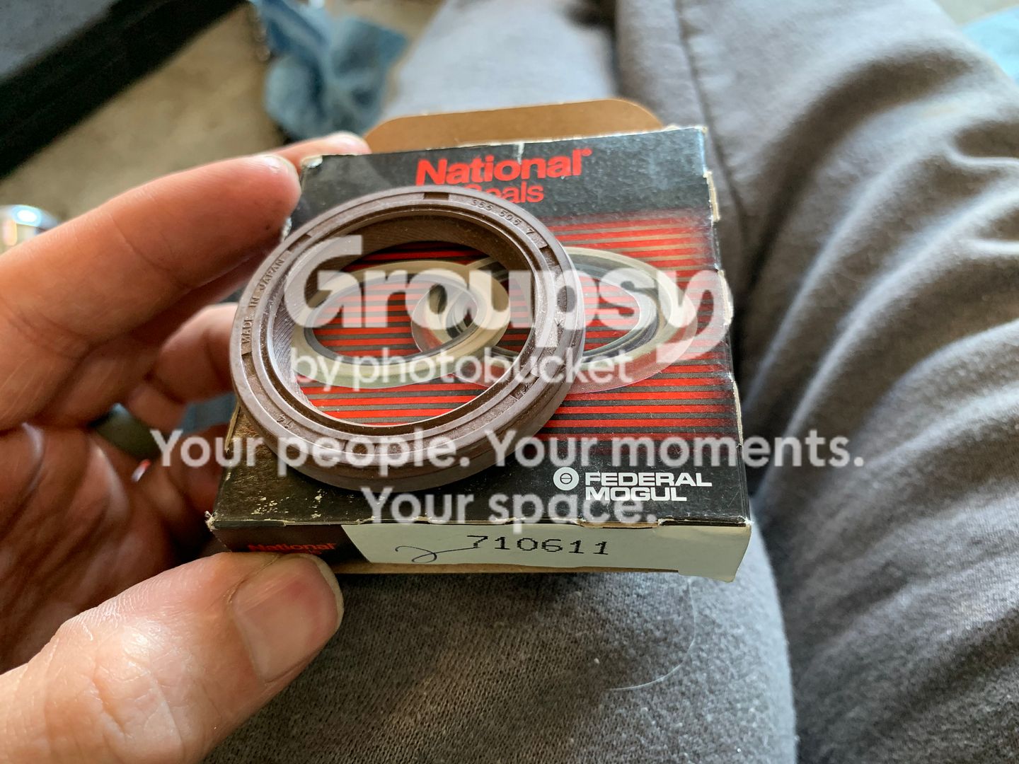

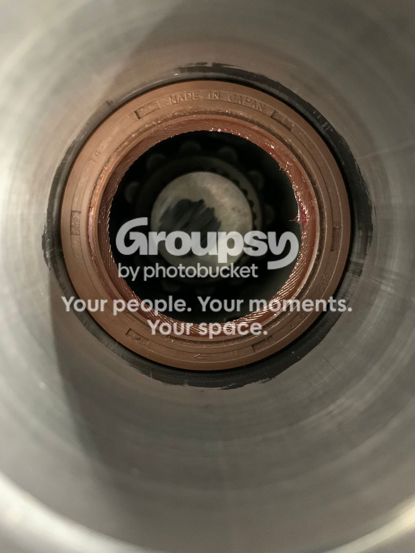

I also tried a mod last week for the adapter plate. I added a seal inside the extension tube for the transmission output shaft. This should seal the transmission and add redundancy for the seal Marlin provides. It also helps with aligning the cases during assembly without damaging the seal at the end of the extension tube by keeping the coupler aligned and in place. The seal is National part # 710611. It was a press fit in one of the extension tubes, but a slip fit in another. So I added some RTV to ensure it seals properly and stays in place.
Add RTV to the inside of the splined coupler on the transmission side. This will seal the inside of the coupler.

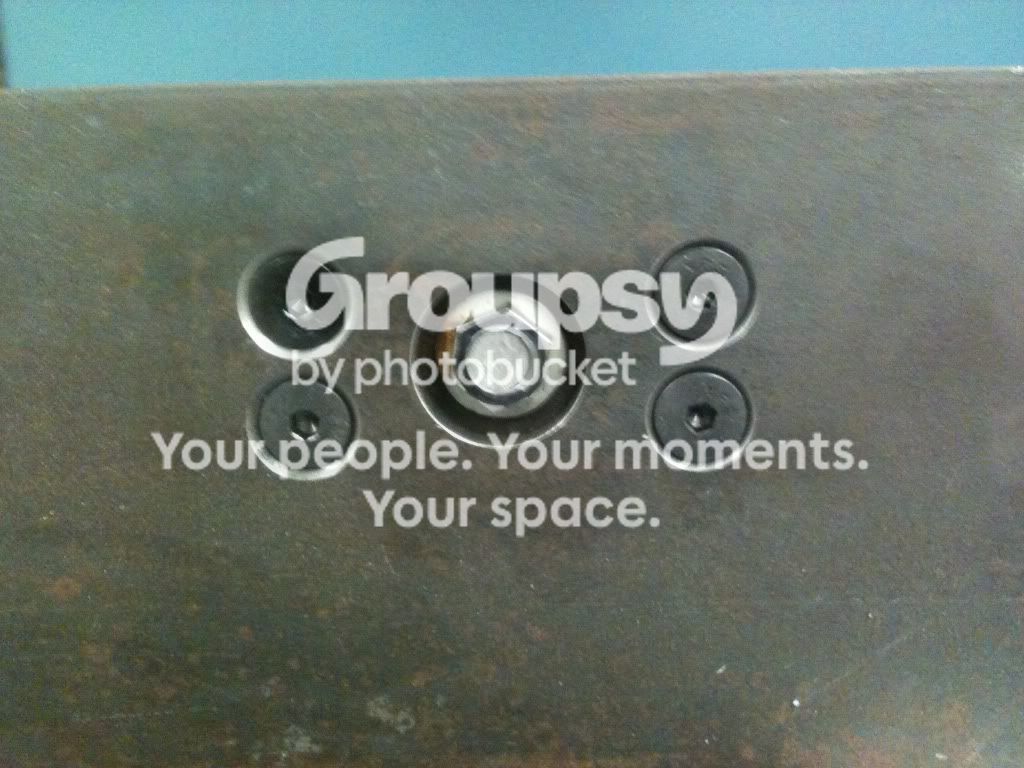

[MENTION=28464]eimkeith[/MENTION], here are some pics of measurements from my TacoBox
wait - [MENTION=91393]papabeach[/MENTION] did we miss a section?
Sent from my iPhone using Tapatalk Pro
Not sure I understand your comment? I have not installed yet if that is what you mean...piecing a few more things together...hopefully soon.
It looks like you missed one section when measuring - the reduction box side of the clockable adapter?

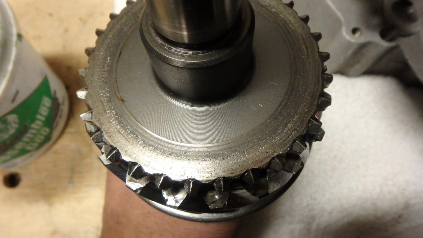

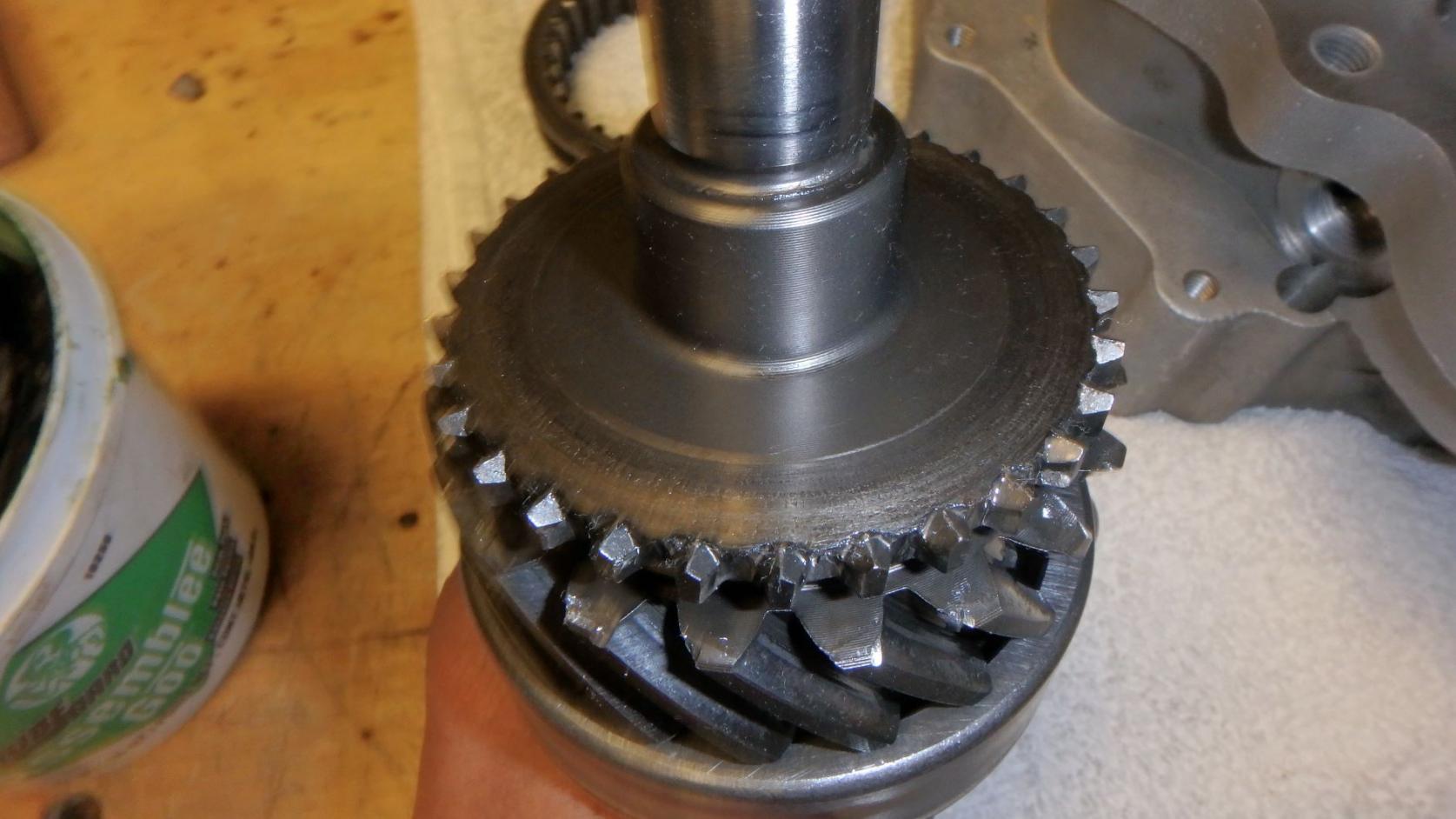

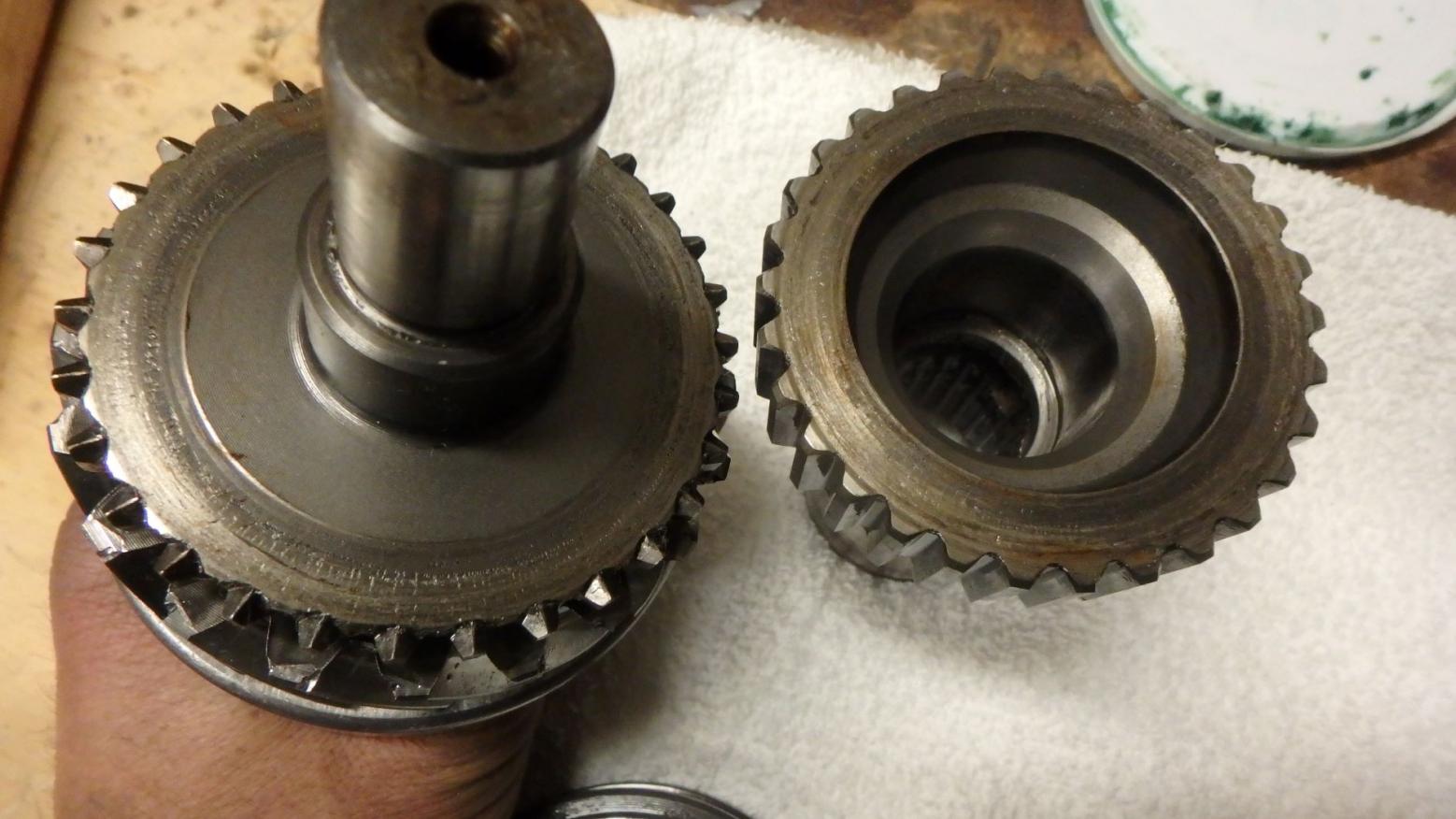

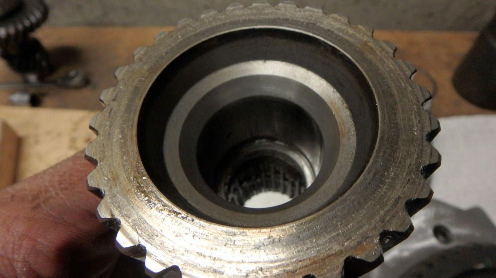

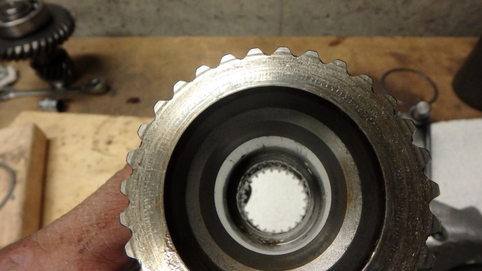

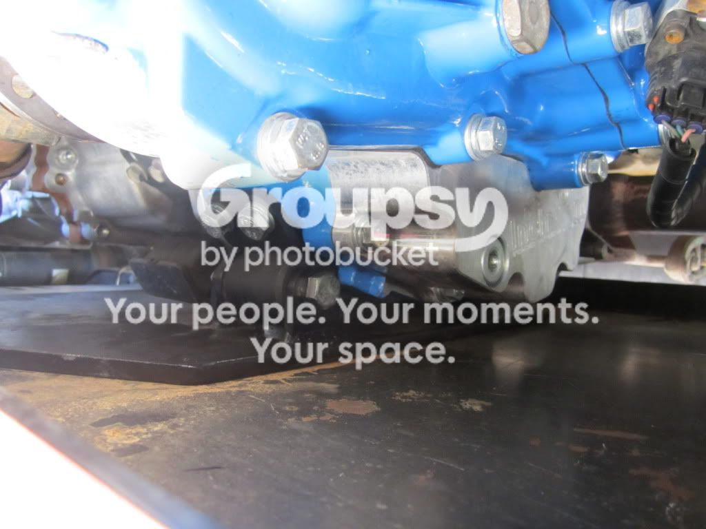

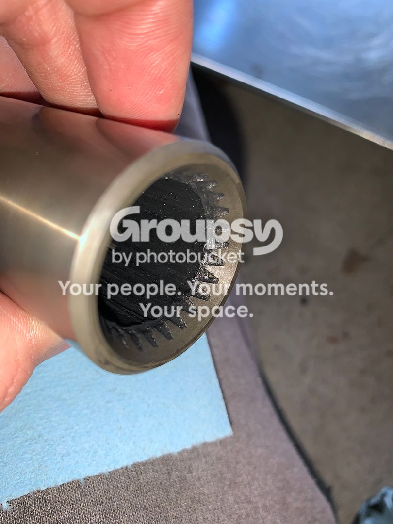

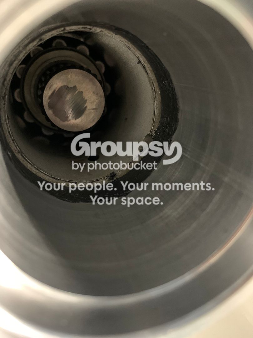

Any one running the trailgear dual case opened there unit up and inspected everything after using it a bit?

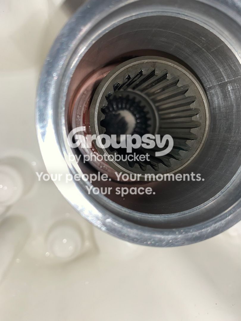

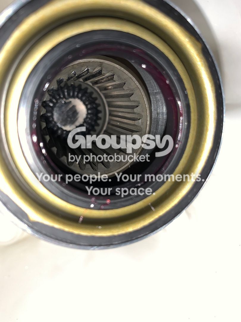

Last time i post about my TG case, I had gotten it back from TG, the popping out of gear issue had been resolved. After getting it back from TG my unit was leaking oil (I made sure to always keep it topped off) but i didn't want to have to pull it again right after just installing said, I waited until I had some other maintains to get done. I just pulled my TG case, found a 1/3" spot with no sealant, since i had to pull the case apart to reseal i went ahead and inspected the internals. My invoice said TG installed some type of shim kit while i was told the couple looked suspicious and was replaced... so while inspecting i found (the unit it's self was/is still working)
My thought is what every TG did to tighten the case tolerances to keep the unit from popping out of gear closed/tightened things to much...
So the reason I asked if anyone else has open and inspected there's is to c if anyone that didn't have a popping issue and the repair done is having the same wear or not, to help isolate the cause. From the 1st time i drove with the TG case installed (before the popping issue was repaired) there has always been a growling noise coming from the unit (this persisted after the repair as well), wondering if this could be the cause of the noise...
