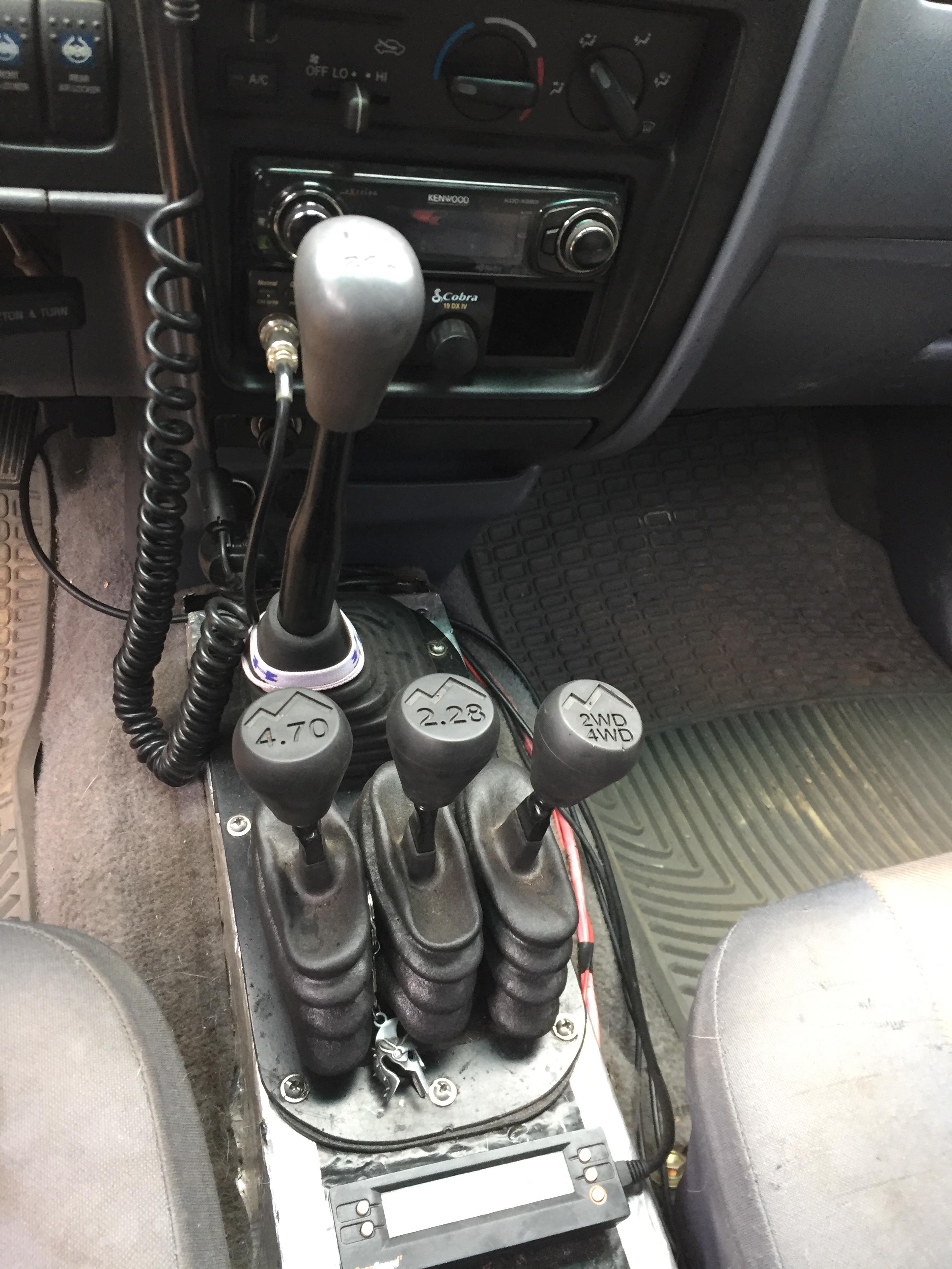

I can't speak from hands on experience, but from an engineering perspective -- the RADesigns triple shifters appear to decrease the travel of the shifters attached to the rear case due to the way the linkages are positioned. This also means, all else being equal, the force needed to shift is increased by the same scale, my guess is ~1.5x, or a 50% increase in force. See my drawing below.
Or that's just a trick of the camera. Closer objects appear bigger and all that. Compare pivot bolt head dimensions for reference.

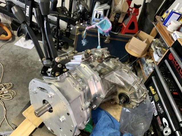

I picked up a donor TC to pair w/the MC Tacobox. Question, Is there anything I could/should rebuild on this TC prior to mating and install? Anybody wish they cracked/re-sealed their stock T-Case all to find out later it started leaking? The T4R member I purchased it from said it came from a 1999 w/ ~190K. Everything shifted fine prior to removal. When he split it from the Transmission there were no signs of leaking. I am hopeful/guessing that the oil stains on the outside are simply from seepage during shipping. Also, for those of you with the Inchworm adapters…did you clock at all? Should I just install as is and see how it goes? I do have a 1” BL and it is a 5spd. Anything I should be considering as I start putting things together?
It will never hurt to reseal while you have it removed, especially buying it used and not being positive of the history. The chain cases are pretty straight forward for disassembly/reassembly. Is it required, no, but extra piece of mind if you have the time. You'll want to get a new pinion nut if you open it up though.
Which Inchworm adapter do you have? I've run multiple in a few different clocked settings. Pretty much comes down to what your goals are. One of my goals was a flat belly, so I had to clock the case.

Thanks for the thoughts on the TC. Wasn't tracking the need for a new pinion nut so thank you.
Not sure what to say about the adapter except it is the adapter that Marlin shipped out a few months back with their Tacobox builds...hopefully the pic is helpful. My g\oals are to just get it in and get going with as few mods as possible right now. A tummy tuck, SAS, etc may be part of the next generation of mods for this truck...but not now. It seems like every decade or so of ownership has seen some significant changes...

Sorry for slow reply. If you decide to use Rad designs triple sticks (which I highly recommend), you will need to disassemble the stock case and grind the 'nub' off the shift fork. At that time you could inspect everything and install new seals.
I have inchworm adapter and I did not clock it.

Getting closer...dry fit complete, time to take apart and seal it up... getting excited! Quick question...looking for confirmation for shifting pattern. Center Stick Crawlbox is H-N-L; drivers side shifter is factory TC H-L; passenger side shifter is 2-4?

Glad the thread helped. I have used my access hole to add some nylon washers to the linkages to keep them from buzzing at certain RPMs. Much easier than trying to access from underneath.
