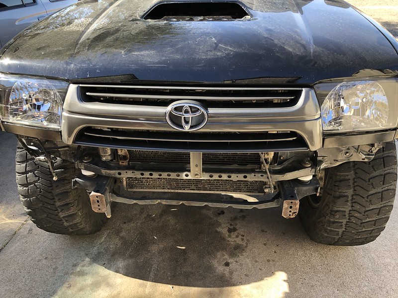

Not a huge update but a needed one. For almost the last year I have been without a front grill. like a dummy I had my 1 ton roll back into Smokey breaking not only the grill but the tabs on the headlights that hold the grill on. So I finally ordered new headlights, corner lights and tail lights (might as well while I was at it), and a new grill.
Got the headlights and corner lights installed as well as the taillights. Got the grill painted a nice charcoal metallic which I think is a nice accent to the black.
98 Smokey by Sam Wright, on Flickr

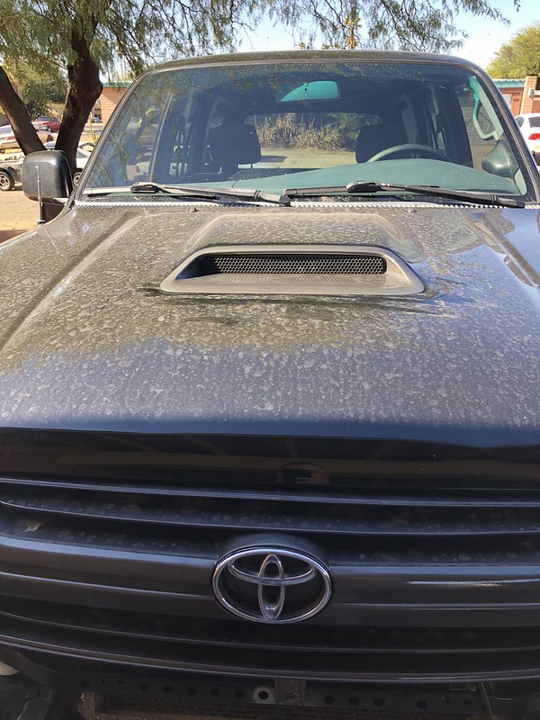

On another note I got the insert for the hood scoop painted. Then all that is really left if front and rear bumpers.
Hood scoop insert by Sam Wright, on Flickr
