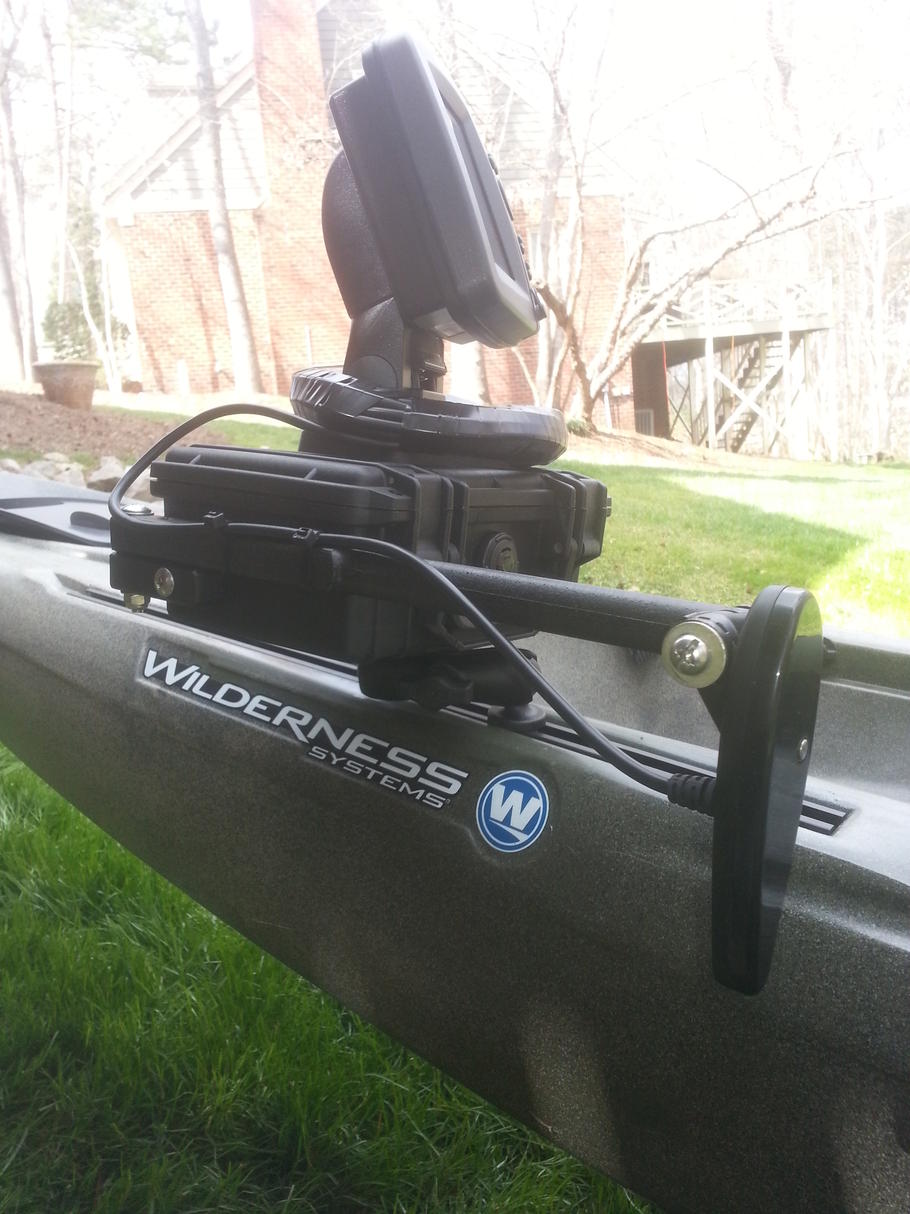

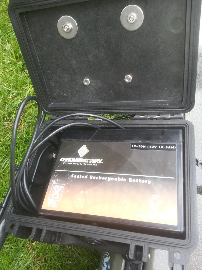

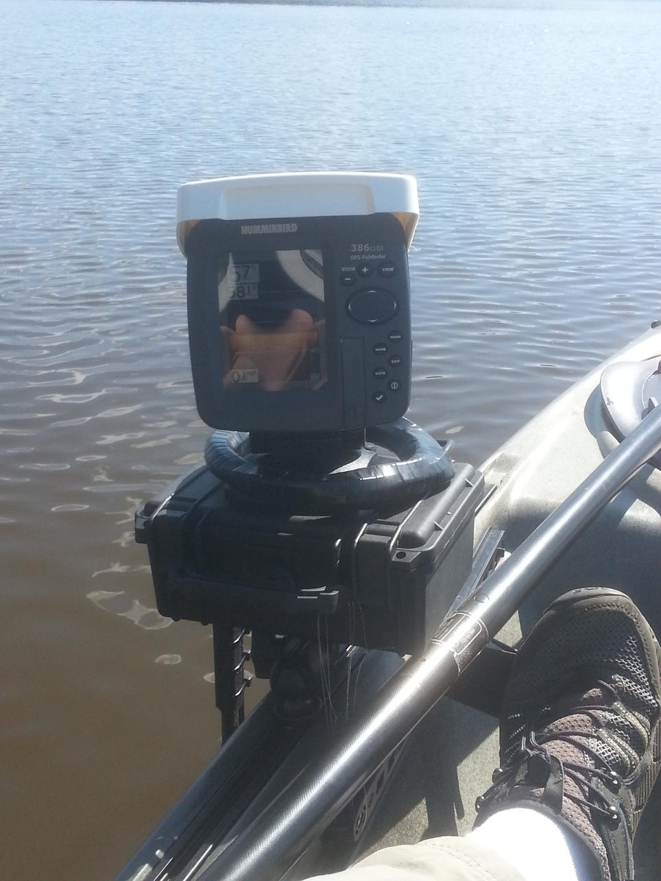

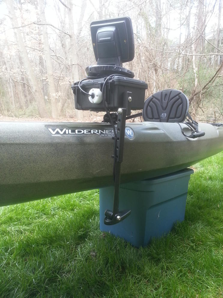

I like mine but you guys need to make something like what I jerry rigged together so that you can put the Fish Finder where you want it, take it off and on when you need it, and all self contained with battery and everything in a waterproof case.
I can just undo mine and pick it up all complete with finder/battery/transducer with a carry handle. Takes literally 10 seconds to completely set it up, or take it off.
This makes it so much easier to use a fish finder on a Kayak without drilling holes in it and messing up the hull by trying to install a transducer.
