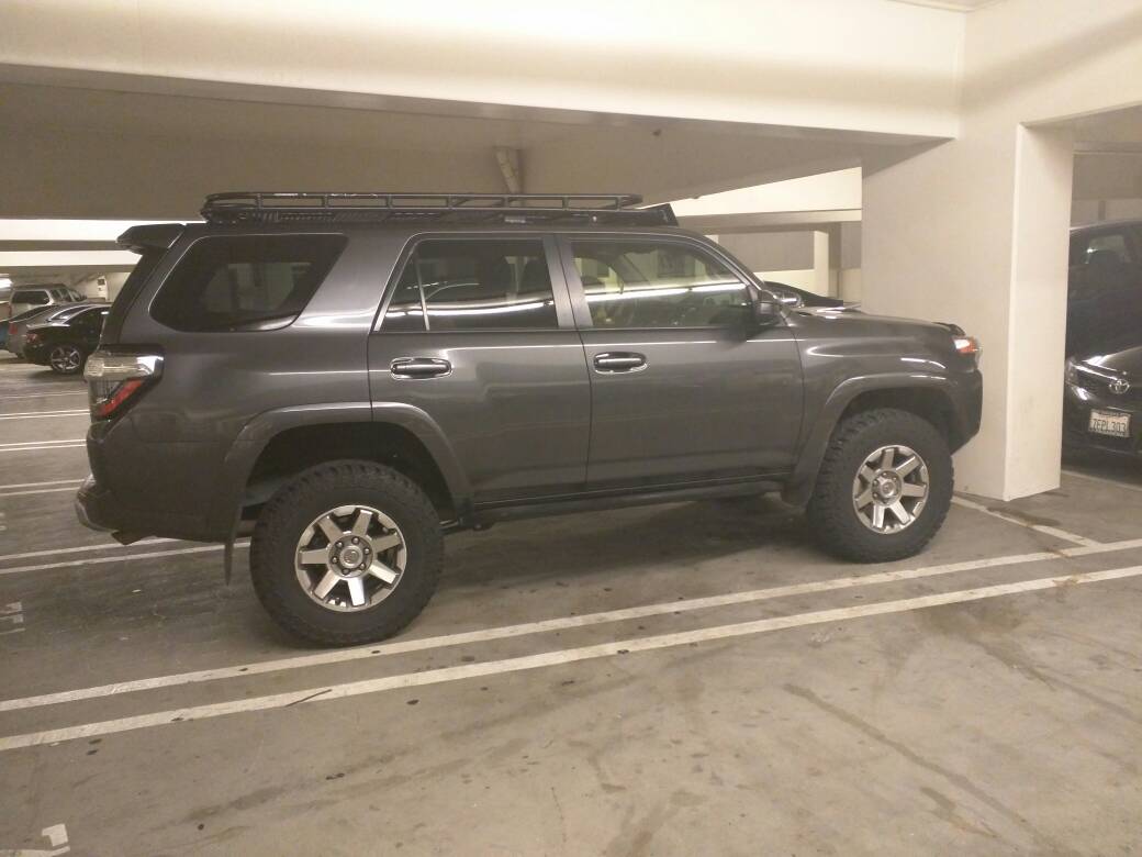

I just fitted 255/80 Coopers with Icon Stage 2. Initially rubbed to body mount on the passenger side. But a good alignment and Caster set to 4.1° (which with Icon Tubular UCAs it was easy to achieve) solved the issue. It does not rub anymore, and it steers and handles better than the stock setup. I didn't use any wheel spacer and I'm running TE stock 17x7.5 rim.
