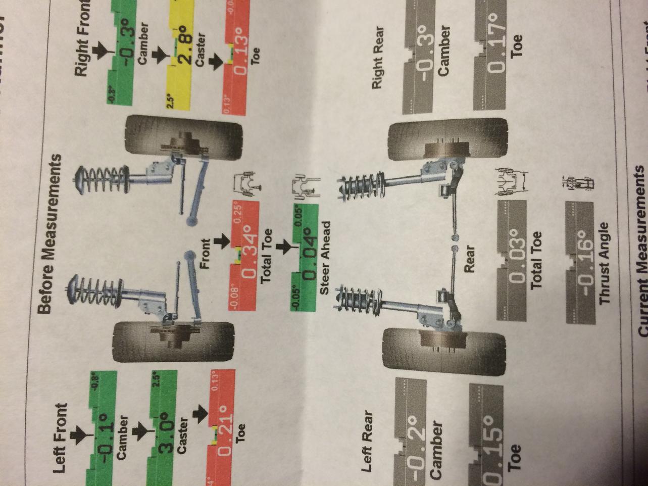

Here are the "before" alignment specs, sorry for the sideways pic

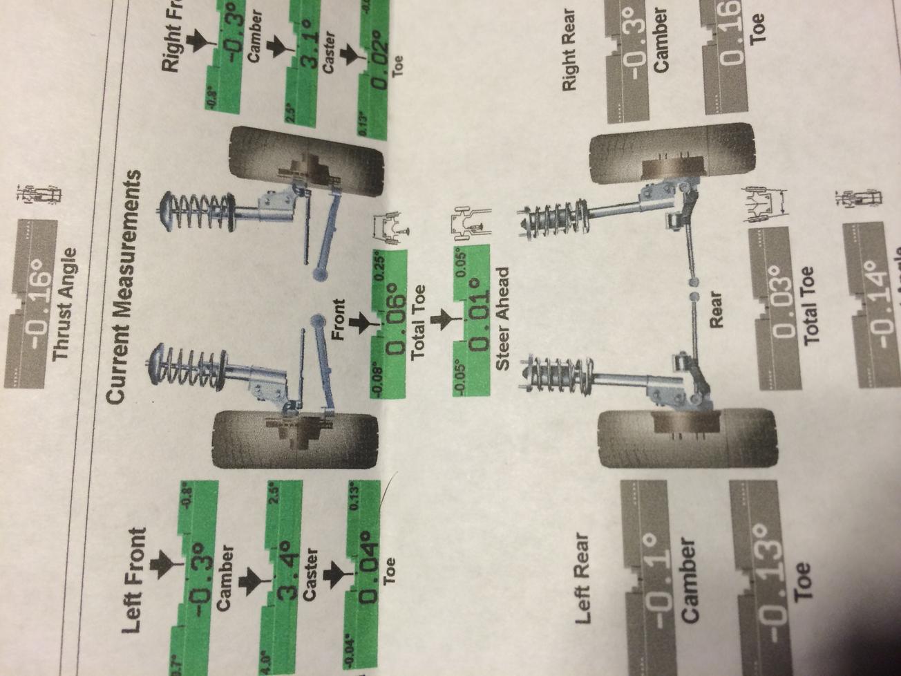

"After" alignment specs. I asked for max caster as suggested. The tech said this was the best he could do as the adjuster was seized due to corrosion(?) and he was afraid to break it.

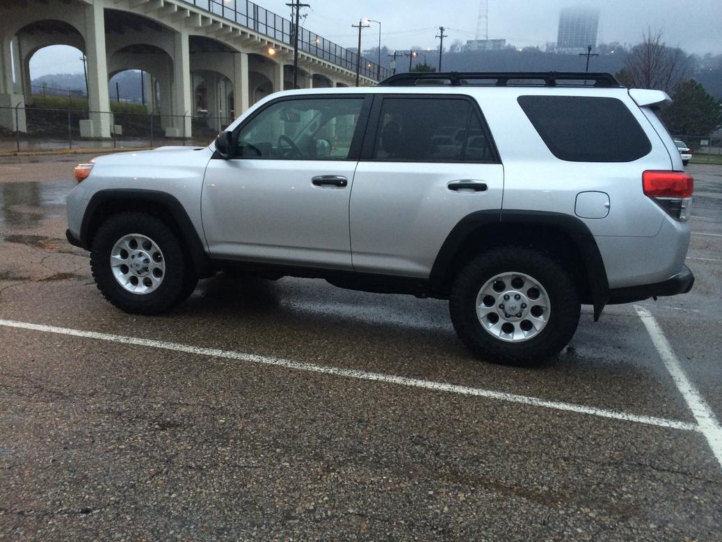

It's been pouring here for the last 12+ hours, but here's a daytime pic. Had the opportunity to drive in through very heavy rain and standing water at speeds from 35 to 65 mph and no indication of hydro planing. Did notice the tire music between roughly 50 to 60 mph seems to be more pronounced, but not annoying at all.

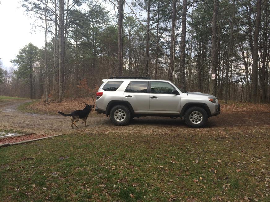

Just got back from a weekend of hiking with the family. Put another 500 or so miles on the new tires on highway and country roads and still loving them. As I side note, as others have mentioned I checked my speedo vs two different gps based ones and it seems to be spot on with the 285s :noidea:
