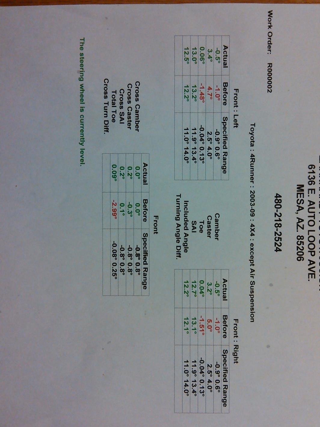

FWIW, One of the members here running these showed 5° positive caster on initial readings sitting on a 2.5" daystar lift.
is the picture he posted in the 4th gen thread

That's actually not bad other than the negative camber, ideally it should be closer to zero and err on the positive side, but I have set a few slightly negative with no adverse effects.( -.10 deg)
Unless you are off-roading a lot why would you want a positive camber on a "mostly" street driven truck? In honestly I prefer a negative for a safer turning radius, especially on a raised truck. This is a honest question on to why you would err on the positive side.
Mostly due to tire wear characteristics, I have expirenced the best tire wear and handling at the specs ive stated in numerous threads. There will always be people that disagree for what ever reason and there are always people that have different results. Unless your running more toe in than factory I wouldn't run that much camber as it could cause accelerated tire wear on the inside edge. whether it does or doesn't if im aligning a customers truck I want to KNOW its not going to wear the tires adversely.
Well you can say the same about tire wear for a positive camber but on the outside wall. I do agree for a daily driven vehicle that the best camber would have it at 0, but I usually err to the negative for safety reasons knowing I'm less likely to flip the truck if anything ever happens and I need to make a quick maneuver.

So the purpose of negative camber and the argument behind it would be to improve cornering and traction during a turn. When you travel through a turn, the geometry of your tire relative to the frame is changed. Durring the turn the tires actually gain positive camber (when set to zero initially, you can see this for yourself by going out to your driveway turn your steering wheel all the way to one side and note which direction your tires are leaning. leaning away from the vehicle at the top is positive camber, leaning in is negative)
So if you put a -.5° to -1.5° (application varies) of camber into the alignment, and go through the same turn, the positive camber gained thus counter acts the negative camber set by the alignment creating a flat contact patch across the total tread width of the tire, while the car is in the turn and needs the most horizontal traction.
So for racing purposes the reasons for negative camber are obvious. However for street purposes, the argument is that tire wear is greater going through turns on the road than it is traveling in a straight line, thus adding a slight amount of negative camber will in turn improve the lifespan of the tire.
I think the results would depend on if your daily drive is full of twists and turns verses a few miles of straight roads.
Actually With positive camber you can set the toe closer to zero. this will result in a much more neutral feeling. Also with as stiff as the truck suspensions are most of the "contact patch transfer" is done by the sidewall of the tires. which is why you want a more neutral position on the tires.
I don't believe camber has anything to do with body roll in a roll over situation..
pretty sure thats involved with speed and your center of gravity..
Very well put, lol I cant shoot any holes in this post. However, camber alone doesn't wear tires. My bmw( see below) had -3 degrees of camber in the rear with super stretched tires. I had no adverse tire wear. But It took me 3-4 alignments to get it to that point.
