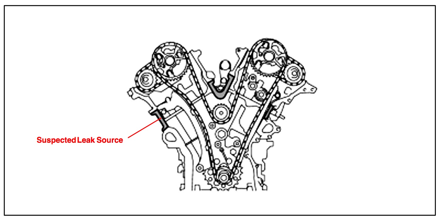

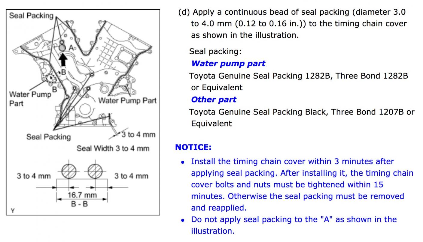

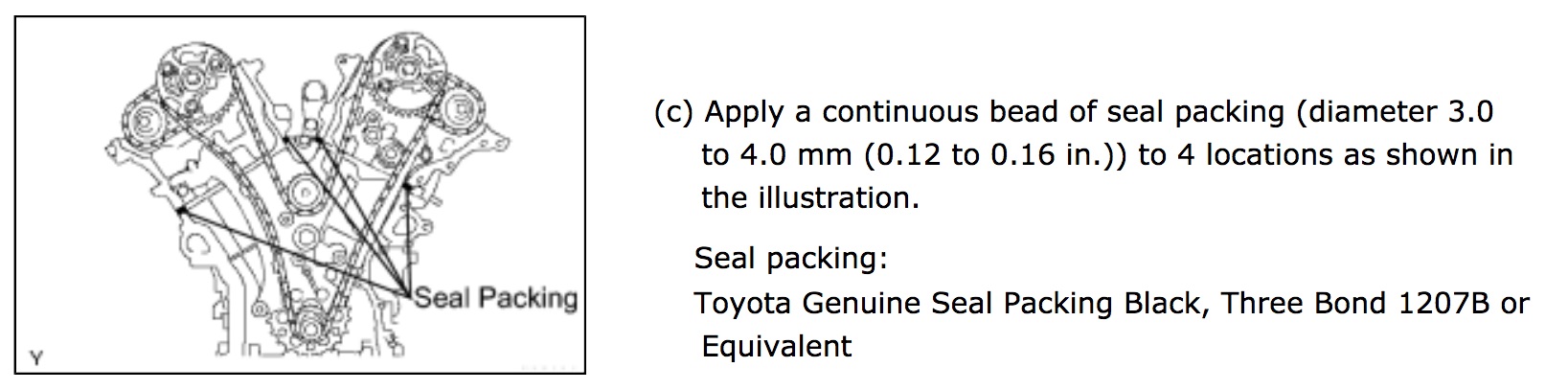

When you're applying the two FIPGs, pay particular attention to the leakage bulletin pic below and apply it on both sides as shown in the other two pics from the shop manual.
NOTE: also add a thick bead across the bottom of the timing cover where it meets the oil pan. I ran two 4mm beads, running forward of the oil pump pickup tube (not aft of the o-ring which seemed to risk dragging FIPG into the pickup tube).

Thanks - yeah there are two depressions on that side of the timing cover. Stupid manufacturing flaw. Will make sure it's thicker there.

Your note with the oil pan... this is partly why I am redoing the job. I originally applied the RTV (now to be FIPG) on the oil pan itself. After sealing it up, I realised the O ring likely dragged over that. So this time I'm definitely doing the FIPG on the base of the timing cover. I don't entirely get your forward/aft comment though. If I just apply two beads along the base of the cover (one in front of bolt holes and one behind them?) then this will do what I need, right? Should I drop it to one 4mm bead around the oil pickup tube to avoid squeezing any into that? Or I guess once the O ring has made contact, it can squeeze wherever it wants right?

By applying FIPG to the timing cover, forward of the o-ring, you reduce risk of the FIPG being dragged into the oil pump pickup tube while you're sliding the timing cover into place, possibly lodging in the oil pump pressure relief valve.
I wrote up in my notes that I tilted the cover into place...started by sliding the base of the cover onto the oil pump crank drive gear with the top slightly tilted away from the engine, holding it off the oil pan until it was on the crank drive gear. Then I tilted the cover onto the engine while lowering it onto the oil pan. I practiced this quite a few times without the o-rings and FIPG until I got it down smoothly.
I also applied a light film of motor oil to the pickup o-ring so it would slide that last little bit into place while I was tilting the timing cover into place. The o-ring was glued into the groove with Permatex aviation sealant (like liquid carmel sauce texture) and fully cured, it wasn't going to come out of place without a major fight.
edit: all the timing cover bolts were installed loosely, and I torqued the four lower bolts to the oil pan first to ensure compression of the pickup o-ring. Then I torqued the front bolts in 3 torque steps from the center outward in a figure-8 outward e.g. 8 Nm, then 16 Nm, then final torque of 24 Nm (going from memory here but you get the idea...nice linear tightening).

The FIPG instructions say to torque all bolts up within 15 minutes. I get why you did 3 torque steps but that will be pushing my ability to tighten everything that quickly :) Getting those bottom bolts properly done in that awkward position will be a good 4-5 minutes alone. And only 3 minutes from application to pressed up against the block... gonna need to have my wits about me for this one.
My 1/4" drive torque wrench and a standard depth socket gave no problems with the lower timing cover bolts, plenty of room to work. Start from the middle and work your way outward in a figure 8, like valve cover torque sequence.
I did the 3 steps not wasting any time but not rushing. No leaks.
And don't forget the water pump big bolts are part of the timing cover surface, they thread into the engine just like the rest of the bolts. Get the main cover bolts on and torqued, then quickly install the water pump to get all the FIPG compressed and curing uniformly.
Also...apply a bead of FIPG at the oil pan corners where it meets with the engine block and timing cover. This is a GM LS engine trick and it worked well for me on the Toyota timing cover as well.
