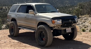

285/75/17 with no body lift just 3” lift suspension wise. Currently 2wd with 3.73 gear ratio. A little sluggish going up hills but other than that it drives pretty solid. Only modified part I had to do myself is smash in the pinch welds to an extent and primer to avoid rust. No front bumper atm but also allows full lock on turns and whatnot. No rubbing issues whatsoever.
