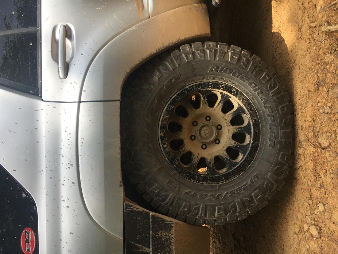

I have 285/75r17 nitto ridge grapplers with no body lift, total chaos UCAs, demello front bumper, cbi rear bumper. I only rub on the front body mounts when flexing it out and turning a certain direction. here is a pic of the rear stuffed
If you have any questions feel free to ask.
