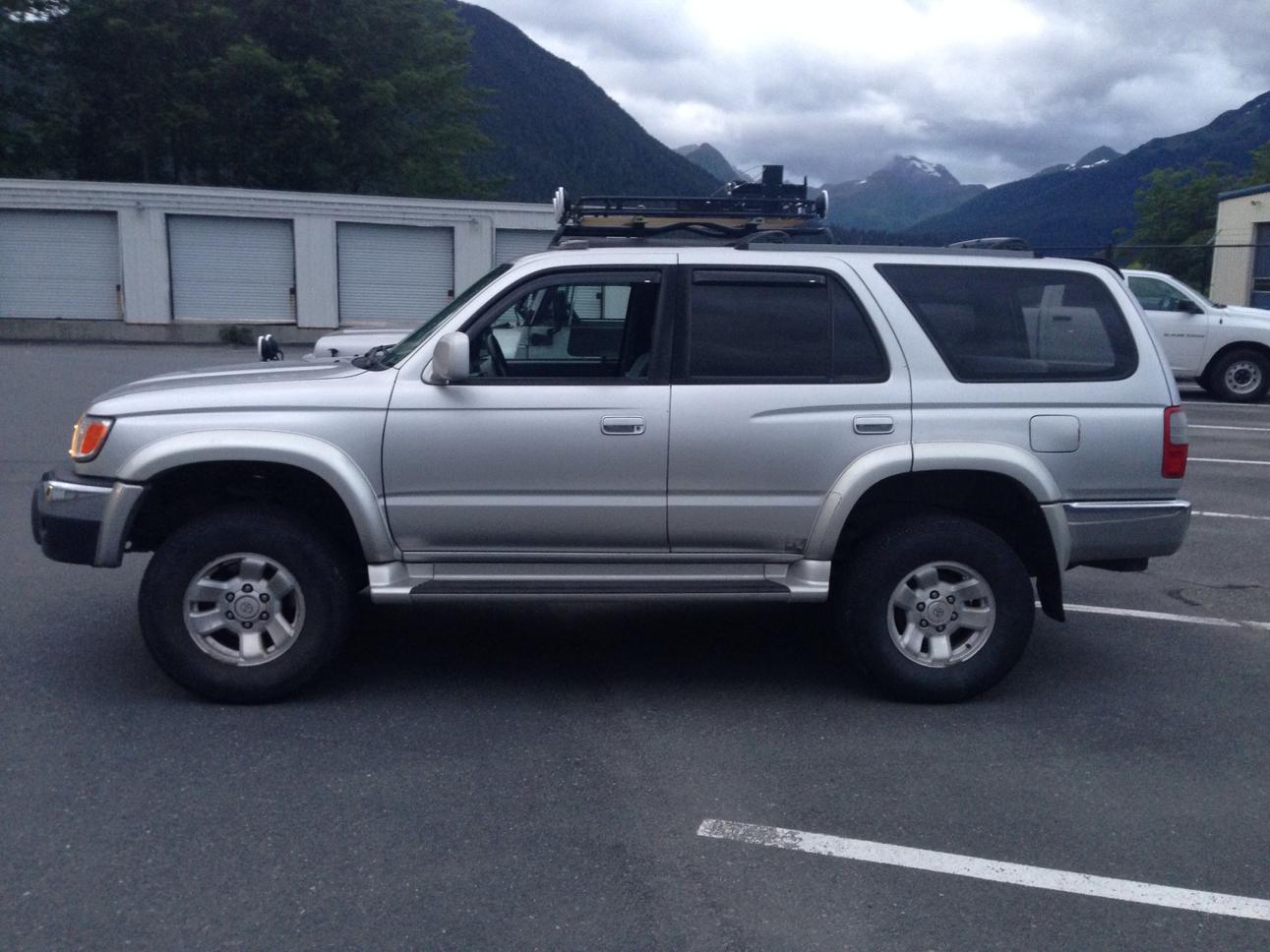

So i just installed my ome lift and love it. I went 3" all around and now need to figure out what tires fit. I was thinking a 265/75-16 but not sure. I want to go big but whats the biggest that will fit. Thanks all.
A few pictures of the lift. It came out awesome

I think you may want to go a little bigger on a 3" lift - 32" or 33" would be more appropriate IMO. Post some pics when you get them on.

I think 285/75r16s or 305/70r16s look the best. The 305s are the same height as the 285s just a smudge wider. I ran 285s on my 3" lift. I did have to use a 1" wheel spacers because they rubbed the upper control arm. IMHO 265s are to small. I ran 265s with no lift.

Can confirm I have 265 75 R16 on my 2000 with dead suspension, rears are setting on bump stops. (Waiting on a green light for a SS 1.2) front is almost as dead but still has a little travel. No rubbing during normal driving or flat turns either direction even with steering wheel "locked" to each side. Very slight rubbing (like for a second, kinda just a touch and go) when making hard right turns onto a ramp or up a curb.
With a 3inch lift a 265 75 r16 will be too small. Go 285 75 r16. I plan on upgradeing to 285's with my SS 1.2 Kit installed.

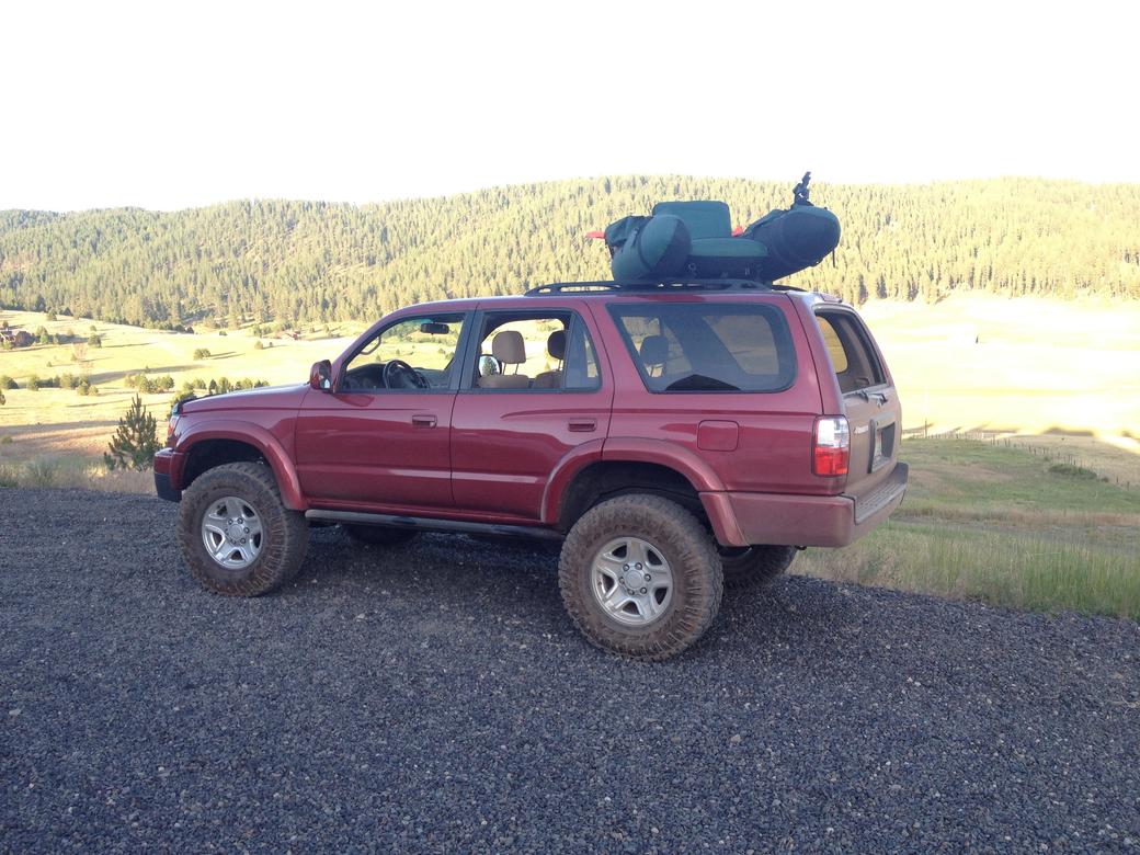

I had 265/75/16 with the factory suspension. When I upgraded my suspension to a 3in lift the 265's looked to small. I now have 285/75/16 and love them. I have aftermarket upper control arms and no rubbing. The factory control arms will not work with my setup. These tires will rub the factory UCA with out wheel spacers.

How much driving do you do? If you do a lot, I recommend going with the 265/75-16's. Will they look small? I personally don't think so if you go with the right wheel and tire combo.
