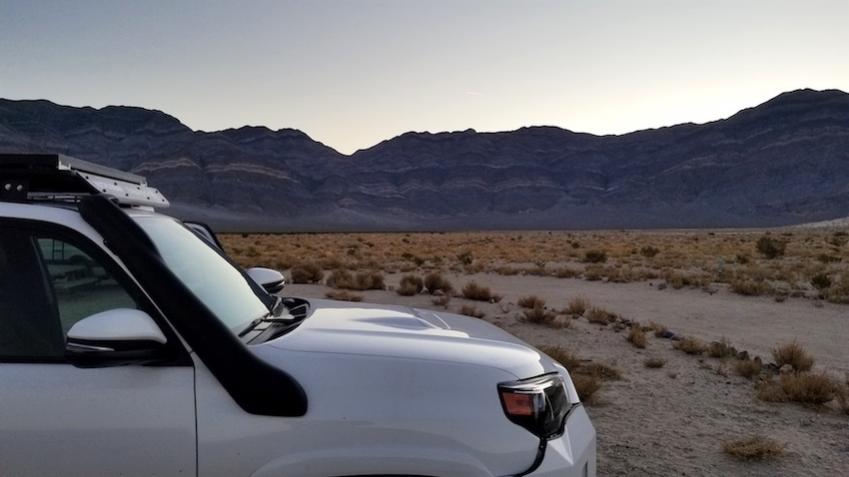

I love it. It fits like a glove and looks clean. I do a lot of desert driving and it keeps my air filter clean. I never found any water in my airbox, but I do find a lot of bugs, butterflies and dragon flies.
Did you completely seal your airbox ??? I mean you sealed up the water drainage holes in the bottom of the air box ???
No, I'm sure water comes in from rain and splash, so I left the drains. I think you would have to linger in the high water for way longer than I would be comfortable with for the drains to be an issue.

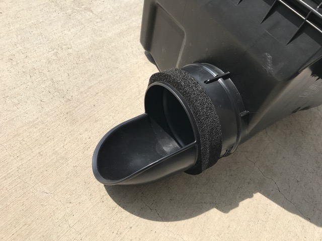

The connector tube that runs along the inside of the fender joins with the stock air-box. If you never have removed the air-box, it has a tongue that sticks out at the bottom of the tube that goes thru the fender and as far as I can tell this helps keep the water out of the air-box. When I first got the snorkel I was freaked out about the water thing, but like I said the air-box stays dry.
