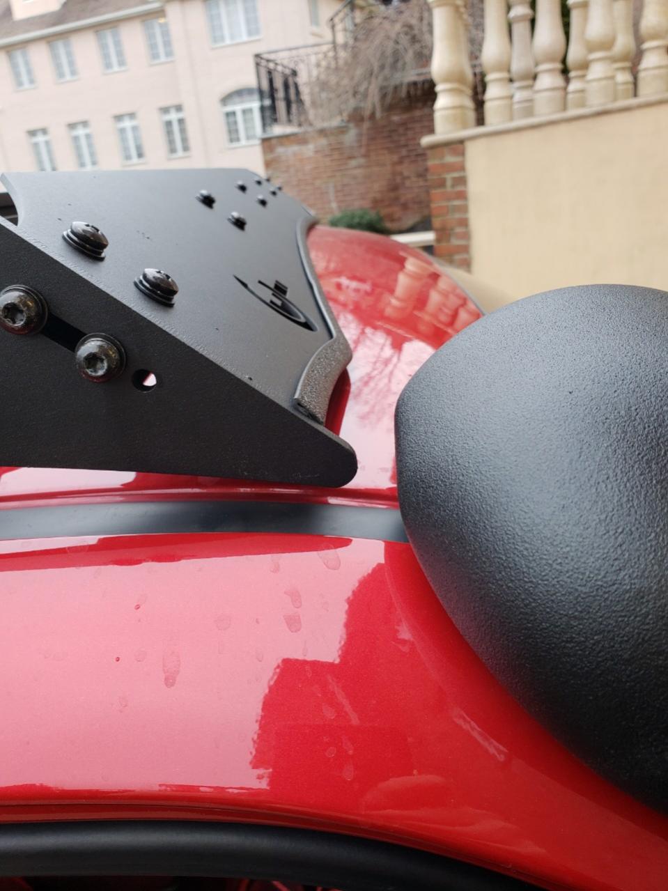

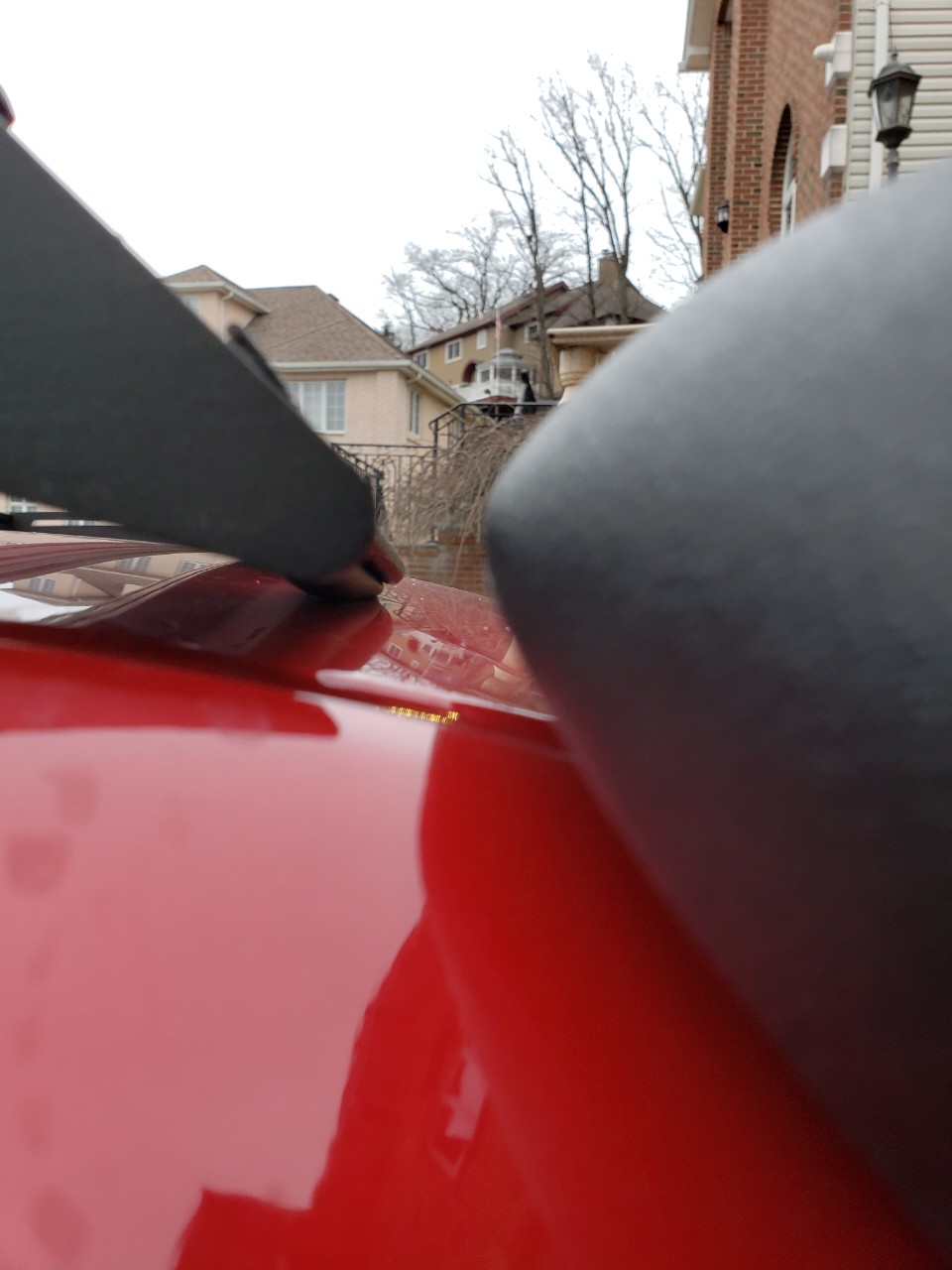

Prinsu rack clearance

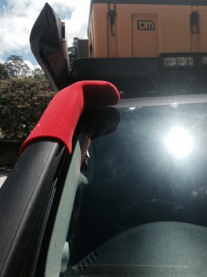

I got this from Uni Filter Australia for my TJM snorkel. It's not for day to day use, but in a heavy dust/snow condition you just slip it on. I wish they had a black version like they offer with all of the other pre filters, but like I said its not for day to day driving so...
4x4 Pre-Cleaners
