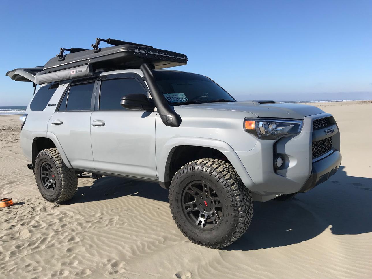

Install update, (this is my 3rd snorkel install, one on 3rd gen runner and one on 2nd gen xterra). This is by far the worse! Do yourself a favor and just buy all the clips from toyota that hold the fender flare on (and hope you don't break too many tabs off the flare itself). Also, might as well order the fender liner clips too. To make matter even more interesting the paper template does not line up at all. If you line it up with the door and A pillar you should be OK. Otherwise, the fit is good and the mounting is pretty easy.
Looks OK........

Why did you pull off the fender flare? I’ve done several of these and the arb’s and the TJM is far easier than the arb to install. The square fender liner clips can be tricky for someone doing it for the first time but as I’ve had much experience with those clips, I’ve found angled pick tools work well to push the two side clips in. As for the paper template, maybe it isn’t clear but if you line it up with the body line in the top of the fender near the a-pillar and the door/fender line you’re good to go. I’d be happy to help with install help if folks need it. Just email me at [email protected]
You know.... I should have applied some critical independent thinking vs just blindly following directions b/c I think you are right.... the flare does NOT need to come off! FML. But ya, the snorkel itself, the mating of the two tubes, and putting the nuts on the studs are not as bad as others. Still give yourself 4hrs.
