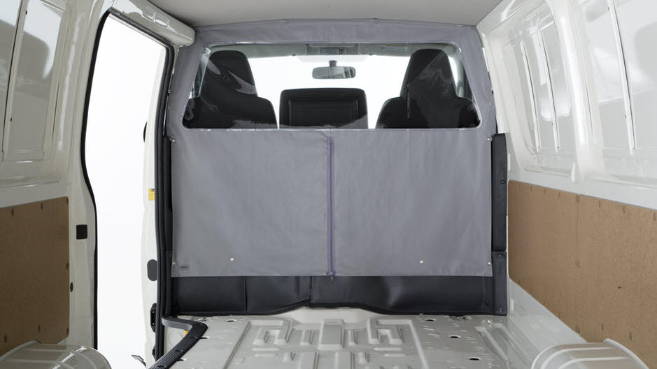

My second plan to improve the AC.
Toyota vans such as "Hiace" has a plastic transparent sheet right behind the drivers seat to keep the drivers cabin small to cool it faster (see image). http://www.toyota.com.au/hiace/accessories
I am working on the same idea but to go behind the rear seats. Why we need to cool the cargo area anyways?

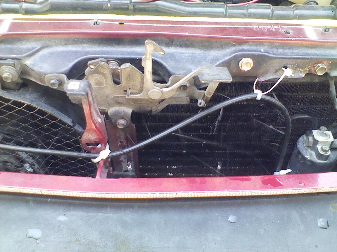

I pierced a washer fluid hose (black hose) in every 1/2 inch and mounted it in front of the condenser. Now, waiting for the sun....

Results:
Left the car out in the sun at 93 F for 2 hours. Started up and turned on AC. After 2 minutes the high pressure aluminum line at the firewall was basically untouchable!. AC blows cold
Pumped water onto the AC condenser (see picture) for about 10 seconds. Then touched the same high pressure line and it was barely warm. Went inside the car and the AC was very cold. Also noticed the compressor clutch comes on and off frequently as opposed to continuous run during this hot weather at the first 8 minutes or so.

Yes that big fan do it's job on normal continuous driving. I am trying to cool the cabin ASAP right after pulling out from an uncovered parking lot.
Now to work on the curtain. Thanks for the iformation guys.
Results:
