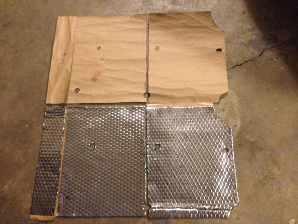

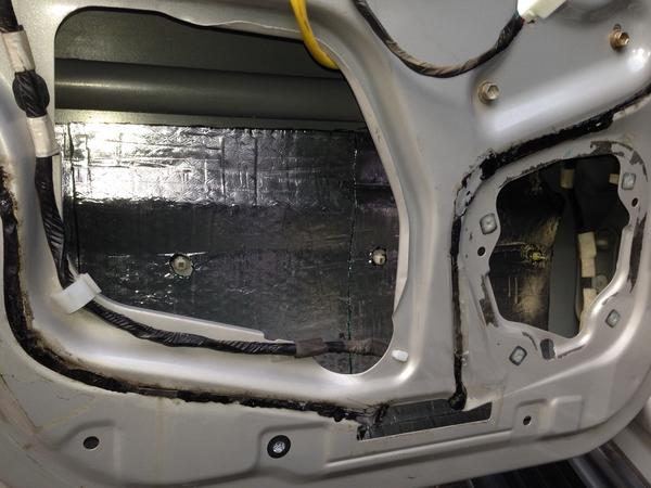

I probably spent an hour just cleaning a rear door, getting it prep'd for the butyl sound-deadening material. I still need to remove the factory adhesive that was used to attach the vapor barrier....
I created a template to help in cutting the sound-deadening material. Should work well...

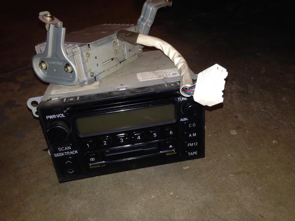

I also got the factory stereo and amp out:

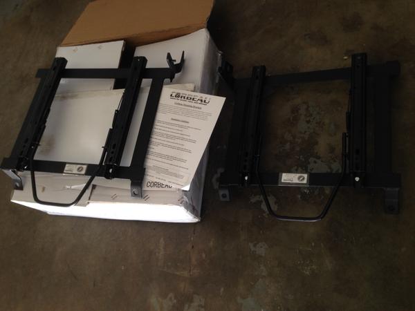

The Corbeau seat brackets/sliders arrived. They look to be well-constructed. Really tempted to mount the seats, but I want to finish-up the install of the speakers first…
I can confirm about a 20 pound weight-savings as these brackets with double-locking sliders are about 11 lbs ea. Each Corbeau Moab seat with this base is a little below 40 pounds, compared to stock at 50...

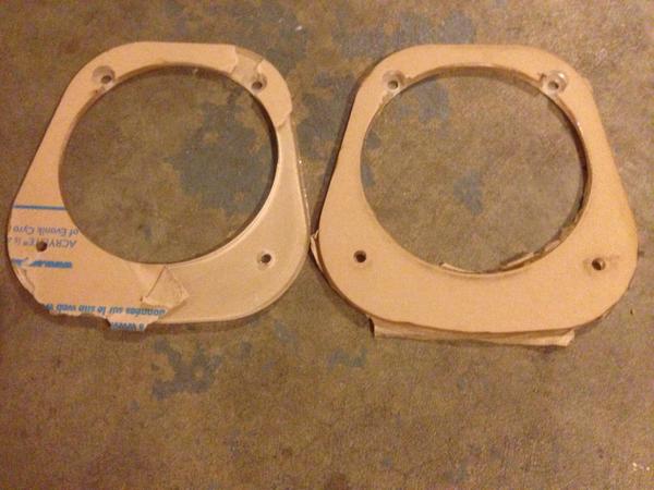

Also arriving yesterday, courtesy of [MENTION=175725]2ndhandyotaman[/MENTION], adaptors to mount 6 ½” speakers in the rear doors. These are ¼” acrylic.

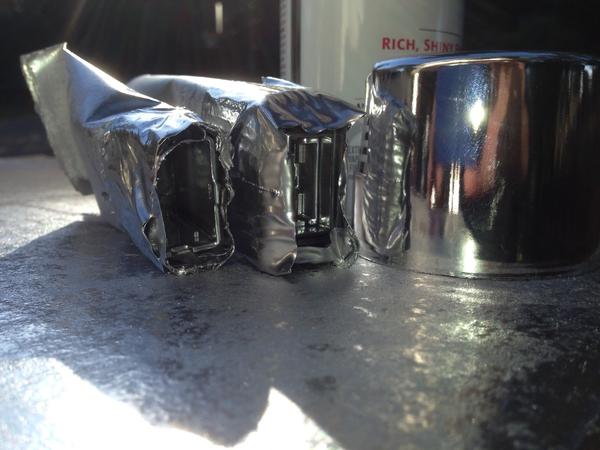

Below is the hazard switch with the button separated. The NEO 3 LED bulb was not lighting it up well. Actually, I initially thought it wasn’t working. The bulb is aimed perpendicular to the button, which does't help and the bulb itself doesn't emit light on the sides all that much. I had some very reflective, mirror-like chrome spray paint from another project. Thanks to [MENTION=84588]redstar[/MENTION], from another thread, the paint made a notable difference.
I have a couple green NEO 3 LED bulbs arriving tomorrow for the rear defrost, ECT and rear window control locations.

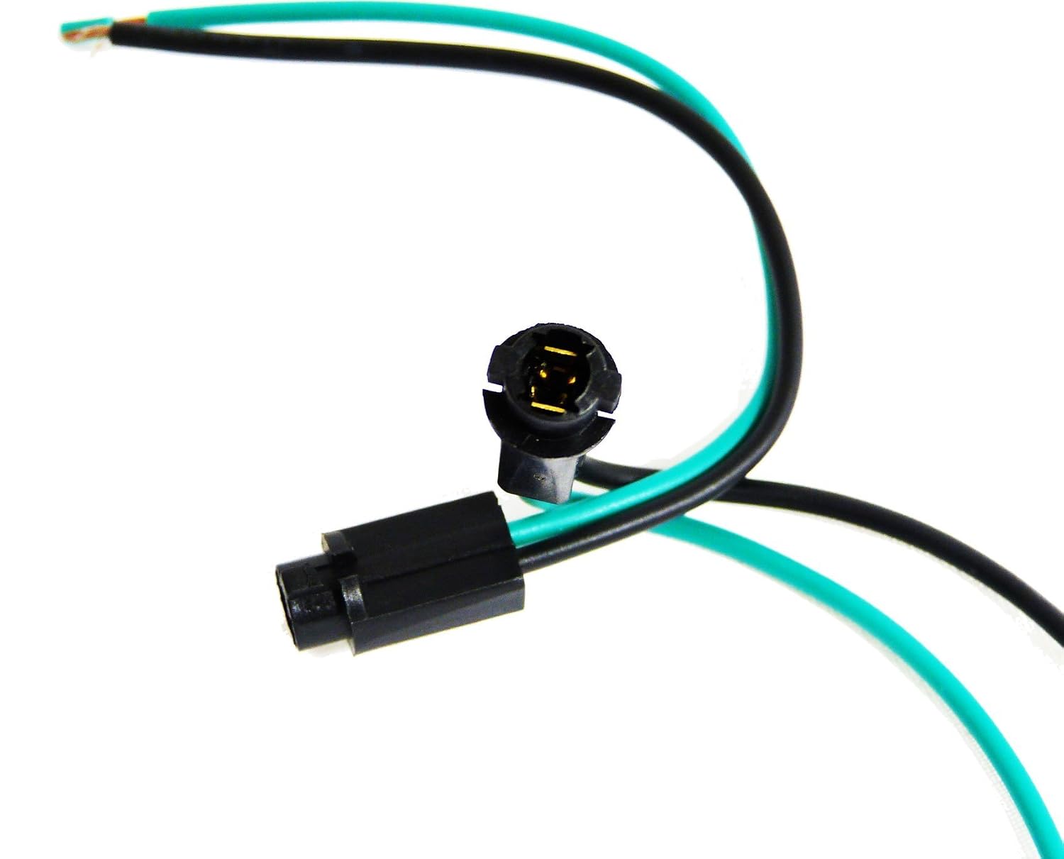

That bulb for the cigarette lighter appears to be non-replaceable. I’m planning to do it what I did to the ashtray light. Since I have additional green 74 LED bulbs, I’ll snip-off the light and add this:
https://smile.amazon.com/gp/product/B00CZGGXF8/ref=oh_aui_detailpage_o00_s00?ie=UTF8&psc=1
I believe this bulb can direct needed light to the cup holder area...

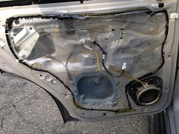

The exterior skin of the rear driver side door is half done. The stuff is going-on very well. It's just time-consuming. I will next create a template for the top portion of that door. I'm, hoping the template will allow me to go faster on the other rear door.
At this point, I'm leaning toward no or very little sound-deadening to the interior panel. My thinking... I can easily add such later, after the sound system is installed, affording me more time elsewhere.
