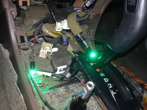

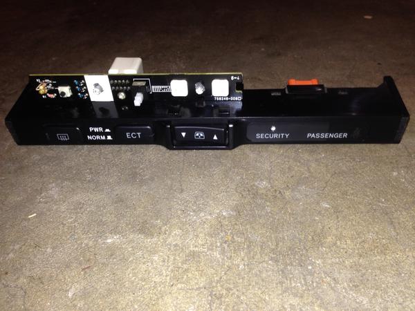

Installed a couple green LEDs today for the rear defrost/ECT and what looks to be the rear window control...

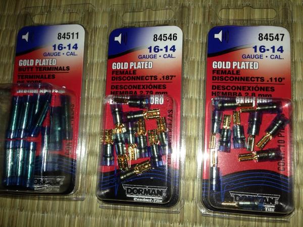

AutoZone had these:
They are the correct widths for the speaker + and - blades. Also, gold-plated butt connectors from the amp out to speaker wires...

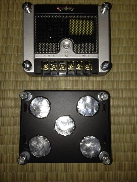

What I didn't find yet are the fork blade connectors for the cross-over. I might try a Best Buy or Fry's Electronics over the weekend. The standard tin-plated ones will just barely fit (tight) within the allotted space though.
On the backside of the cross-overs I added some remnant pieces of butyl that will keep the box off the inside of the door's sheetmetal. Hardware I picked-up at THD. I will locate these today in each door and start the speaker wire routing through the door conduits...

I was pleasantly surprised at what I found at AutoZone and O'Reilly's... Shouldn't be so hard to find some quality connectors for the x-over. No tunes until I figure something-out. Given that I don't want to open the door up again, ideally, I'd prefer to not have to replace stuff later...
I've filed and Dremeled such connectors before too. Yup, hoping to not do so here...

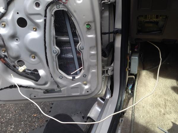

The white wire is a 12 gauge solid strand from a Romex. I should be good to pull the speaker wire through, hopefully.
Locating the dang crossover within the door cavity, finding a good location, not easy so far. I'll keep looking. The thought of running two speaker wires through the door has crossed-my-mind....

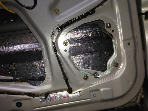

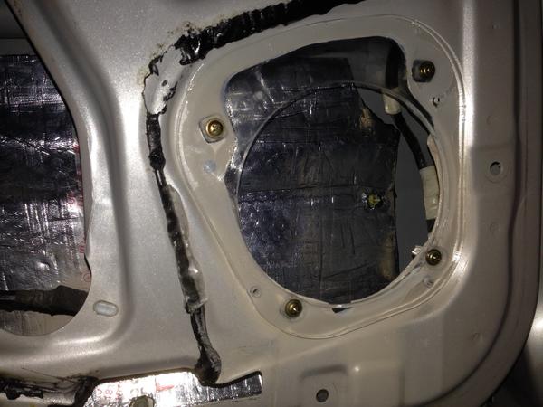

Got some work done on the rear speakers yesterday.
A dry fit of the adaptor for the 6.5" speakers, allowing me to make some cut marks on the sheet metal.
After some work with the Dremel, a file to clean-up sharp edges, some spray paint on exposed metal, I securely attached both rear adaptors with a very strong silicone adhesive.

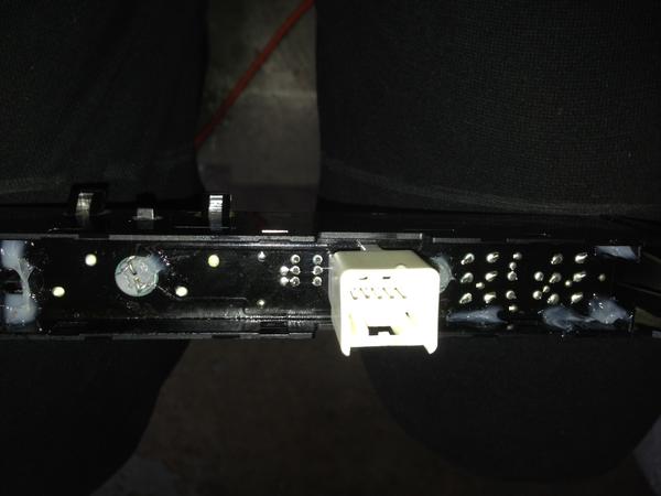

When I went to remove the white wire connector in the back, the dang circuit board popped-off. As far as I can tell, the little tabs are what hold it in place inside that black strip. Pushing the rear defrost button dislodged the circuit board. After confirming that each green NEO LED works properly, I put a little tab of this adhesive on the back of the rubber base of these bulbs. This will keep them from rotating lose. I will do this on all NEO bulbs before final installation. If I ever never need to replace or remove them, an X-acto knife will free them up.
That un-removable cigarette light bulb was snipped-off. I wired-in a 74 base and inserted a green 74 LED bulb. Between this and a green 74 LED bulb under the ashtray, lighting down there should be greatly improved, and hopefully in the cupholder area too...
I will solder and shrink wrap that connection later...

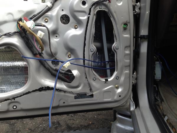

All door speaker wiring is done up to the front kick panels, where the cross-overs will be located. I might start crimping connections later today. I have several crimp tools and I need to see which one/s will work best with these terminations...
All four speaker housings are secured to the doors with that silicone too.
With interior panels off the doors and interior pieces, I spent quite a bit of time vacuuming and cleaning 17+ years of dirt and grime.

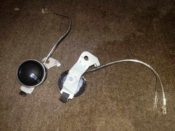

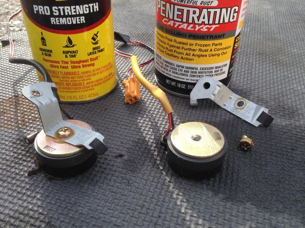

I got to the tweeters. I decided to make use of the factory tweeter bracket, which entails removing the tweeter, which is glued and screwed into place. Each one took about 15 minutes to break free. A before/after:
Once cleaned-up with rubbing alcohol, the bracket was ready for the Infinity tweeters.
They are currently sitting on the fireplace mantel to speed the cure time. They are rock-solid already. The same GE Iron Grip stuff...

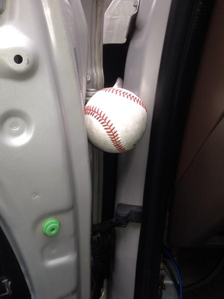

"Daddy, do you see our baseball?"
Works great to hold the doors open... I used a softball on another door.

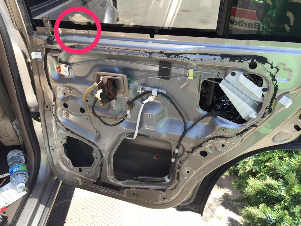

Those black plastic clips that go-over the top of the doors... Does anyone know their purpose (I can guess) and know how many should be on each door? Here is the photo Sean provided earlier:
280132d1514778172-tonyb66s-ownership-build-thread-2000-limited-df294a3c-cd21-4c5b-b737-0bbd3efd967d.jpg
On the rear door show above, it looks like two should be there, the same size. The front door, at least mine has a smaller one... Unless I'm missing it, I don't see these are order-able items. I'll be reluctant to install these door panels until I have these or something comparable...

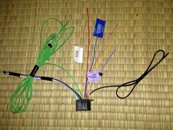

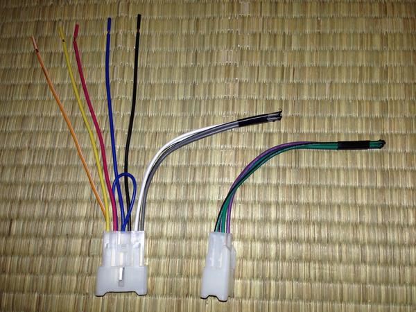

Began working on the wiring harness. Confusing stuff at times. Mike was quite helpful, so that made it easier...
Here is the harness provided by Pioneer for the HU. Those wires bunched-together to the left are the eight speaker wires, which will remain unused. I'm using the HU's RCA outs to the amp instead. So, I taped those unused wires together and put a little liquid tape on the ends of each. What remains are seven wires...
Green = parking brake, per the label. As I understand it, that is for the display, so that it should only operate when the parking brake is engaged (the truck not be driven). Since I plan to eventually output to the rear seats, I will attempt to defeat this well-intentioned safety feature. Apparently, grounding this green wire does the trick. Would appreciate confirmation...
Yellow/Black = mute, per the label. I need to read-up on what exactly that means...
Red = switch power, as stated by both Metra and Scosche.
Yellow = constant power, for memory, per Metra and Scosche.
Blue/White = system remote control, per the label. This seems to not be a wire for connection purposes, but to receive signals from the remote control. Again, need to read...
Orange/White = illumination and/or dimmer, per Metra and Scosche. Do we have factory dimming on the HU?
Purple/White = reverse gear signal input, per the label. I imagine this must be for the back-up camera.
Black = ground, per Metra and Scosche.
Now, the Metra adaptors. Two are included as two are or were connected to our factory amp. The smaller adaptor on the right has four wires, for the rear speakers (a green pair, and purple pair). Those also are taped and have liquid tape applied to the ends. Basically, I won't even use this adaptor as there are no wires being used in this application; unless I did something wrong...
On the larger Metra adaptor, similarly, the four wires grouped together to the right are for the front speakers (white and grey pairs). So, from the Metra adaptors I a left with five wires.
Orange/White
Yellow
Red
Black
Blue = power antenna, per Metra and Scosche.
Hmmm... Some of these wires seemingly don't have dance partners. Those with more experience on such matters, I welcome your input.
