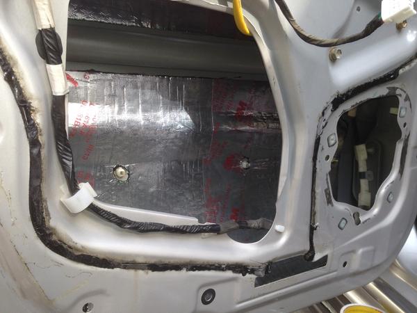

So, onto the Runner, about the only thing I did today was to measure what size piece of butyl I'll need to finish the top of the rear door (10.5" x 19"). These sheets are 19" long, so that worked-out well. I'll do a rubbing alcohol cleaning in the morning then find a way to get that top part in place...
Both rear doors, exterior panels, are sound-deadened. Quite happy how it turned-out. The other door did indeed go faster as I just flipped the template over and cut the butyl with scissor and Xacto knife...
I took nearly an hour cleaning each door. I went-through half a roll of paper towels, first with water, then rubbing alcohol. The roller is darn near a must. It's decently warm here, so having the butyl sheets in the sun works well. I still hit each one with a heat gun for about a minute before applying...
On the seams I put some 3M metal tape. I adhered very well.

Install looks good. I don't think you need to deaden the interior of the door or the plastic.
Thanks Brian. I know some can get quite fanatical about this stuff; and I'd like to not go there, at least on this build.
Once I get the exterior panels done on all four doors I should have some remnant pieces of butyl. I might then strategically apply those on the interior sheetmetal around the speakers...

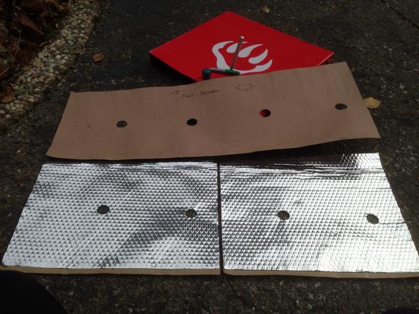

Got the front passenger door sound-deadened. I created a template again, so the driver door should go faster tomorrow. Can't wait until this is done. My hands and forearms are taking a beating on the sharp edges and stuff inside the door. It was dark when I finished, so no completed photo. One before...
The template seen here is for the bottom portion of the door, below the impact tube that runs front to rear. I didn't need a template for the portion above that as the remainder from the bottom pieces fit quite nicely above. That was pretty cool.

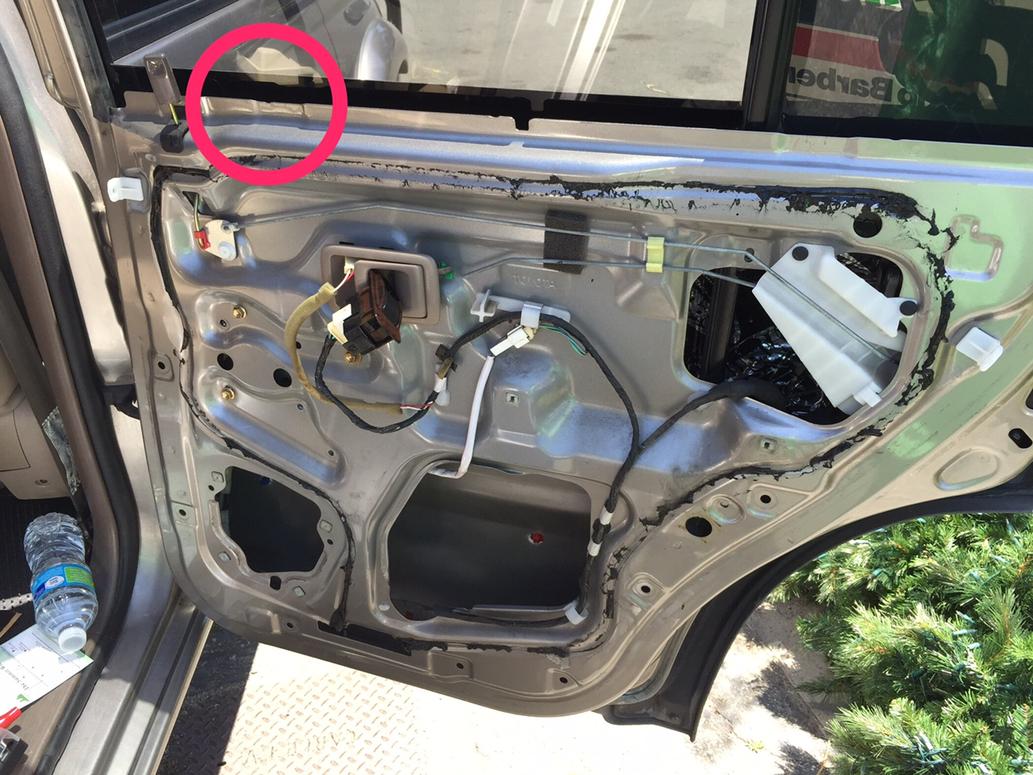

On the ground below the door I found this plastic piece. If from the 4Runner, does anyone know from where?
That looks like a plastic clip that clips on to the door where the door panel fits onto. They seem to be placed closer to the tweeter where the window comes up.
This is a picture of the rear door but I believe that plastic clip piece lives on one of the front doors.. driver or shotgun.

Sean, thanks for chiming-in.
I think you are right. It was dark, but I'll take a look tomorrow.

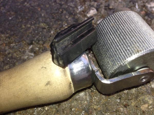

As of yesterday afternoon, all four doors are sound-deadened (exterior sheetmetal). For those who wish to do the same, as provided earlier, this product provides enough material:
https://smile.amazon.com/gp/product/B012B5EMGO/ref=oh_aui_search_detailpage?ie=UTF8&psc=1
Get the roller too.

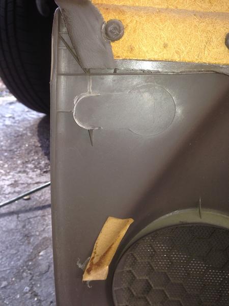

I had noticed that the driver side door panel was a bit loose on the hinge side. After removing it, I see why:
The piece that had snapped-off was still there thankfully. I had found the same on the passenger door too. I thought it might have been my doing from when I removed it, but I don't think so now. I plan to try some JB Weld, possibly later today. I hope that does the trick...
