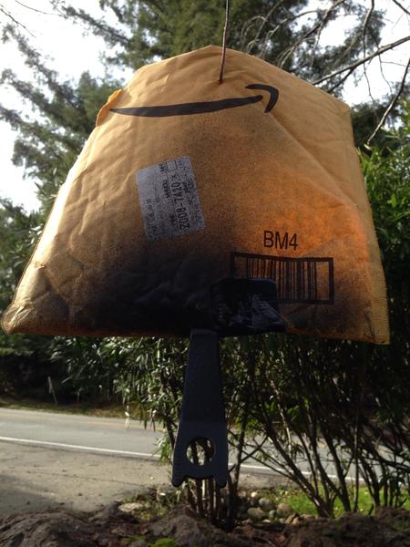

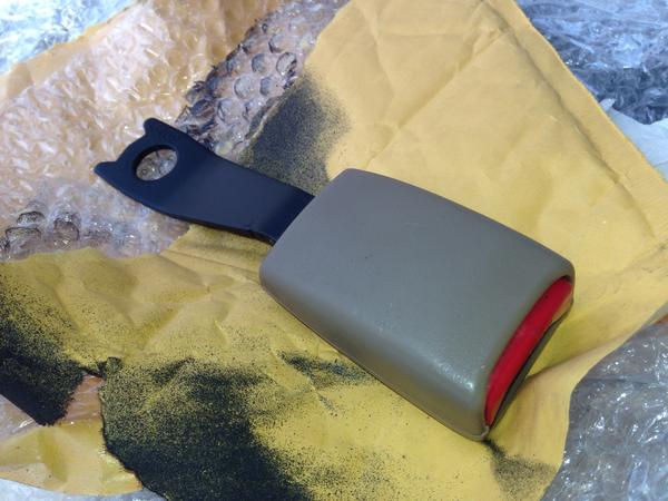

Paint I think is dry now on the metal 4Runner seat belt receiver brackets I need to install on the Corebeau bases. I painted both, and between coats I got the passenger seat base installed. So far this has been a very smooth install...

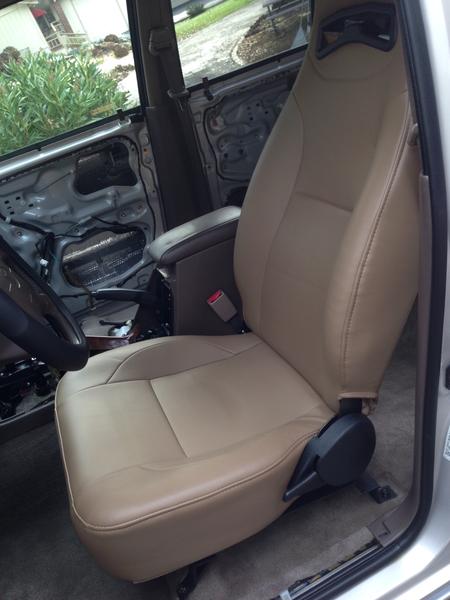

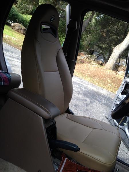

The driver's seat is in, and I'm very happy with the install and the seat itself. First, the aforementioned seat belt buckle receptacle or receiver, painted.

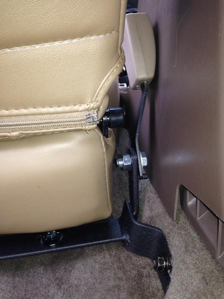

And, on the driver's seat ready to be mounted.

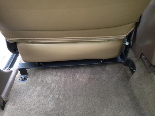

I highly recommend threading the seat bolts first before the seat is installed, then note where each one goes. I have one for each seat that was problematic and needed some attention. Best to do that with the seats out. So, with a little jostling of the seat to get the holes aligned, and bolts strategically tightened, it took all about 10-15 minutes.

Both are installed. That was done early in the afternoon actually, but I didn't get any additional photos. I noticed that in the photos shared earlier, some look almost yellowish. That was due to the flash. They are a nice tan color, mixing-in quite nicely with the various shades of brown in the interior.
They are firm, which I really like. I will go gas-up in a bit as I'm heading into the office tomorrow. I do so once or twice a year when my mgr can make it out here; and he's here this week...
No height adjustment which I'm fine without. There seems to be a bit more headroom with these. They tilt very far back, darn near flat, up against the rear seat cushion.

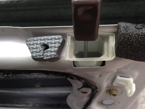

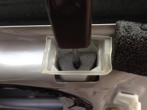

The culprit of the aforementioned rattle...
I have some beaten-up Harbor Freight mats that I use in the yard, working on the vehicles, and I decided to cut-off a small piece.
Worked like a charm, not more rattle. I made one for both front doors. The rears are different...

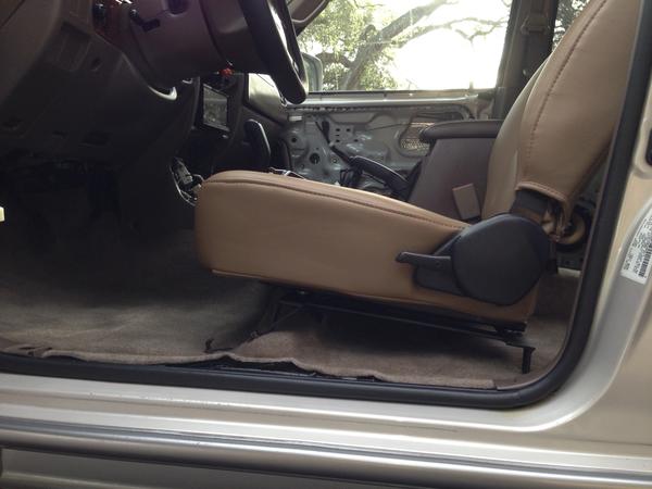

The stock seats are in great shape. The electric adjustments work just fine. I even made two short videos of them operating, as I plan to sell them. Any idea as to what these sell for?.

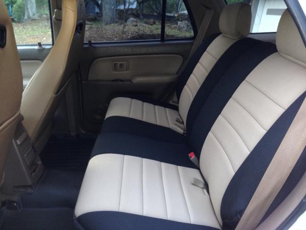

And, the back ones, ready for some abuse...
The fit of the Wet Okoles was as advertised, like a glove. I first cleaned the factory leather, treated it (leather care) , then wiped them dry, before putting-on the covers.
