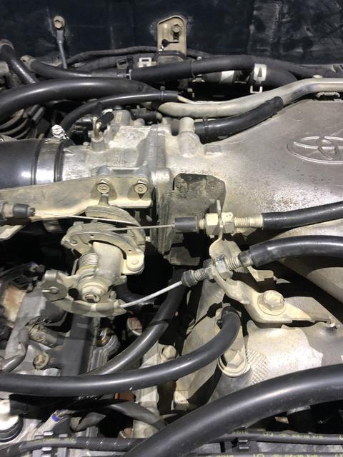

Anyone know what this is? A little over 2 inches long... It was in the engine bay, down by the intake box.

It goes over a vacuum line on the side of the throttle body.

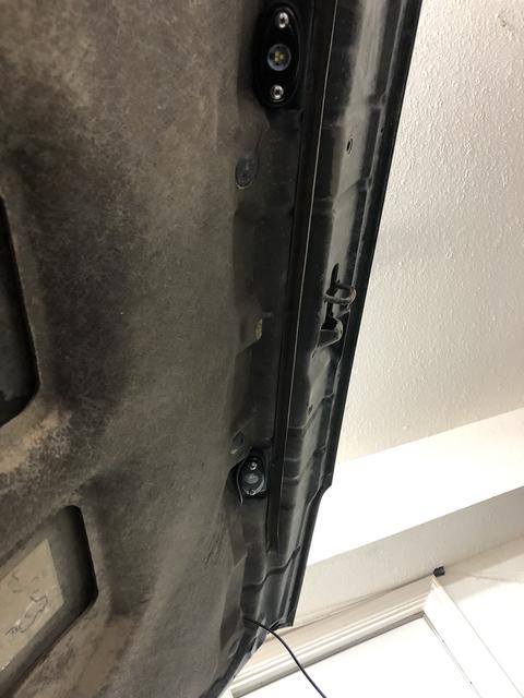

Man it’s nice having hood lights lol, here’s a pic for reference.. guess it’s right behind the TB
Like your idea with those lights, a lot. My apologies if you mentioned it in your build thread, but are those lights manually switched, or turn-on automatically? I actually think I would prefer a switch, in the engine bay.
I'm usually very good about putting parts back on my wrenching projects, so I think that was done before my ownership. I'm curious what function that part serves. I suppose it will be obvious when I look later... Thanks again.

I cut the plastic fender liner flush with the bottom of the fender.

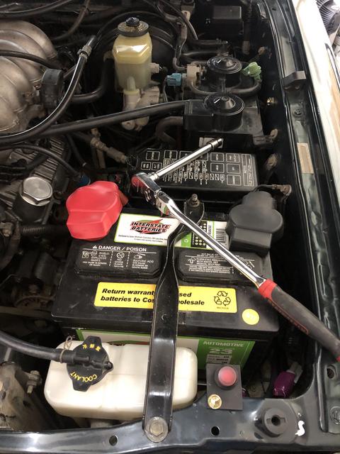

They are manually switched. I had a pin switch on my Tacoma and it was just a hassle, was a crappy pin switch though.
Here’s the little bracket I made for the switch.. (next to coolant overflow)
Here’s the lights rivnutted to the hood..

Thanks for sharing those details. A well lit engine bay is so nice, especially when not home with the full assortment of lighting.
Are you happy with the placement of those two lights? Curious if you have any dark spots or areas not as bright as you'd like...

No problem man. I think the placement actually ended up perfect. Whole engine bay gets lit up with not much shadowing at all.
