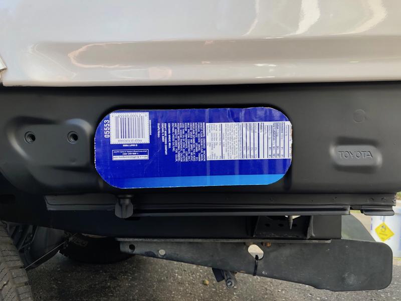

Had about an hour today and got more prep work done... Still more black to hide the "ugly" behind the new bumper.
Between coats, I decided to work on sealing that vent. I found that a spray can cap has a similar radius bend.
Made a template and it fit well.
Traced and cut-out a piece of aluminum.
I filed the edges and will rough-up the exposed side for painting tomorrow. I'll silicone it into place. It's rated down to -50 degrees F, up to 300 or 400...

I have some aluminum sheet metal at home, going to copy this idea as my vent flap is gone as well lol.
Cool. Sounds like you might actually make a functioning flap, like the factory one. I actually thought about that, for about 30 seconds. Decided to just seal it. Mine is curing now. The silicone adhesive I have was previously opened for other projects, and is often the case, they were blocked. I had these two to choose from.
I ended-up going with the XtraBond250, despite it being almond color for a recent bathroom project (Swanstone shower install). It was the fresher of the two and has better temp specs (down to -76F):
I thought about making a flap but yea too complicated lol, going to seal it. I don’t want to take my bumper off either but I’m thinking I might just pop it out from inside and do the work at the work bench.
