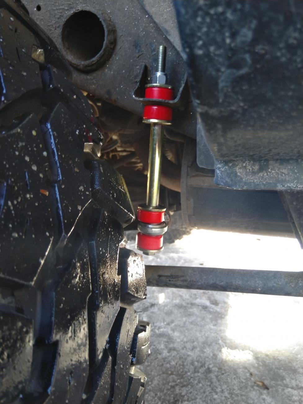

Looks like I can use longer rear sway bar end links. Anyone know if member pearlj10 is still selling his? I PMd him a day or two ago, but haven't heard back yet.
https://www.toyota-4runner.org/1208746-post1.html
The price is appealing and they looks plenty strong...
I built myself some links about two weeks ago using the Energy Suspension bolt and bushings from Advance Auto and some military spec 1/2" heims. Took a couple minutes and they seem like a pretty fail-proof design.
I'm sure PearlJ10's are great and I think there are 1 or 2 other forum members who build them. However, I only spent ~$20 on mine on they are sufficiently overbuild in my opinion. Just an idea to build them yourself.
If you want any pictures or measurements of mine let me know.
Yes, please! Here is fine. I found a thread or two here describing pretty much what you did, I believe, but they used an eye bolt. Wasn't so keen on such usage though.
I have what should be about a 3" lift in the back, so please let me know what yours is too. Again, thank you.

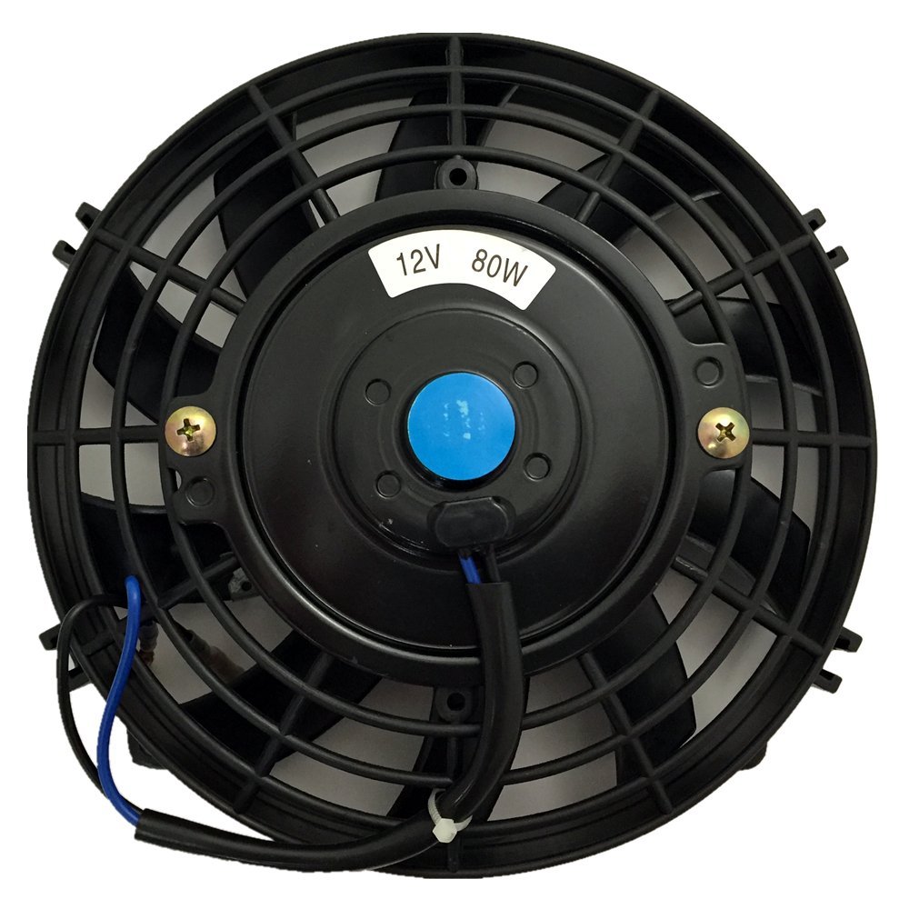

LOL. That's the fan.
I don't recall the depth but it does fit. Here's the only shot I took while I was doing the install.
If you go with the same fan there's one thing you need to do. You have to convert it from a pull fan to a push fan. From the factory it's set to pull air from the rear and pass it to the front. You'll want it set to push air from the front to the rear. It takes less then 5 minutes to do.
Undo the nut that holds the fan to the shaft. Pull the fan off. Flip the fan over. Put the fan back on. Re-install the nut. When you wire it wire it in reverse. Positive to neg and neg to pos. That will spin the motor backwards, which causes no harm to electric motors, and just like that you now have a push fan.
Matt, you still around? If so, did you mount your fan with just two small bolts through the provided holes? I see one on the top, but I imagine you might have one or more on the bottom, blocked by the light. I'll be pondering an install, maybe as soon as this weekend...

OK, so. I only have 1 decent picture on my phone and will not be back to my car during daylight I don't anticipate but I can try to get more pictures later.
I have ~2" of lift using 99 tall coils with 1.5" daystar spacer.
Parts List:
x2: 1/2" heim/rod end with ~3-4" of thread. I used 4130 alloy steel milspec ones but this is definitely overkill.
x1: Energy Suspension sway bar end link kit from parts store. I got the 4-1/4" option but then cut approximately 1-1/4 inches off. The exposed thread portion was perfect for me.
x1: tube of grease so the poly bushings don't squeak!
Process:
1) Test-assemble heim into the bolt-head end of rod set-up and hold up next to current end link.
2) Estimate where the sway bar needs to be to sit level.
3) Cut off excess steel from the long bushing spacer
4) Cut out old end links with sawzall
5) Use drill to clean up the hole in swaybar by ~1mm
6) Assemble - should be very simple
I will try to get a measurement of my assembled length and better pics but no guarantees.

Nice! Much appreciated. I'll give it a try. As for the ES kit, might it be the 9.8121? These are the ones in black that I still have in my Amazon cart.
https://smile.amazon.com/Energy-Sus...coding=UTF8&psc=1&refRID=JZYP4N6H8ZKK6VJQ1VPN
Ah, I just saw that those are the 4 1/2" sleeve length. Yours are 4 1/4"....
Ok, found this on the ES website:
energysuspension.com | Sway Bar End Links & Set Sizing Charts
The 4 1/4" looks to be the 9.8149.
Also, might you have a part # on the heim?
You should consider a dedicated thread on this topic. Thanks again!
I think you would be fine with either the 4-1/4 or 4-1/2. If desired you could buy just the bushings from them and then buy the bolt and steel sleeve to the size you desire at a local hardware store.
For heims, I am in college and participate in automotive design competitions so I snagged some mil. spec rod ends from our shop because we had some in the wrong size. These are worth a good deal of money so they aren't recommended unless you need an end link that is literally bomb proof.
McMaster Carr has an awesome selection of rod ends if you want to find exactly what you want for material and design.
McMaster-Carr
One like part # 60645K16 would be sufficient or you could run to a specialty hardware store or off road shop and pick some off the shelf there.
I will consider doing a better write up with part #s etc when I have time because these are an easy and fun DIY project for all the people who are lifted but have not adjusted their other components to accommodate added height. My stock link snapped while wheeling and otherwise I would have never upgraded!
You have me thinking about just building them... Grade 8 bolts would be great. Looks like the ES ones are 3/8" grade 5. Might make a trip to the hardware store soon...
For power, since I have manual seats, I'm thinking I might use that circuit. I believe it's overkill at 30 amps though as I believe it also works the sunroof, which I don't use and want to eliminate anyways...
I'm still around but only occasionally. Since, the whole hack and nobody owning up to what actually occurred I've been spending most of my time elsewhere on the web.
My fan has 4 mount points. If you blow up the photo you quoted you can see the one up top that goes through the cooler. There's another one on the bottom that does the same thing. You have to carefully drill those since there close to the fins. If you look in the photo you quoted you'll also see a mount point on the fan to the left. There's another hidden on the right. The fan comes with the tabs and I used the stop ties provided with my cooler. This is as good a photo I can get of those mount points.
Hope that helps a bit. Your rigs really starting to get in wheeling shape pretty quickly. The work looks damn good so the fan thing should go pretty easily for you. If you ever find yourself over this way and want to hit some trails let me know.
Yes, that helps Matt. I get it tomorrow, so I'm sure it will be even more clear... With all of the bouncing you do, it seems like it's secured quite well.
You've been missed around here, but I understand. Indeed, if in your area, I'll give you a heads-up for sure. Fond memories of the 395. Having not been wheeling since my 20s in an FJ-40, I will be the limiting factor, not my 3rd gen's capabilities. That's fine, and I look-forward re-learning so much, and hopefully it will come-back fast.
Be well Matt and thanks again.
