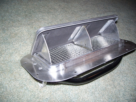

Ryadon Vent Only, 8X12 Aluminum Double Pop-Up #RV-626-062 - BendTrailers.com
In steel (above aluminum), 23 bucks: Painted Steel Double Pop-up Vent #9106VEN - BendTrailers.com
I like the idea of a vent, screened, to release heat on hot days, prevent condensation if sleeping within...

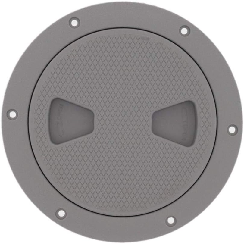

Amazon.com : TCH Hardware 6" Grey Round Deck Plate Inspection Hatch - Screw Off Water Tight Lid : Sports & Outdoors
Got it yesterday.
Unfortunately, this battery does not fit through. Drat.
I'll likely keep the deck plate as I'm happy with the quality and maybe I can find a use for it, somewhere...

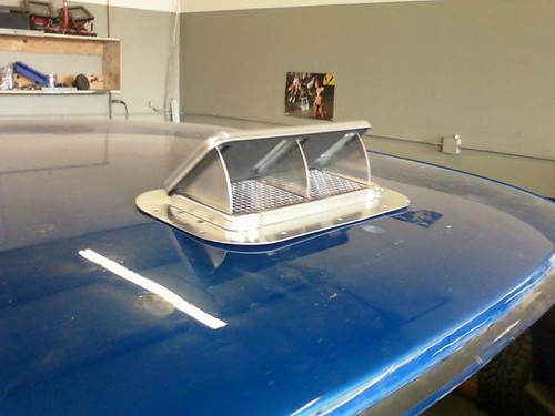

Regardless, I decided to make a hole and figure it out as I go...
I created a template, a tad wider than the vent (approx 6 1/8") and about 12" tall and traced it within the tape border I applied many months ago.
Decided to use a Dremel, with the bit not sticking-out much as I know I have wires and cables back there.
First cut done.
And out...
And the battery fits through no problem as the opening is about 1/2" wider.
I already see tie-down possibilities and of course I need to figure-out a door too... I'm inclined to not have a hinge as that would make it difficult to open when the rear is full of cargo. I'm thinking of using a dimensionally larger piece of thin sheet metal that spans the opening that I can simply slide up and out...
