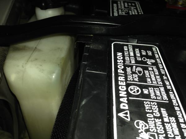

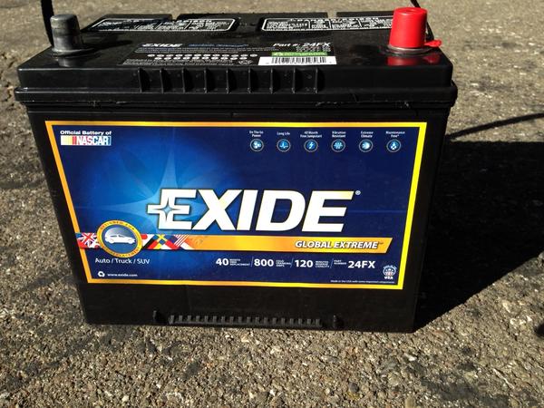

Battery in the Runner, so not on the ground more than a few hours. Speaking of which, the top bracket that secures it seems is larger than the battery. In the front, right behind the cool overflow reservoir, there is about a 1/4" space or gap...
I installed the battery in the dark, so I'll look in the daylight tomorrow...

...the top bracket that secures it seems is larger than the battery. In the front, right behind the cool overflow reservoir, there is about a 1/4" space or gap...
The bracket is made for group 24 batteries, IRC, I made a filler wedge for my optoma yellow top so the clamp is taught enough to secure the battery.

The battery I got is a 24FX, so I would think it would fit better in the bracket. I'll likely insert something to take-up that space...

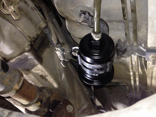

I just replaced the fuel filter though. Pretty straight-forward. Definitely clean-up the flares of debris before installing the new one. There have been accounts of leaking fuel filters, OEM and aftermarket; and that might be the culprit.
Also, snug it tight. After the initial engine start, it leaked a little. These like to be cranked-down (others stated the same).
I won't put back that plastic protective cover until after inspecting it again in a day or two...
