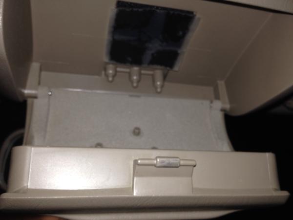

I did drive it pick-up some MAF and TB cleaner. While driving I noticed that my glasses don't fit in that drop-down box near the map lights and sun/moonroof controls. What are those three tit-like things hanging down for:
Might be a nice location to fab something, possibly even to secure my ham radio....
Can you pull them off? If so, they might be various sized buttons that attach to those nubs on the door of the compartment. They push the garage door opener buttons when you push up on the door. Some cars came with multiple sizes to account for the different size openers. Just going off memory, but I remember a car we had when I was in high school that we Velcro'd the opener to in a spot like that.
I don't know if they come-off, but I would bet so; and what you say makes a lot of sense. Looking at that photo, I see velcro and small circular nubs on the bottom of the door that probably mate-up with those things. I believe the mystery has been solved. Thanks again jbrentd.

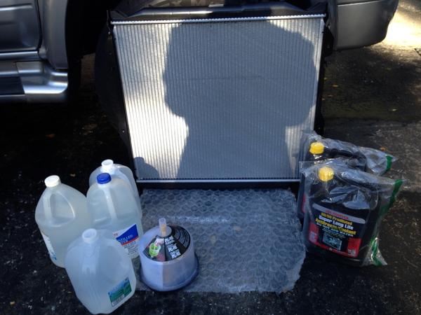

As of now, with the wife and kids gone for a few hours, I'm a little bummed as I thought I had purchased undiluted coolant. Damn, it's 50/50, which I never buy. Scrambling to find some undiluted now...
Checking with dealerships, but none are picking-up. I found some Asian concentrate locally, but not sure if I can or should mix that with the Toyota red...

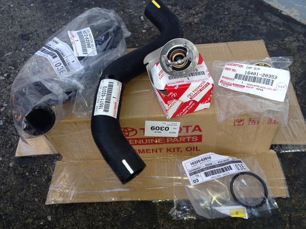

Along with the flush and new radiator, I'm planning to replace the t-stat and upper & lower hoses...
My experience is you can mix them, but why not just get the zerex 50/50 and call it a day after a flush?
You gotta get all the green out, so make sure to run it through the heater core too.

There will be about 1.5 quarts remaining in the system, which will be distilled from the flush. So, I'd need to start by adding 1.5 quarts of concentrate, then I can the 50/50 mix I mistakenly purchased.
Found a dealership that has the concentrate. 38 bucks and about 2 hours lost....
I got my local dealer to price match the online price of $28 a jug, ymmv
Time lost to DIY Gremlins are a right of passage.

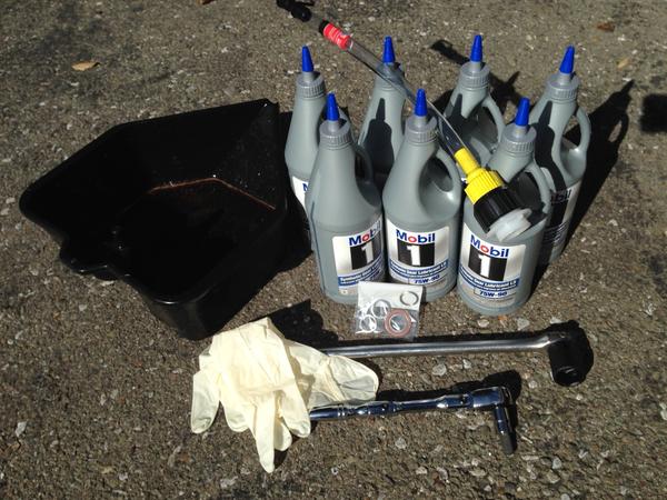

Drive 30 mins and, engage 4WD for a good few miles, to heat up the fluids before changing them

Now I can't find my gear oil pump (again, wasn't planning on this today). I hope this will do the trick...
