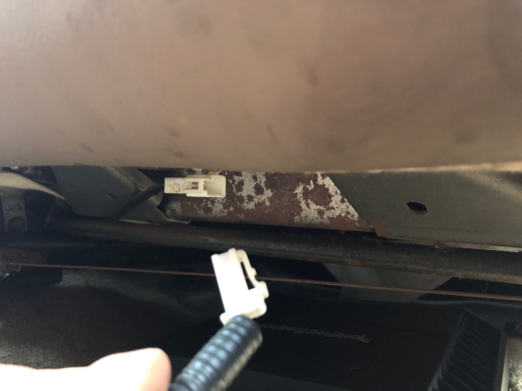

Is this guy just for the seatbelt?
This is on the seat already in my 4R. The donor is all electric.
It might be for the seat occupancy sensor. '99+ had them on the passenger side. Only used for the dash light on the '99-'00, used to turn on and off the passenger airbag on the '01-'02's.
If you are using it on your driver's side, you can ignore the plug or remove the sensor mat if you are reupholstering.

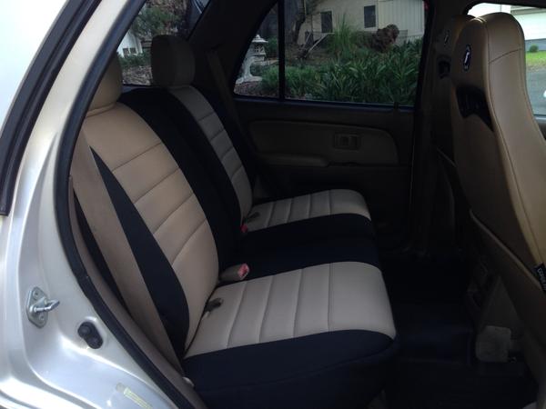

I would be really tempted to do the black neoprene. I have debated getting my interior seats reupholstered with neoprene just because of how well it holds up to abuse.
Have neoprene on the rear seats for our two monkeys!
Got them on a Black Friday or holiday special last year...

thanks, driver seat, 96, traced it to the seatbelt.
The donors seem to have occupancy and all the motors. Probably give them away if anyone is looking for all that.
