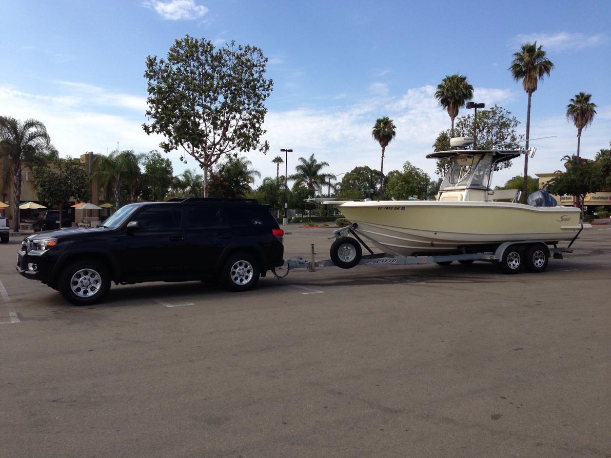

We pull a 24' boat just under 5000 lbs up a 6-8 percent grade at 30-35 mph. I was pleased with the lack of squat without airbags or mods. Not sure if the KDSS helped but it's a nice freeway pull at 60mph.
