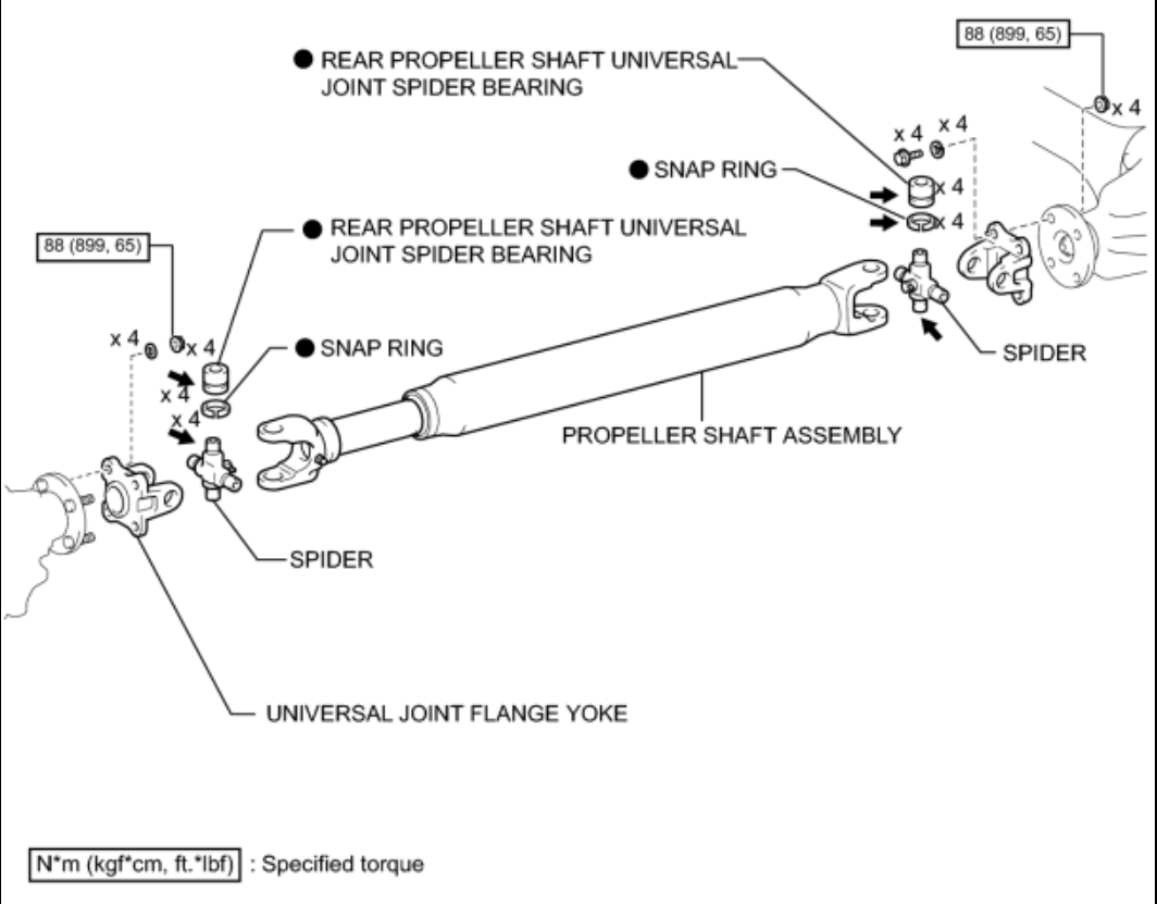

If this is what you are asking, the torque specs for the front and rear propeller shaft yoke nut/bolts are 65 ft lbs.
Thanks for the specification. As a scientist with zero mechanical experience, just starting to do my own maintenance, it's nice to have a straightforward protocol before beginning.
