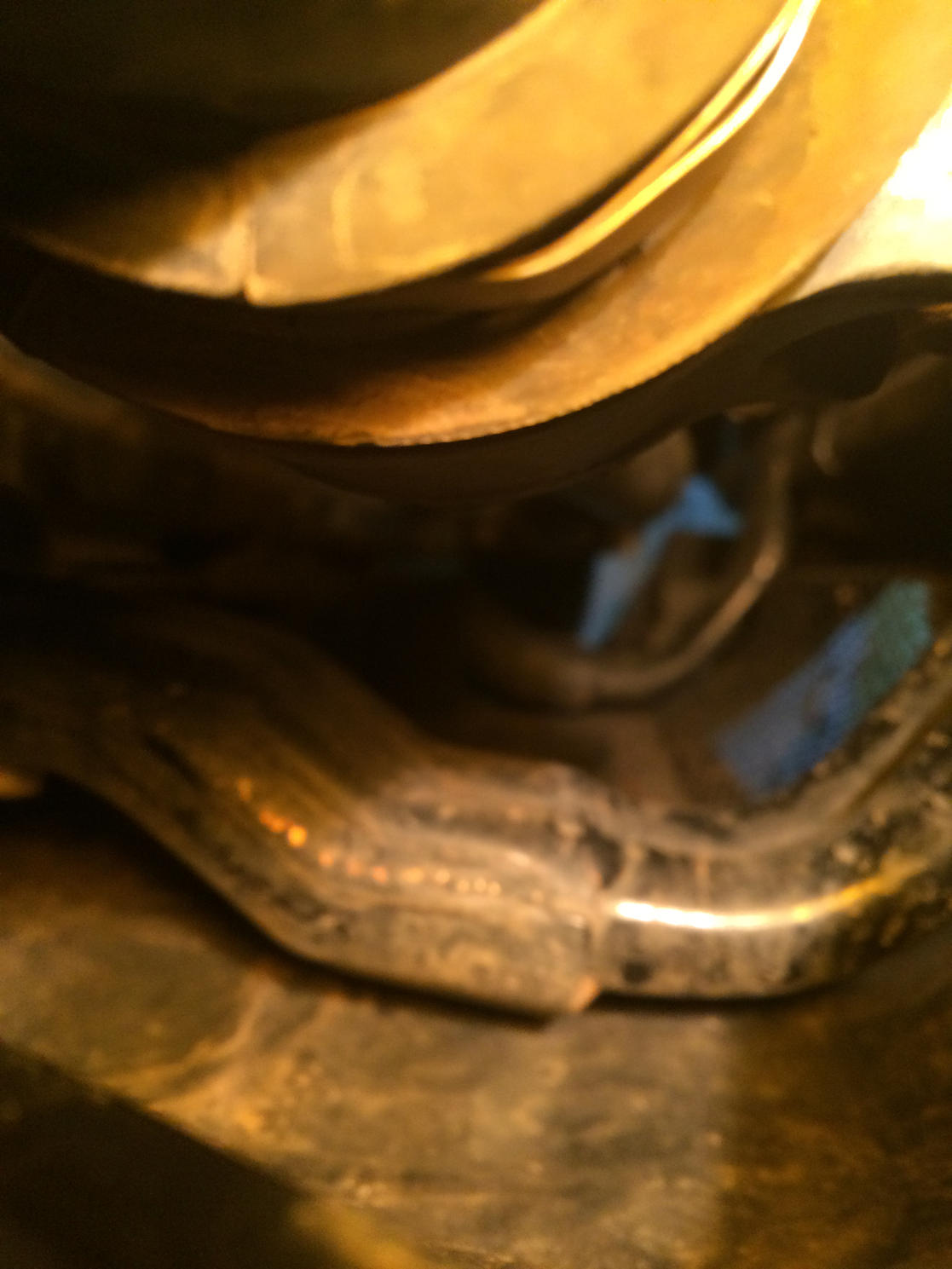

I guess my question at this point, is there any contact with the radiator support bracket to know if this could be the sound? I would think you'd see paint rubbed off or something otherwise it would have to be something else.
The only contact I can see is on the top outside of the radiator support bracket. In the photo I have attached the skid plate is still on. (forgive me I didn't have time to remove it.) The bright orange scared part is duplicated on the outside of both radiator support arms. It's about 2-3 inches long. That is all I can find until I have a chance to remove the skid plate. My sway bar is a bit different shaped than the one noted in the thread mentioned here. (I believe because its KDSS.) Regardless the spacers are being installed next Monday. When they have it all apart I will get a close look at it. Sorry the picture quality is poor
