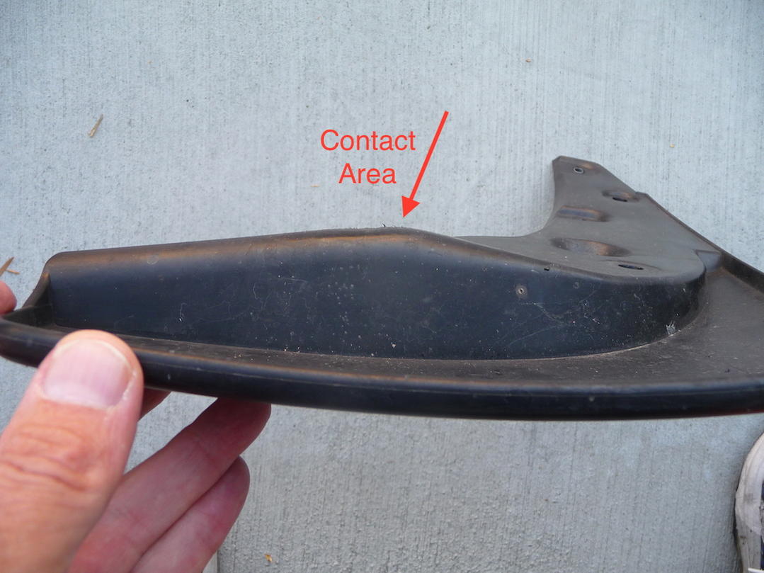

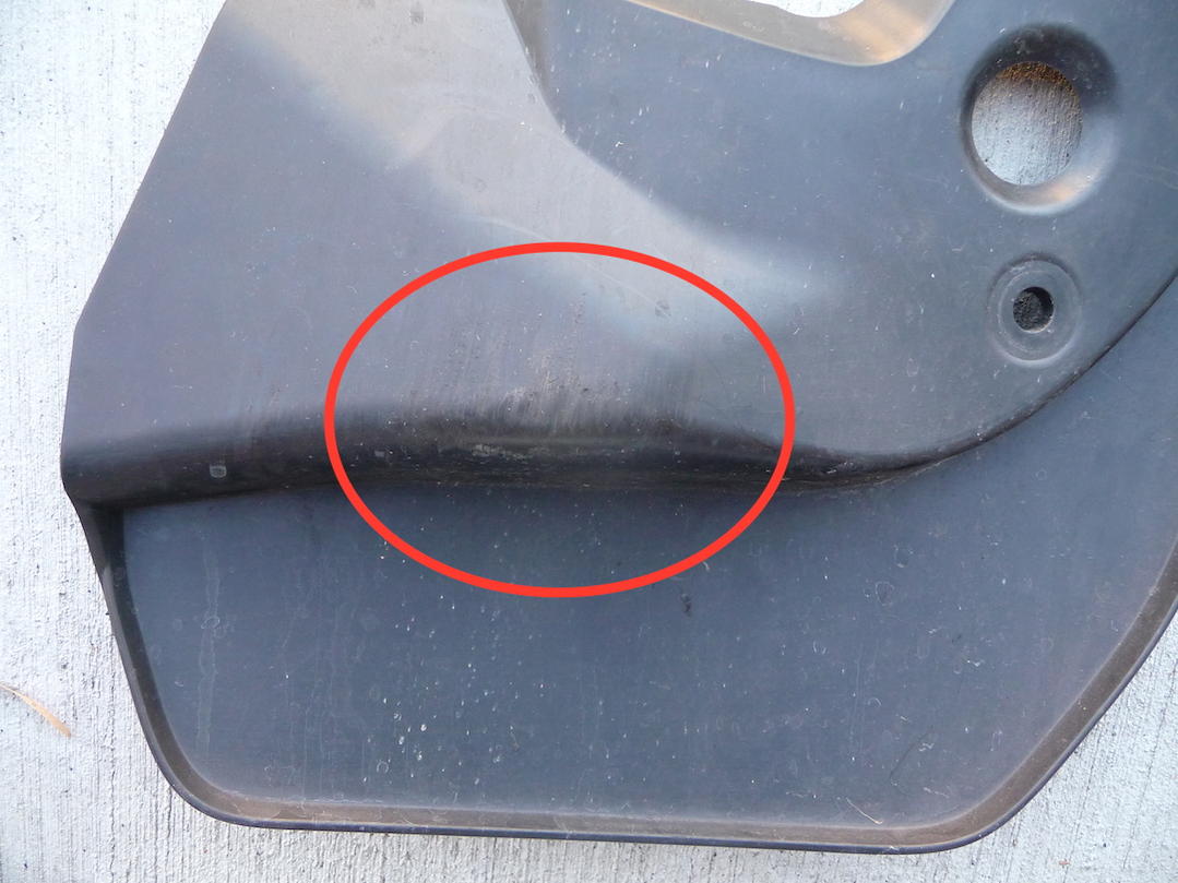

I'm running 275's on 8" wheels with 4.1 back space. Getting some tire contact on the mud flaps but no need for the BMC.

Yea..it does suck that I'll most likely have to remove the mud flaps but I guess every modification comes with a sacrifice or two in some manner. This I can live with.
I just don't think I would be able to cut the body mount at such an early stage in our relationship lol.
Thanks for the pictures!
