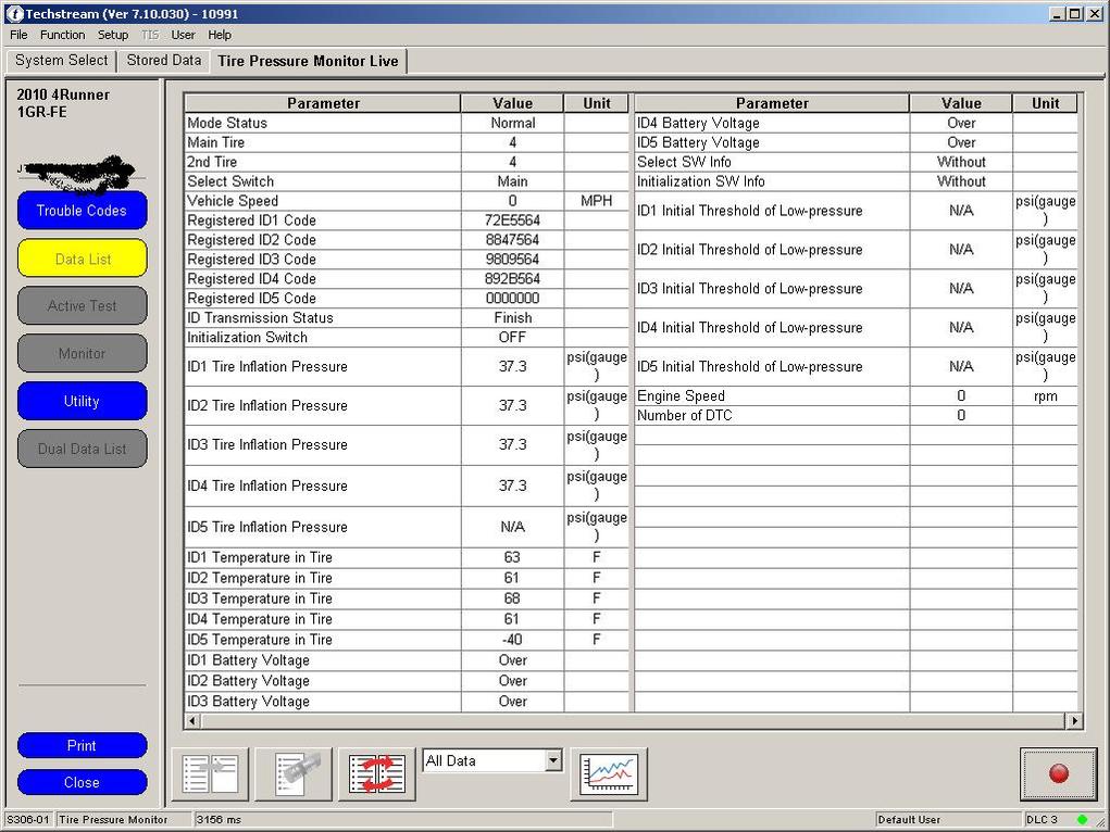

Unless i can figure out how to re code modules with the tech stream(like i can with BMWs and audis) i dont think it will be possible.
Here's a screenshot of TechStream TPMS info.

look at you and your 37.3 psi exactly in all 4 tires!!!! You fancy
Yeah, maybe they are broken. Yesterday I measured with a gauge and three were at 37.5 and the one closest to the water heater was at 38. It was a little warmer out.
