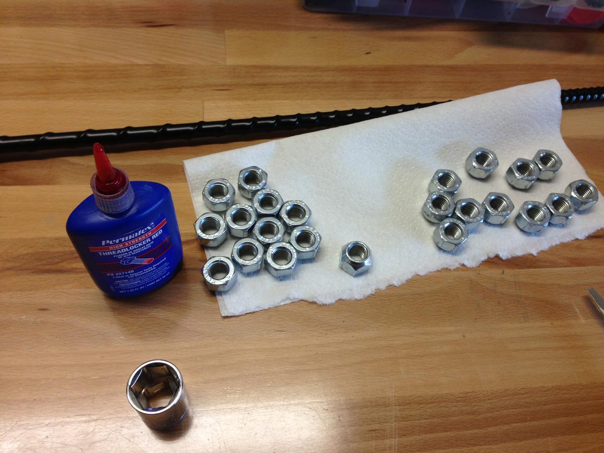

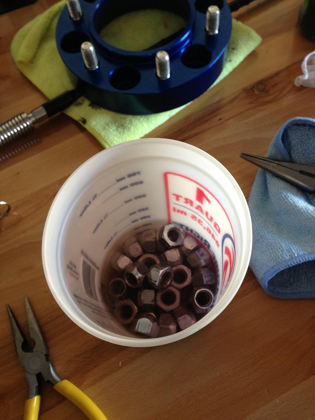

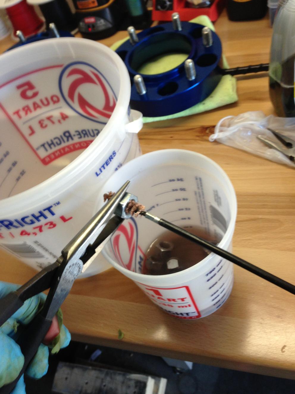

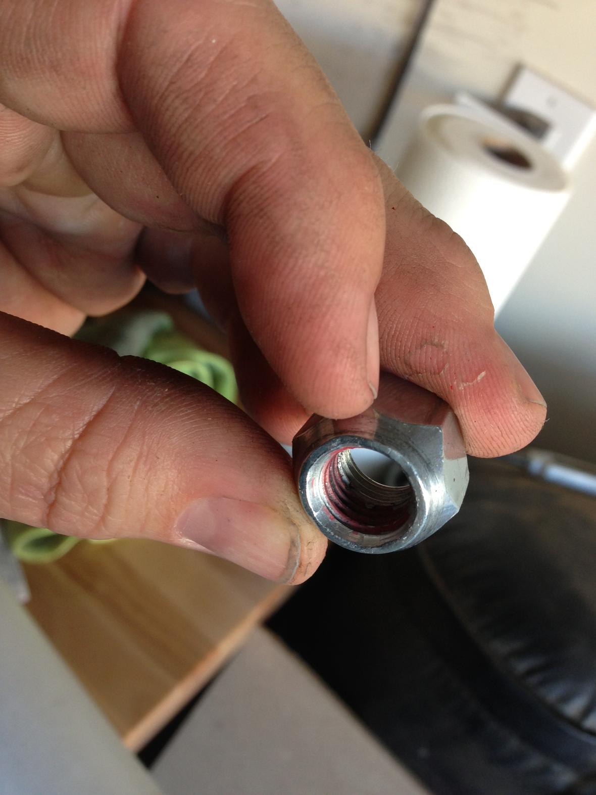

so this is how I spent my Sunday... reinstalling my Spidertrax...

I was very happy with how I had originally installed my spidertrax so it was quite a long process cleaning all the old loctight residue to ensure a solid and safe install.
What is the fluid you soaked your nuts in to get rid of the reddish, on your nuts...
