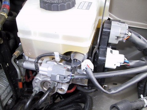

Traction control

And reading up on that Andymod thing on yotatech, I have a feeling I may have to install a momentary switch next to my "TRAC OFF" button to break the connection of that one connector on the master cylinder... This should be fun. I'll have to do some testing to make sure it works on my own vehicle, though.

This will take care of the ABS motor not cycling, but unlike previous Gen's of T4R, the 4th Gen is drive-by-wire. How are you going to get around the dethrottling?

My understanding is that if this sensor's connection is 'interrupted' going to the master cylinder, even momentarily, that it will trigger a 'fault' in the TRAC and stability control systems, thereby triggering them as 'inoperative' for the duration of that startup sequence. Once the ECU's go through their self-test on the next startup, they will see that there is no fault and will re-activate the traction control and stability control systems at that point in time.
So, it seems that IF you installed a momentary switch that would simply break the connection to that sensor even for a half second, it would trigger a fault and disable those systems for the duration of that drive, which would be perfect for the last half mile of my drive home each day.
