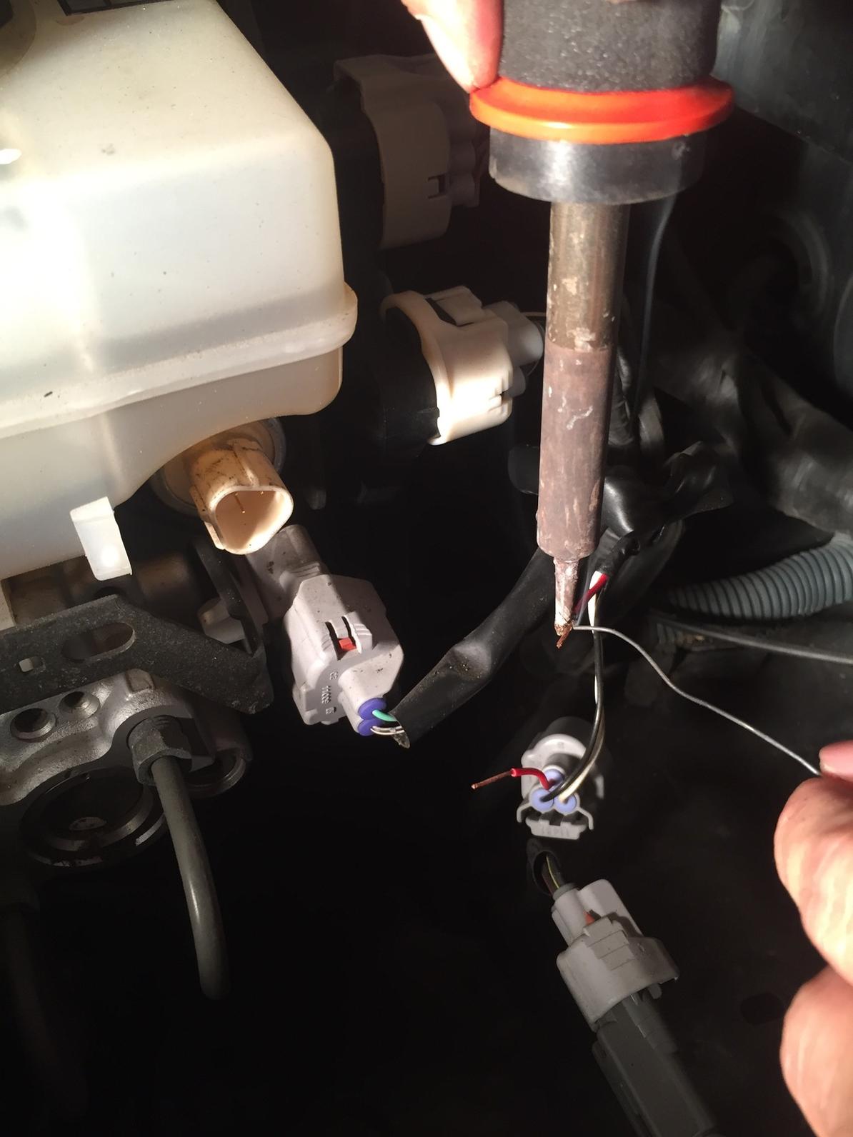

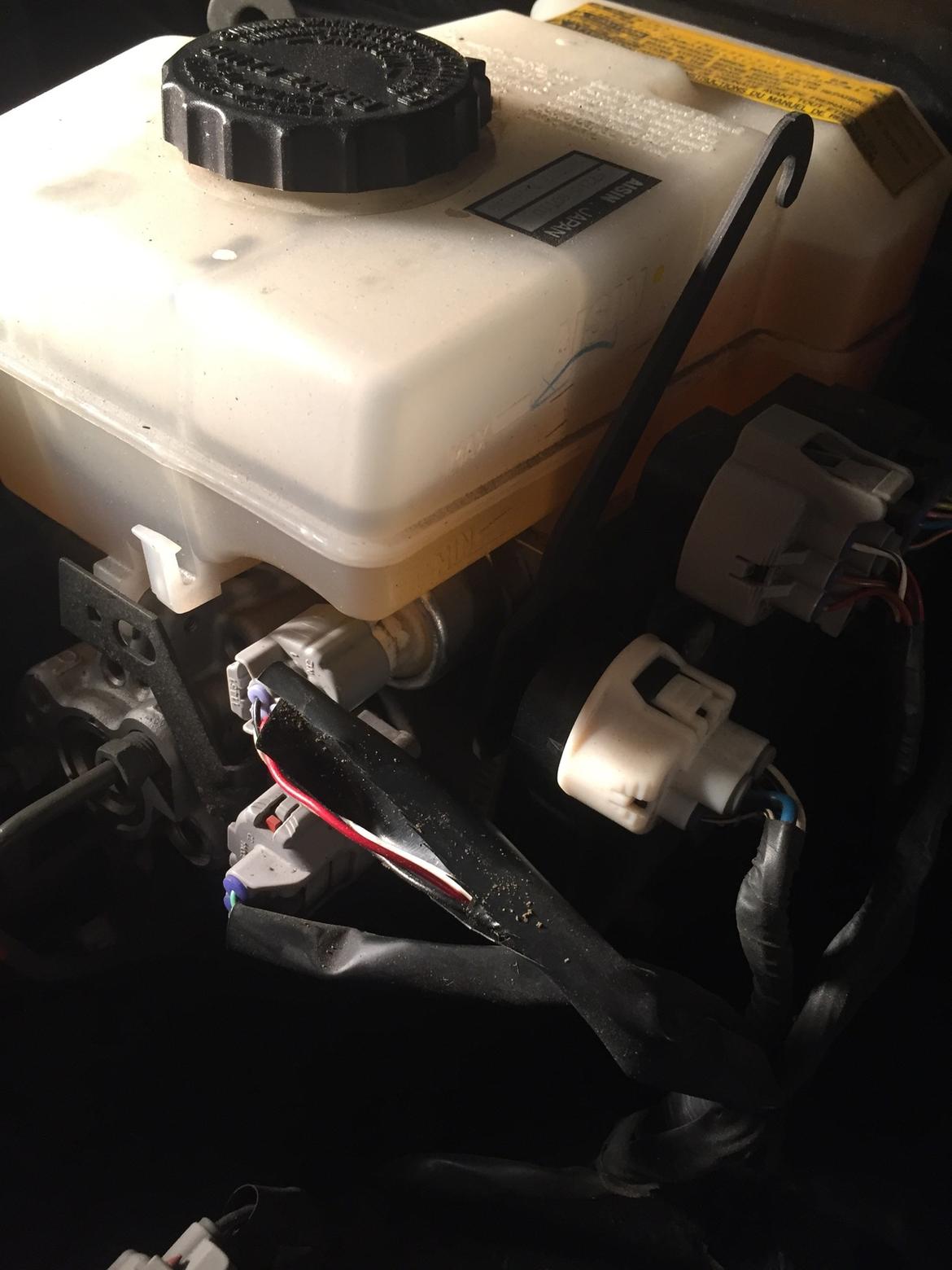

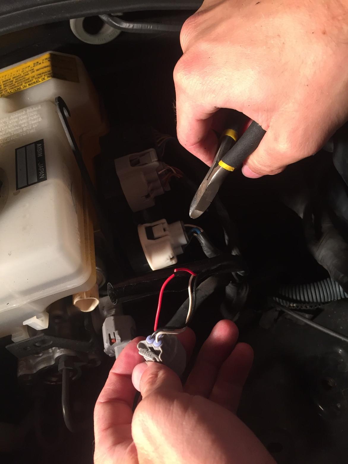

Disabling the trac. is done by first locating the pressure switch on the front of the master cylinder for the brakes. (Just below the tank with the wires exposed.

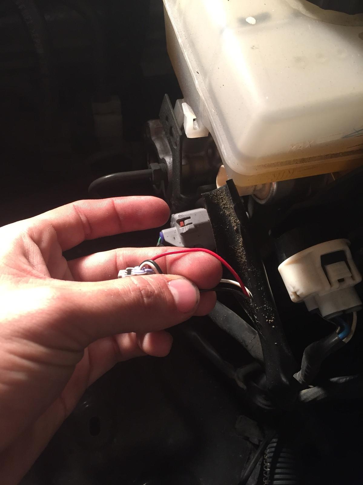

Disconnect the plug and locate the RED wire.

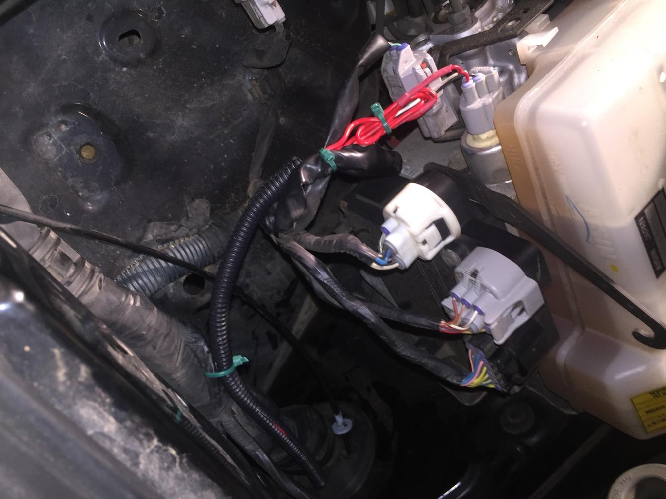

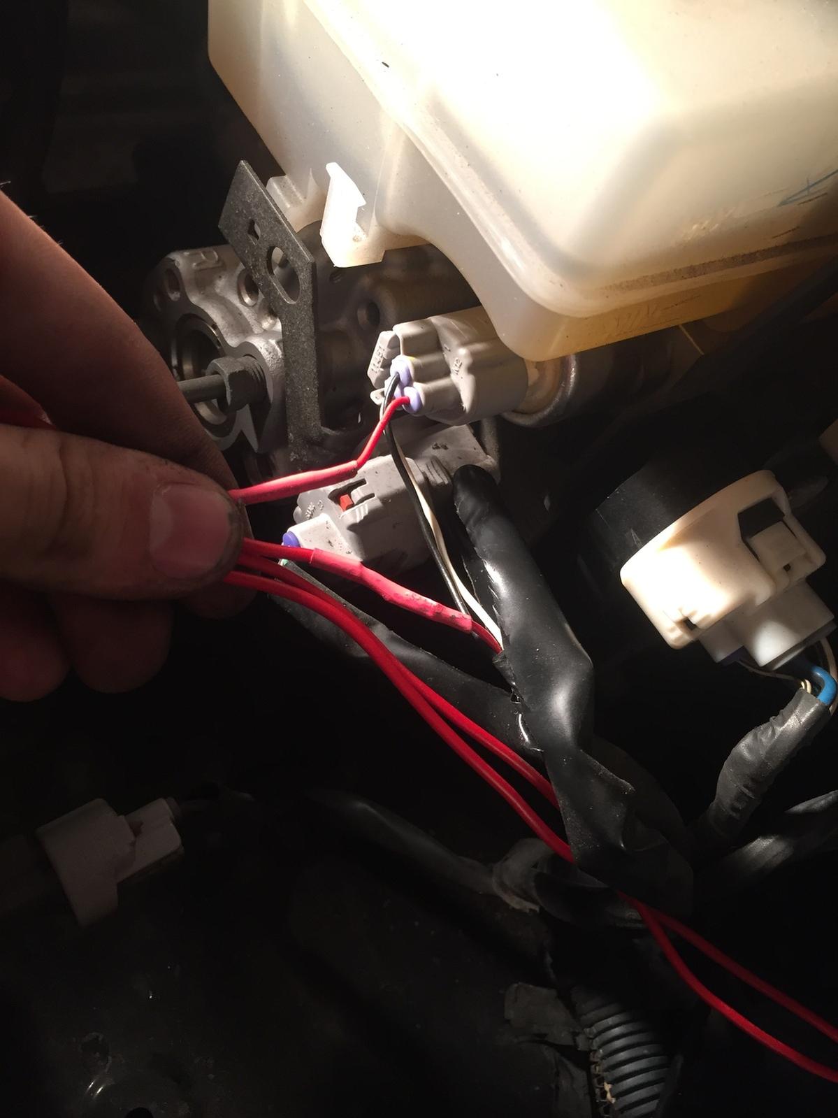

Cut the wire. Giving yourself enough wire on each side to solder or crimp new leads for a switch.

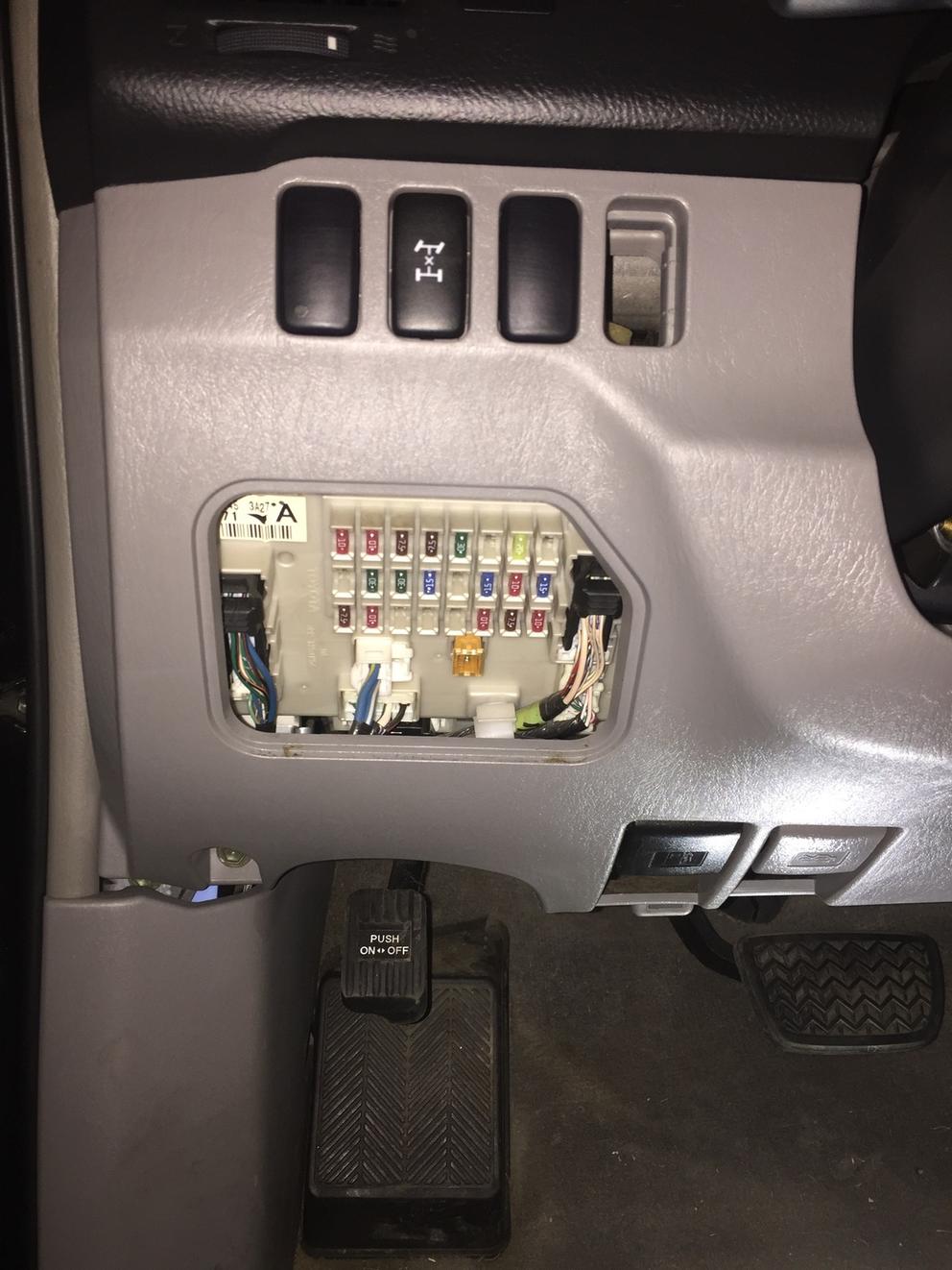

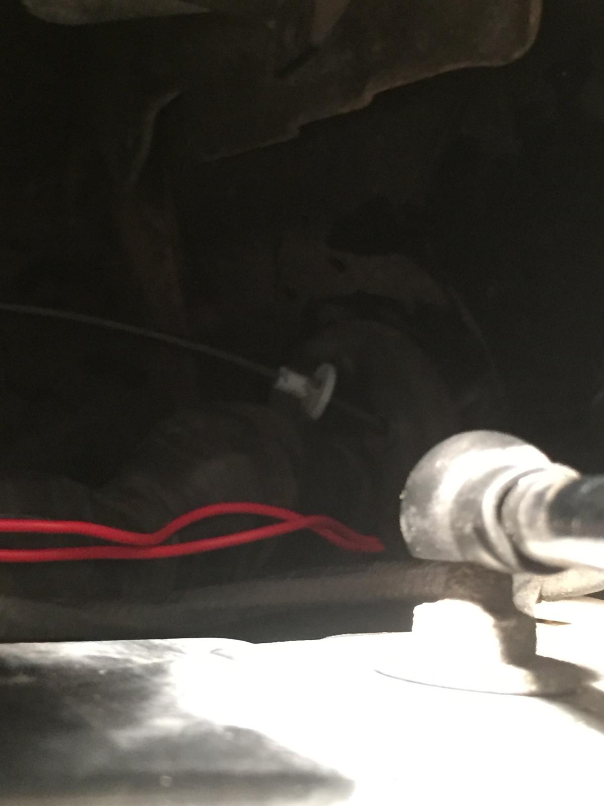

However you decide to attach the switch, make sure to protect against moisture. Wiring completed, we ran the switch leads through the fire wall following the throttle cable. Most 4th gens already have cut outs for switches. Simply follow up past the fuse panel to run the switch.

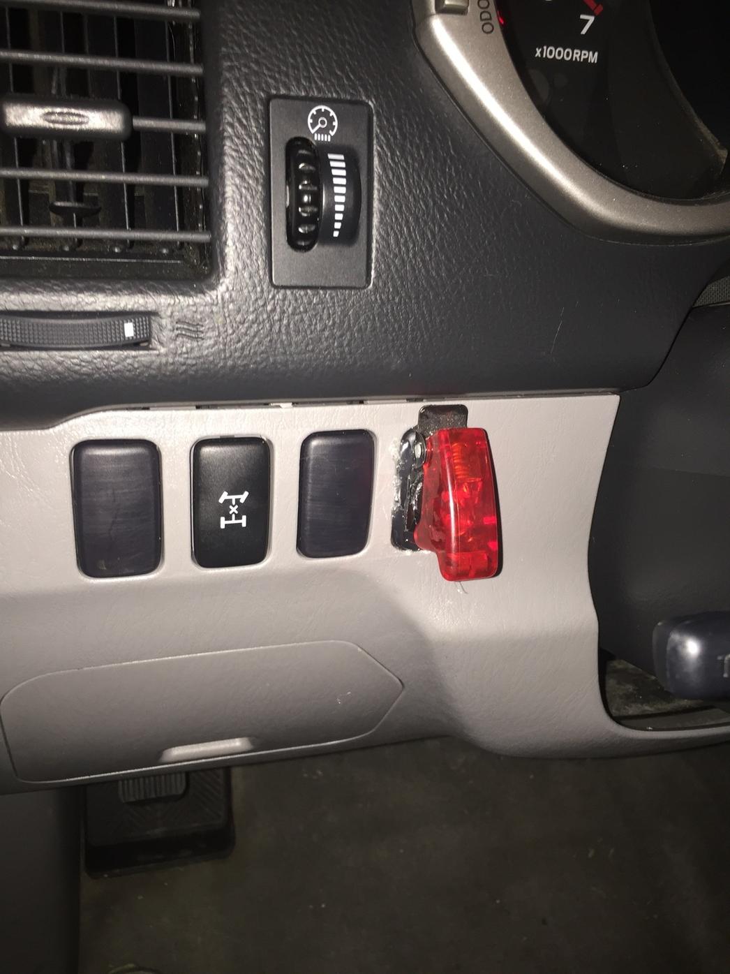

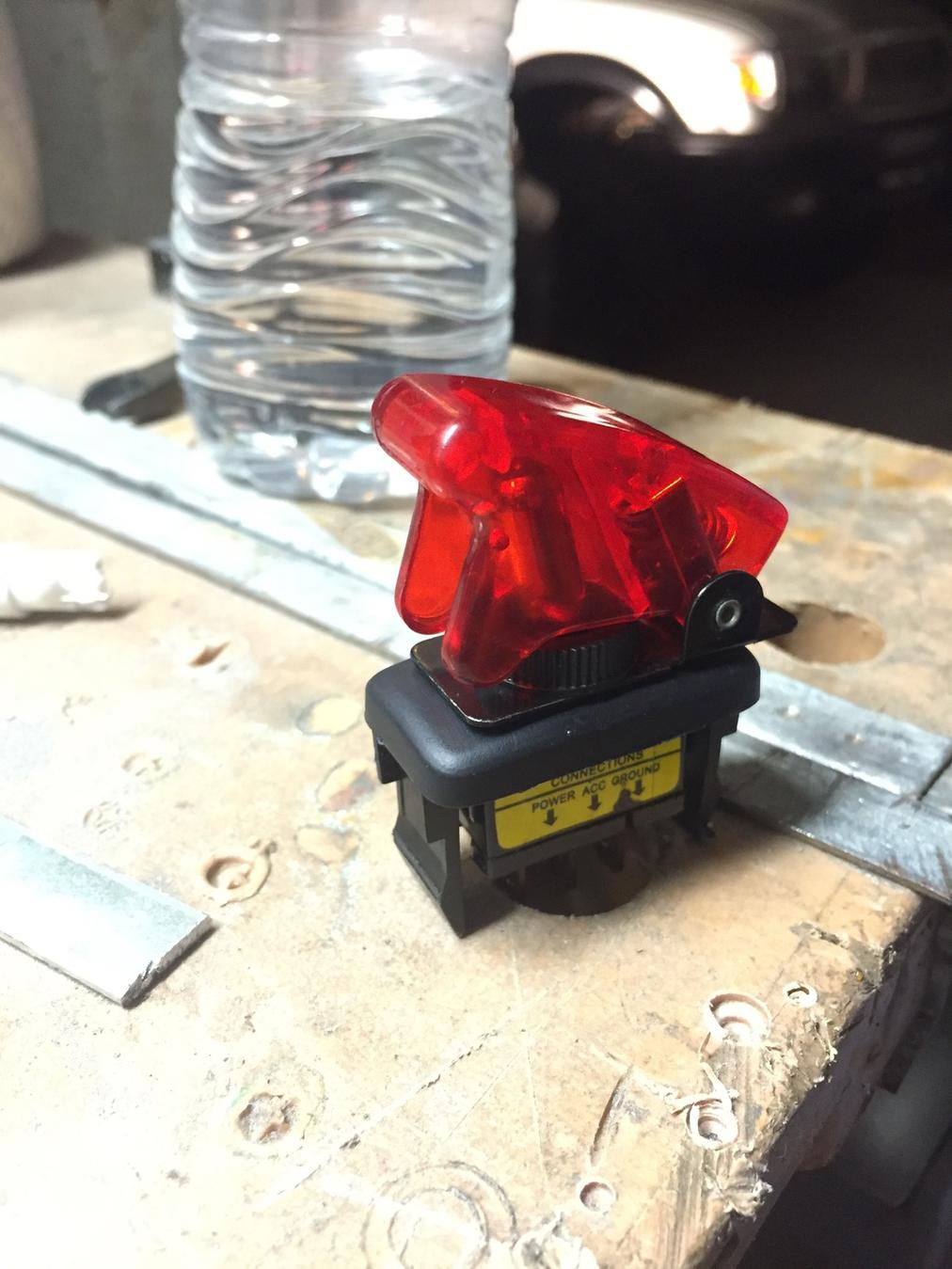

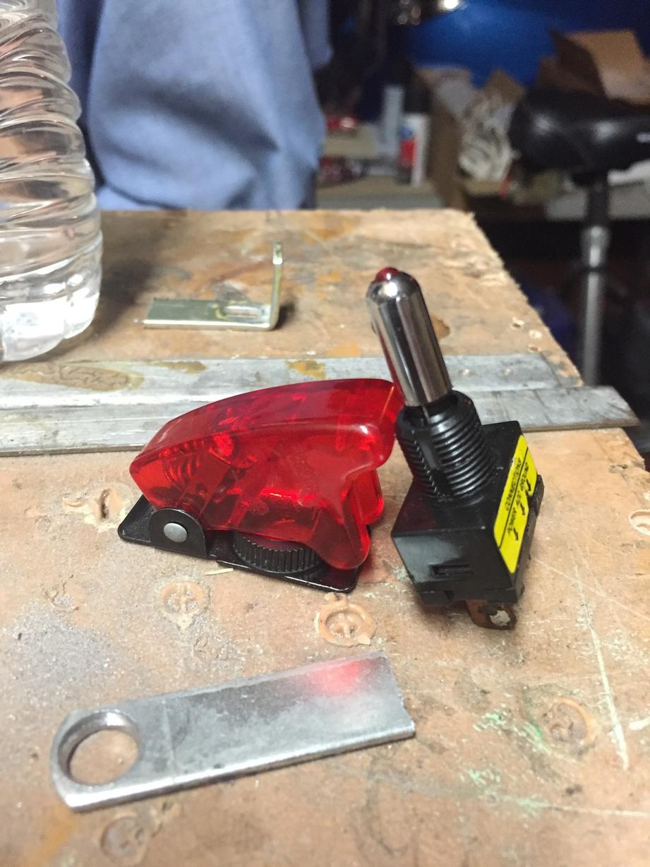

I was still able to use the switch panel insert and just drilled through to mount the switch.
THE HOT GLUE WAS ONLY TO HOLD THE SWITCH WHILE EPOXY SEALED THE SWITCH FROM THE BACK, I DID NOT HOT GLUE A SWITCH TO MY DASH

you should also warn people that you need dremel the grove in the switch so you can flip it around.That switch is normally cover down is off and up then toggle for on. The red wire needs the opposite where you cut the connection to disable vsc/abd/trac. so you need this to be always on and flip to turn off.

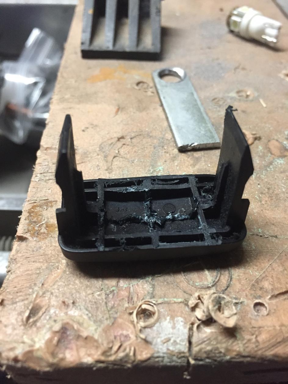

Very true, to figure which was on (for the TRAC to be turned off) and which was off (to turn back on). There were fins in the back of the OEM switch insert that we did have to grind down. in this we used a bench grinder. Thanks for the support and edits!
This is the back of the switch insert, ground down so the switch can sit flush in the rear. Careful when grinding down the fins, making sure not to hit the main two clips on either end. For extra support behind the switch, Epoxy was added.
