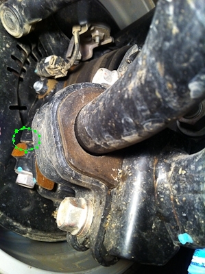

Do you have a gap where I have put a green circle on the pic?
This bolt should be pretty tight.. I believe 165 lb with a tq wrench. I don't recall a gap here when I reinstalled my lower control arm to the lower ball joint.
