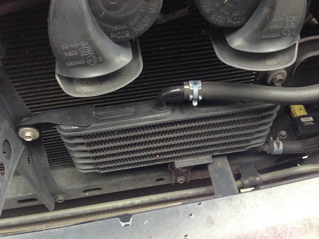

After reading the post by BKRunner it dawned on me that my Dad has a 2011 V6 4WD Tacoma. It's one of those TRD deals. Anyways, this thing has an auxilary trans. cooler between the grille and the a/c condenser. It's kind of on the smallish side but I did tow my jet boat with it a few times in 110 degree desert heat with no issues. I had a '03 Dodge Dakota w/ a tow package and the cooler was double the size. That truck had no gauge and no light. My '70 El Camino has a B&M cooler that's also kind of on the large size and sometimes I think the fluid runs too cold. That car has a gauge, and it rarely gets to 170F. Anyways, I did my best to take a pic of the cooler on the Tacoma. Kinda hard to do w/o removing the grille. Don't think my Dad would be down for that.

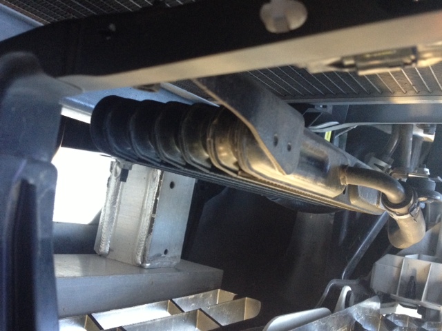

Here's the one in my 2005 Sport V8. I'd like to put one in my 2014. I wonder if you could get an OEM one with brackets and just bolt it like they did in the 4th Gen V8s?

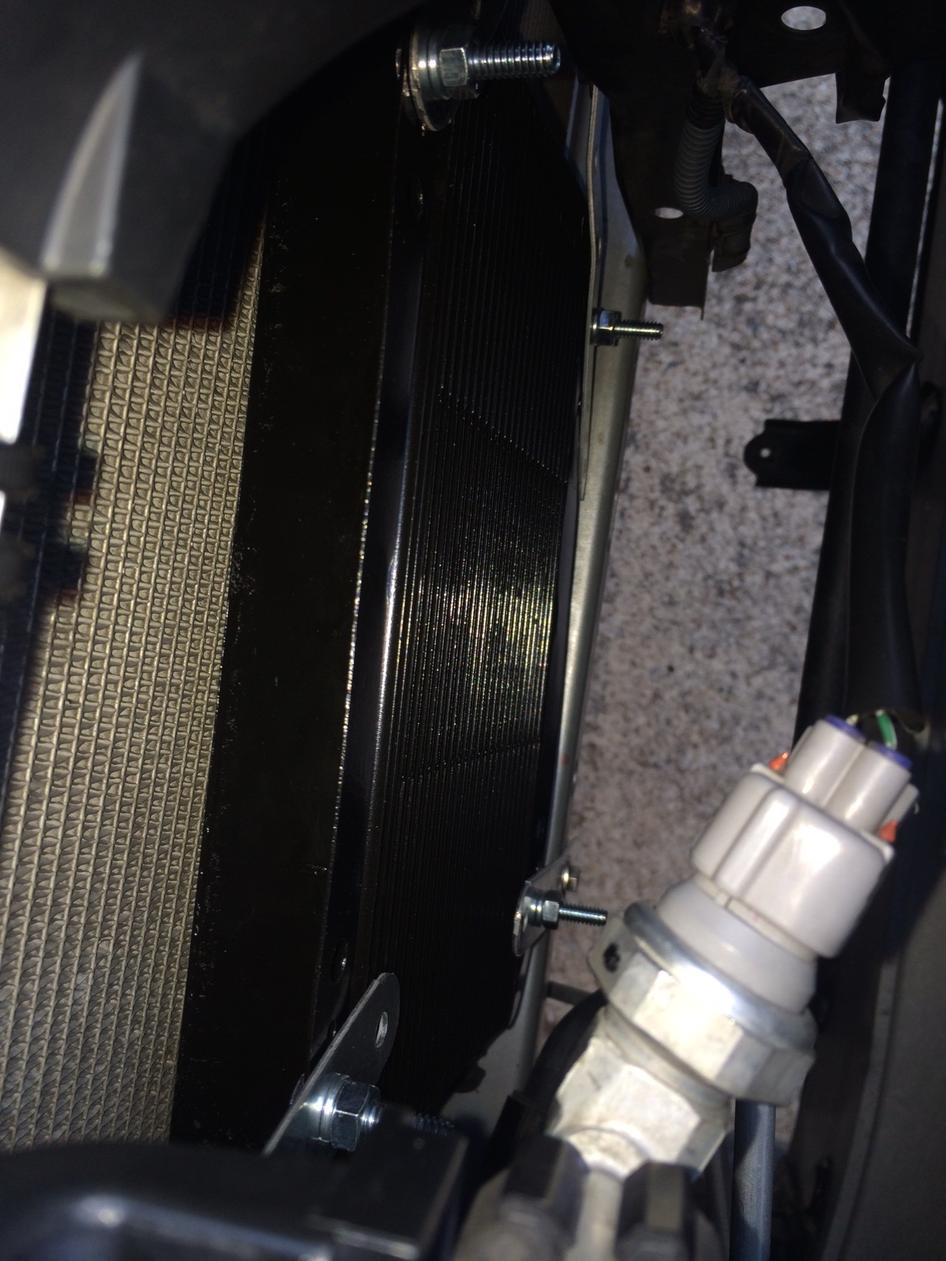

I installed the B&M 70264 in roughly the same location (Right side) using the supplied mounting brackets and some metric machine screws. I used a couple threaded holes that were already there and the center support for the hood latch. It sits a bit crooked, but level and most importantly to me, about an inch off the front end of the radiator. I hope this will promote better cooling and less chance of corrosion from everything rubbing together over time.
Hard to get a good angle that captures everything, but this is looking down on the right front end of the radiator. Note: The cooler face is pointing aft. It was easier with the mounting holes on the back to orient it in this way. Also, in the pic the hoses are not yet installed. Not pretty, not OEM, but it is solid and works for me.
