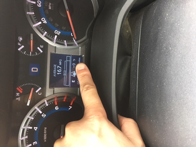

Hi everyone, I just wanted to let everyone know that the new TSB has been fantastic regarding "clunk" at cold temps. I have yet to have a clunk even at the temp in the pic below.
I hope everyone else has the same results.

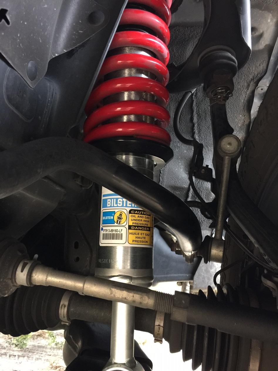

Boom, done. Thanks again boys

Got mine done yesterday [emoji1360]They were a bit of a pain. After truck got back there they called me back. Showed me that they did not realize lift was on it and would take longer. PLUS had they realized would not of approved TSB. I basically IMO got pushed to back of line as I sat for 5hrs 20min until truck done.
That said, no freaking clunk!!! [emoji122][emoji869][emoji122]
