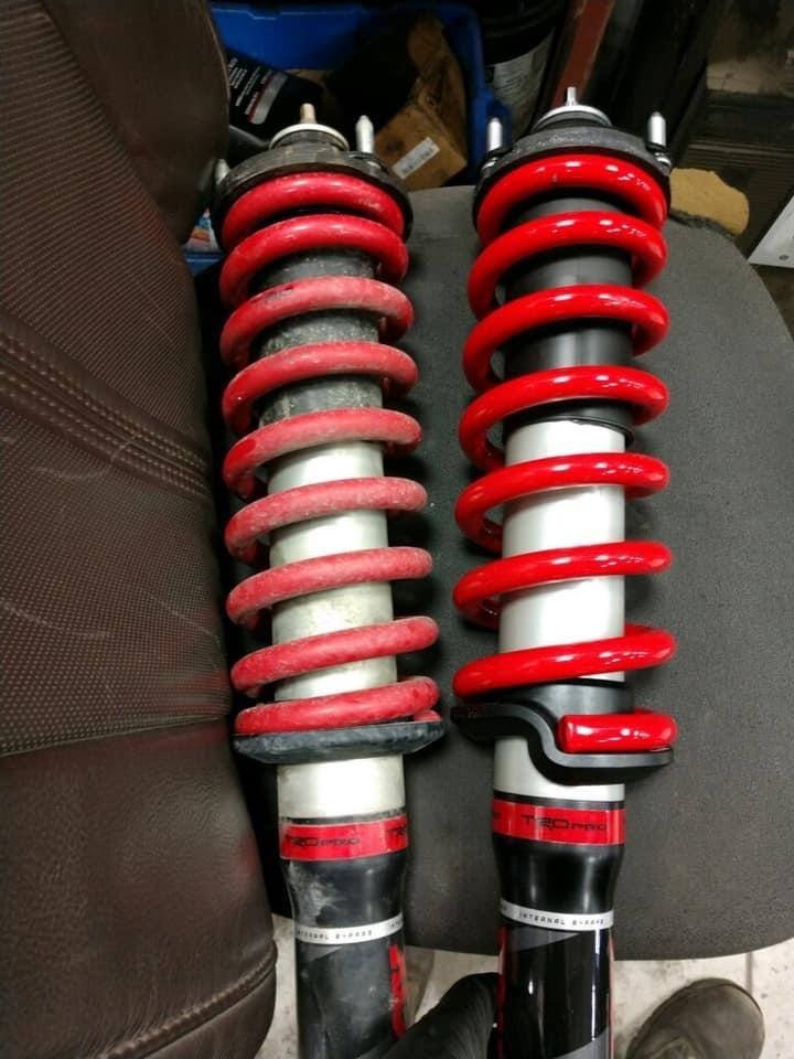

Update. My new struts were installed yesterday and they look a little beefed up compared to the old ones. Drove over some speed bumps this morning in 25 degree weather and smooth as butter. Bye bye clunk!
Did Toyota replace the struts under TSB or did you purchase new ones? I swapped my factory suspension with TRD Pro on the front. Clunk showed up recently after having it installed for several months.

It's not across the entire line. It's a specific issue with the Fox shocks in the TRD Pro. Toyota moved from Bilstein to Fox in 2019. In 2021, Fox redesigned the front shocks and Toyota issued a TSB for the 2019 and 2020 models. I had the clunk in cold weather and got my front shocks replaced with the updated 2021 Fox shocks. Looks like they just lengthened the coil spring. Whatever issue you're having is unrelated to this specific issue.

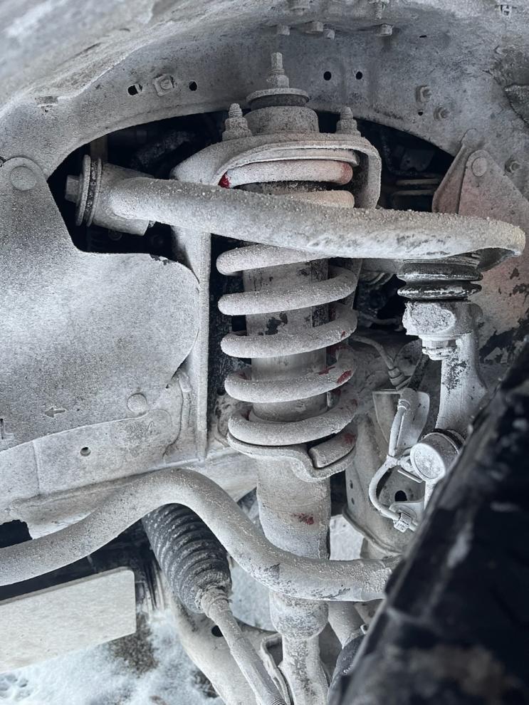

I got my shocks replaced for free with that factory notice but clunk is still there. Checking in from Chicago 20 Degrees, clunk is progressively more noticeable from 30 to 20 to 10 degrees.
Thanks for the pic, I'll have to check and see if they actually replaced them with the new design or just new of the old design. Do you by chance have the part number from the new design?
