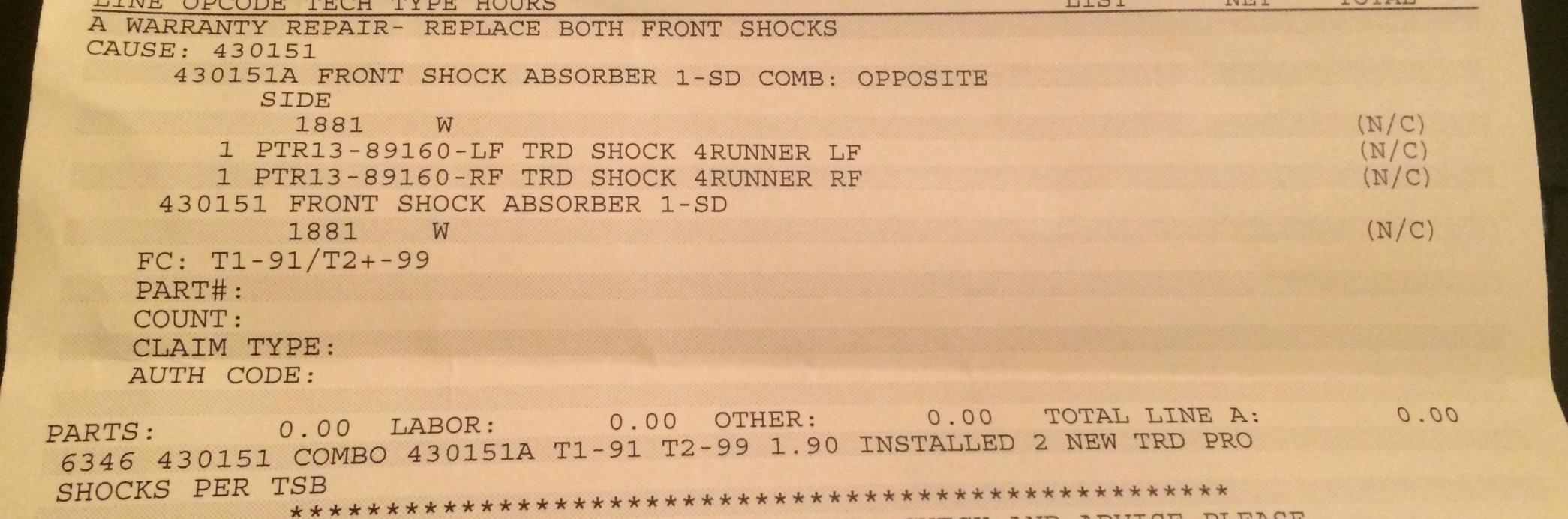

After spending a little over 2 hours at my local dealer yesterday (DCH Toyota of Milford, MA) I have new front shocks! Dealer was very good to deal with - ordered the new shocks for me a week or so ago (based on the TSB number I provided) without question. Truck rides great (not that it didn't before) ... but the true test will happen in a couple of months (when New England temps are not in the mid 90's as they are now). I will post again after the first frost.
Had you reported the clunk before hand? Or just go in and say you wanted the updated shocks according to the TSB?
When the case number with Toyota was disclosed here (last year) I asked my local Service Rep to make note of it in my service record. They never actually confirmed the clunk in my Runner (although I assured them it was obviously there). When the TSB came out they said it was good enough.
Done.
