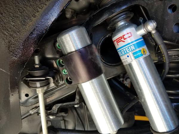

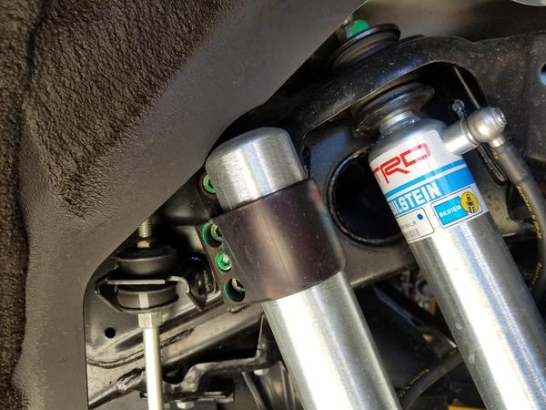

In another thread someone posted the rear remote reservoir was bumping against the wheel well. I still need to go check mine because I have the clunk too...
Well I got under the 4 Runner today and my driver side remote resi was actually touching the body. I got out my dremel and cutting wheel and took care of that.... clunk is now GONE!
BEFORE:
AFTER:
Why didn't you just slide it down in the mount?
Well, first, there is a ridge on the resi that is intended to be a "stop" so I would have had to force that raised ridge into the mount to move it down. Second, I wanted the resi to be farther from the ground and any projectiles that might hit it. So in the end, it was more work, but that is the way I wanted to do it.
