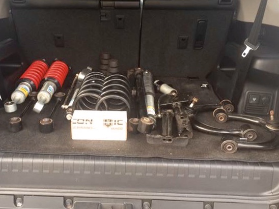

Dear all, please help me out with this.
I have a 2011 Trail with KDSS (Canadian). Recently found an amazing deal for the full TRDPro Bilstein Shocks+springs kit. Someone upgraded their T4R-TRDP with aftermarket stuff and listed the suspension kit on FB. I didn't do much research in advance and got the kit anyway. So questions are...
(1) would this kit fit my 11-TE /w KDSS? do I need any additional parts to make it fit? Any special instruction I have to follow to install (myself or the garage)? I want to keep the KDSS intact and still add this TRDPro suspension kit.
(2) Any shop/garage your recommend in the Toronto, Canada area that specialize on this type of upgrade?
(3) the ad from Toyota says that the front will/could be lifted by 2.5" and rear by 2". I am not really sure if this is possible with the TRD springs. I want at least 1.5" or 2.0" list in the front even if I keep the rear at the stock height. Would I need any spacers / lift kit? Not planning any tire upgrades (already have TRD wheels with stock size tires)
In your response please try to hit most points. Thank you very much.
the TRD Pro suspension will "fit" any 4Runner trim level. you don't "need" additional parts, per se. with KDSS, you VERY MUCH NEED to follow special instructions to install. in short: you DO NOT want to open/bleed the KDSS hydraulic lines. more on this below...
i can't help you here, except to say that i would vet the ever-living holy hell out of whomever i hired to install it to be ABSOLUTELY CERTAIN they know what they're doing working around KDSS.
please see here: http://www.toyota-4runner.org/5th-gen-t4rs/154230-how-lift-installation-kdss-equipped-vehicles.html
i don't know what "ad from Toyota" you're citing here, but you should know it's completely incorrect.
the TRD Pro kit lifts the front by just 1" and doesn't lift the rear at all—that's it.
if you want to lift the front any more than 1" using the TRD Pro parts, take a look at the Toytec kit which will allow you to do that. note that it does come with new Superflex coils for a lift in the rear too.
the factory rake on the 4Runner is 2" lower in the front, so keep this in mind when determining how you want to dial in your setup.
before you go jumping in, please take some time to search and browse the forum. there's a ton of information available, and the more you know in advance the better the position you'll be in when you ultimately decide what to do.
best of luck.
:cheers:
